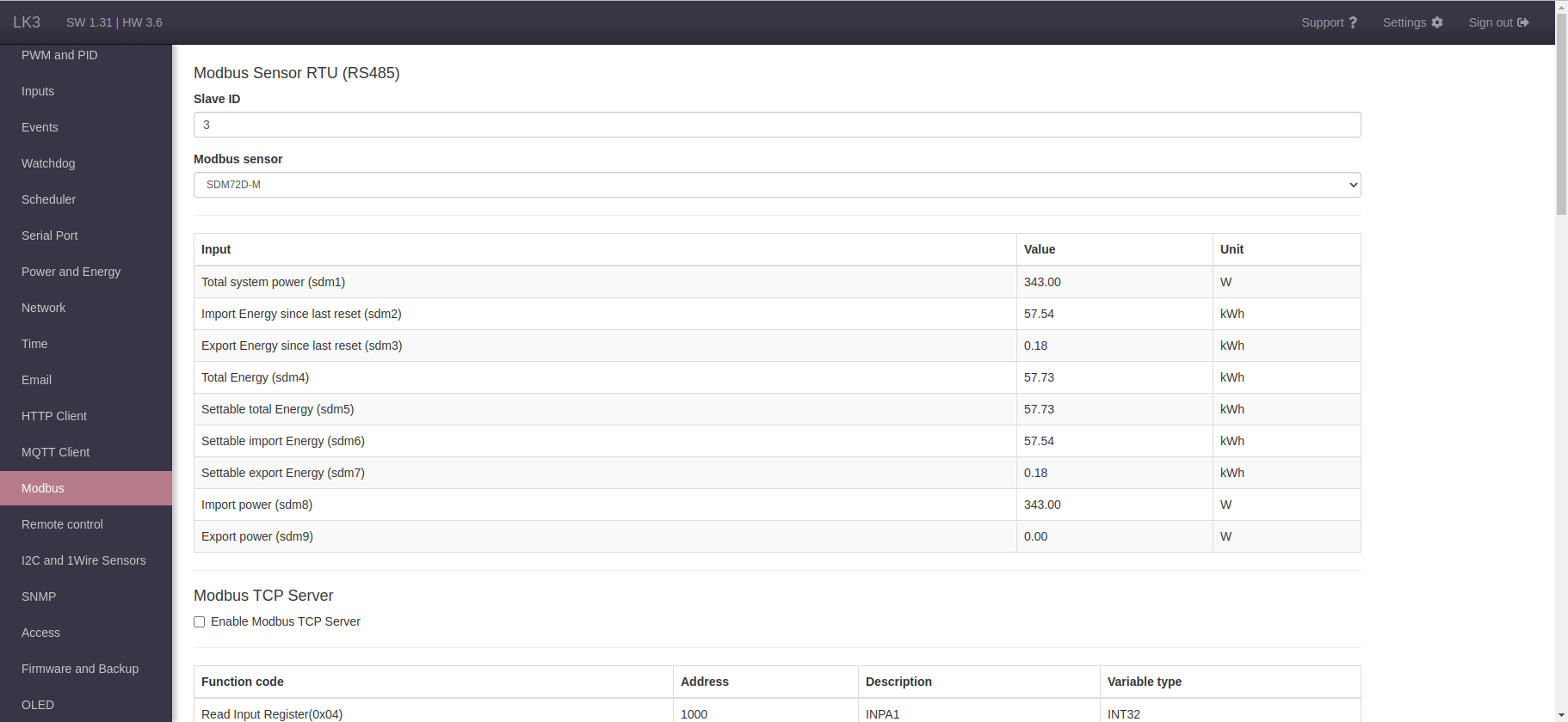

    If someone needs to extract data from the sofar via modbus, I am making such an option in the lan controller (Lk3.8) https://tinycontrol.pl/pl/lan-controller-35/ . I also have a bi-directional (3-phase) SDM72D-M meter connected, to measure what the inverter will produce, also reading via modbus via LK. LK sends data via mqtt to the server (own or mqtt.ats.pl - free) or via http with GET queries.
    If I installed this SDM72D-M right after the tauron meter, I have a full picture of what the inverter produced (from the inverter reading), what went to the tauron and what I downloaded from the tauron (SDM). Inverter and SDM connected on the same two-wire cable to LK.
    The cost of SDM72D about PLN 200, the cost of LK about PLN 250. You can add a second SDM to control the inverter, but I don't think it makes sense, I see small discrepancies at home.
    I attach a screenshot from LK (SDM72 reading) and a graph of the instantaneous power inverter (reading every 20 seconds).
