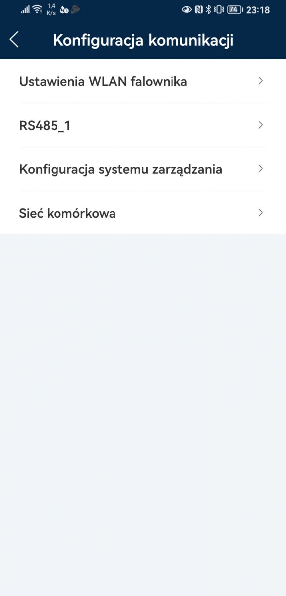

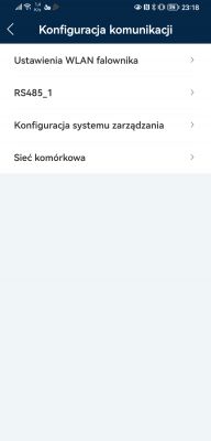

    Hi,
    if someone else was struggling with this problem:
    1.new firmware have by default, modbus on wifi is turned off, so after each update the problem will come back
    2. a person with administrator privileges must connect to the inverter wifi network (SUN ***) and activate Modbus TCP in the inverter menu, it is not possible via the website. The FusionSolar application is used for configuration
    Full path:
    JA > Przekaz do instalacji > Konfiguracja komunikacji > Ustawienia parametrow klucza sprzetowego > Modbus TCP
    3.The default password for the installer account is 00000a (5 zeros + a), but for me it was changed by the company and lost
    4. For some time now, the min. Passwords up to 8 characters long
    Greetings, migod

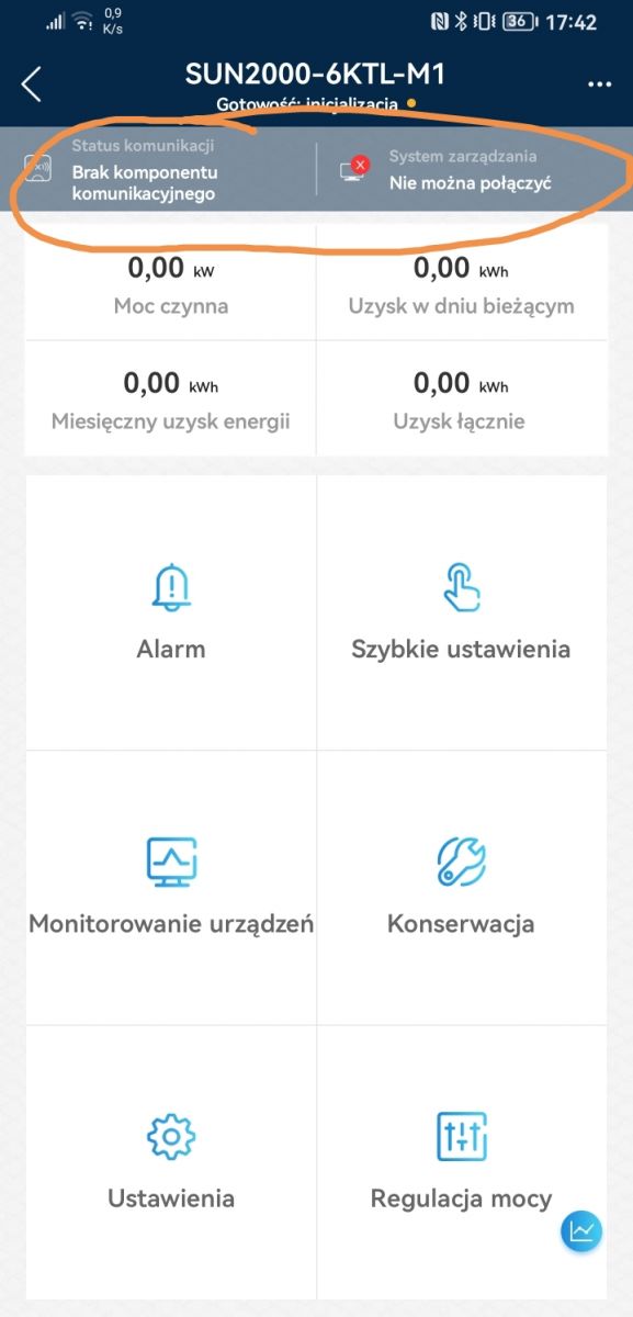

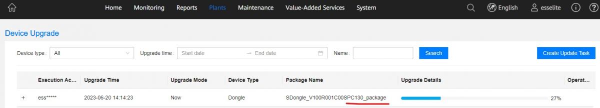

    quote="yunnanpl"]Hello,
    I will try to add my 3 cents quickly, as I read and read data from the inverter in different ways.
    So connecting to the inverter WIFI with a separate wifi connection, and connecting pymodbus to address 192.168.200.1 on port 6607 works!!!
    Problem #52: Now, as before, I tried to keep the wifi connection and the modbus connection all the time... unfortunately, by keeping the modbus connection, it blocks the inverter from sending data to fusionsolar (so they are out of date and there are warnings).
    Similarly, when pymodbus is connected, the application on the phone will not connect either.
    Solution: Wifi is constantly connected, but the modbus connection is established only when needed, every 30 seconds and then immediately disconnected (downloading data is not all 5 seconds). In this way, in the fusion solar portal, everything also appears beautifully, and I have fresh data every 30-40 seconds.
    Interesting thread, and the problem appears in many places. I also have a problem with the connection via Modbus.
    My system is:
    SUN2000-8KTL-M1 (firmware V100R001C00SPC148) SDongle (firmware V100R001C00SPC130)
    SUN2000-3KTL-M1 inverter (firmware V100R001C00SPC148) - connected to the above in cascade
    SmartMeter
    Battery Luna 2000 (firmware V100R002C00SPC116)
    I asked a question on the Huawei service how to connect to wi-fi and received the following answer:
    "You cannot use modbus via wifi and still be able to have the inverter connected to fusionsolar so using an ethernet cable is recommended.
    You have to disable DHCP and put a static ip for the inverter and due to this you will not be able to connect the inverter to fusionsolar anymore."
    I asked for specifics and came a short proposal and 2 attachments
    "You must take the dongle out, connect ethernet cable to dongle from the router and plug the dongle back in then follow the attached procedures"
    I will be checking it soon (in the attachments it is described how to check if the right port is open using the ModbusPoll 64 app, but only when a new modem comes in for direct connection as a mesh system (because the system is outside the house) but I would still prefer to be able to connect via wifi (which seems to be blocking the FusionSolar App.) For now, I asked how to try to connect via wi-fi anyway and I'm waiting patiently...
    I will be very grateful for comments and ideas in this thread!

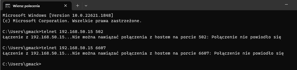

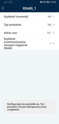

  • #43 20322750
    tradilus
    Posts: 9
    Board Language: polish
    Well well! Another jigsaw puzzle - thanks! I'll try to check in the evening and if necessary, I'll describe what happened.
  • #44 20324076
    tradilus
    Posts: 9
    Unfortunately, it failed despite the fact that I am connected to the router with a cable, I can see the IP of the inverter, the ping responds without a problem. The ModbusPoll program, after entering the data according to the support proposal, gives the message "Write error" and "Read error". Huawei-Solar on HomeAssistant cannot be started.
    I already know what the slave of the controller is - it is the same number as the COM number in the RS 485_1 communication settings (in the menu where there is a Modbus and Baud rate selection) - it is described in the files from the support, which I sent above.
    So I wrote again to Huawei asking what's next...

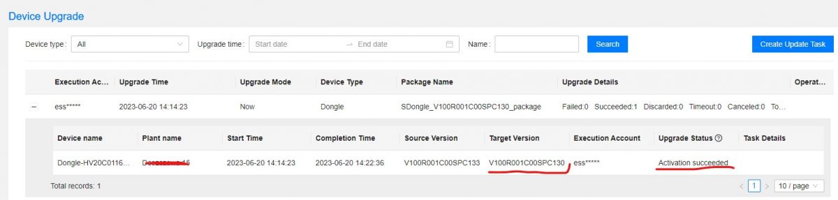

    The easiest way is to change the dongle's firmware to the one with the ending 123 and there are no restrictions regarding the connection via modbus.
  • #46 20324148
    tradilus
    Posts: 9
    All in all, I can give it a try. Does anyone have a link to this firmware version of the dongle?
  • #47 20324200
    lizak1983
    Posts: 133
    Help: 5
    Rate: 36
    Here you are. After turning on the inverter, there is an additional network from the smart dongle for a few minutes, we connect to it, not to the network from the inverter and update there.
    • SDongle_V100R001C00SPC123_package.zip (2.81 MB) You must be logged in to download this attachment.

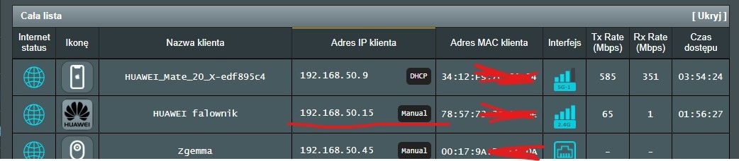

    yunnanpl wrote:
    @tradilus As for blocking Fusion Solar, with a direct connection to the inverter's wifi and collecting data from modbus (ip 192.168.200.1 port 6607), Huawei is only partially right (I'm not talking here about connecting via a smart dongle via wifi or cable, or about the connection that the inverter establishes with my grid).
    Yes, but to understand why certain things happen, you need a little background information. Please write what your system looks like, because the problem may not lie in the inverter, but in the way of communication via LAN. How do you connect to the inverter's wifi and use HomeAssistant at the same time? How does it look in practice?
    In my case it is like this:
    LAN - 2 Asus routers forming a Mesh, one of them the main one in the house (ASUS1) and one in the guest house (ASUS2). With ASUS1, RaspPi with HomeAssistant is attached, and with the second ASUS2, this inverter is attached with a cable via a dongle. I'm sitting at the computer in the room and I see the IP of the dongle, the IP of the inverter (edit: I probably see the IP of the same device, i.e. the dongle, but one IP is for connecting wifi and the other via ethernet).
    COMPUTER
    + wifi
    + wifi
    ASUS1---ethernet---RaspPi (HomeAssistant)
    + wifi
    + wifi
    ASUS2 ---ethernet--- DONGLE+INVERTER
    lizak1983 wrote:
    You're welcome. After turning on the inverter, there is an additional network from the smart dongle for a few minutes, we connect to it, not to the network from the inverter and update there.
    Some news
    The Huawei service gave me some instructions, but they are chaotic and do not help. But lately it even seems like:
    - HuaweiSolar on HA sometimes works (it used to not work at all)

    Something must have screwed up with the dongle or the inverter, because about a week ago the inverter stopped seeing the dongle, but surprisingly the dongle is visible through the router and the inverter sends data to the FusionSolar server.
    The problem is that Home Assistant integration can't call the dongle via MODBUS.
    I don't know what to do with it. It is impossible to upload the software to the dongle because the inverter cannot see it and cannot manage it. No dongle setting parameters are visible to SUN2000 apps.
    Is there any way to hard reset this dongle, some factory reset?

    I read here that people report similar problems that they can't enable MODBUS in the dongle, but I don't have any dongle settings at all, even if I wanted to connect it to a new router network, I don't have these options.
    https://forum.huawei.com/enterprise/en/sun200.../thread/667239114606526464-667213868771979264
    UPDATE1:
    It's very strange, through the website I was able to reset and update the dongle to the previous v130 firmware. and everything reported as done, but the inverter still does not see this dongle in the USB port. However, the dongle itself works and connects, but you can't call it via MODBUS.
    I already took it out, restarted the inverter, put it back in. Nothing changes.

    Why is the service telling me that I shouldn't use the SUN2000 app to connect to the Fusion Solar inverter only?
    Nowhere in Fusion Solar is there an option to set the Dongle connection to WIFI and there are no RS485 communication settings. Am I missing something?
    But I'm a dummy.
    I was using the SUN2000 app, but it was installed directly on a smartphone, and you had to select the "device commissioning" options from Fusion Solar.
    I reset the inverter password, connected via Fusion Solar and communication via MODBUS started.
