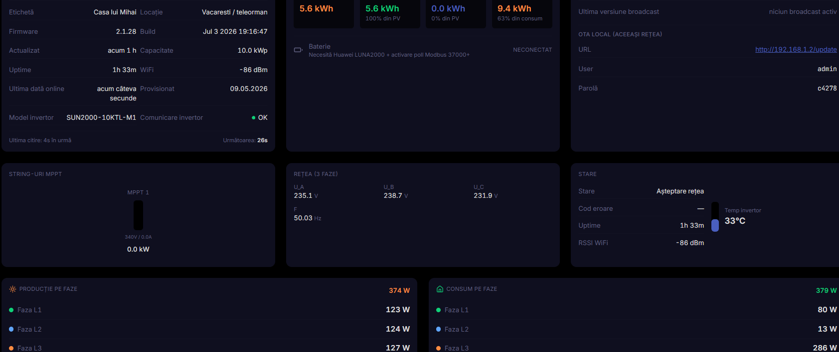

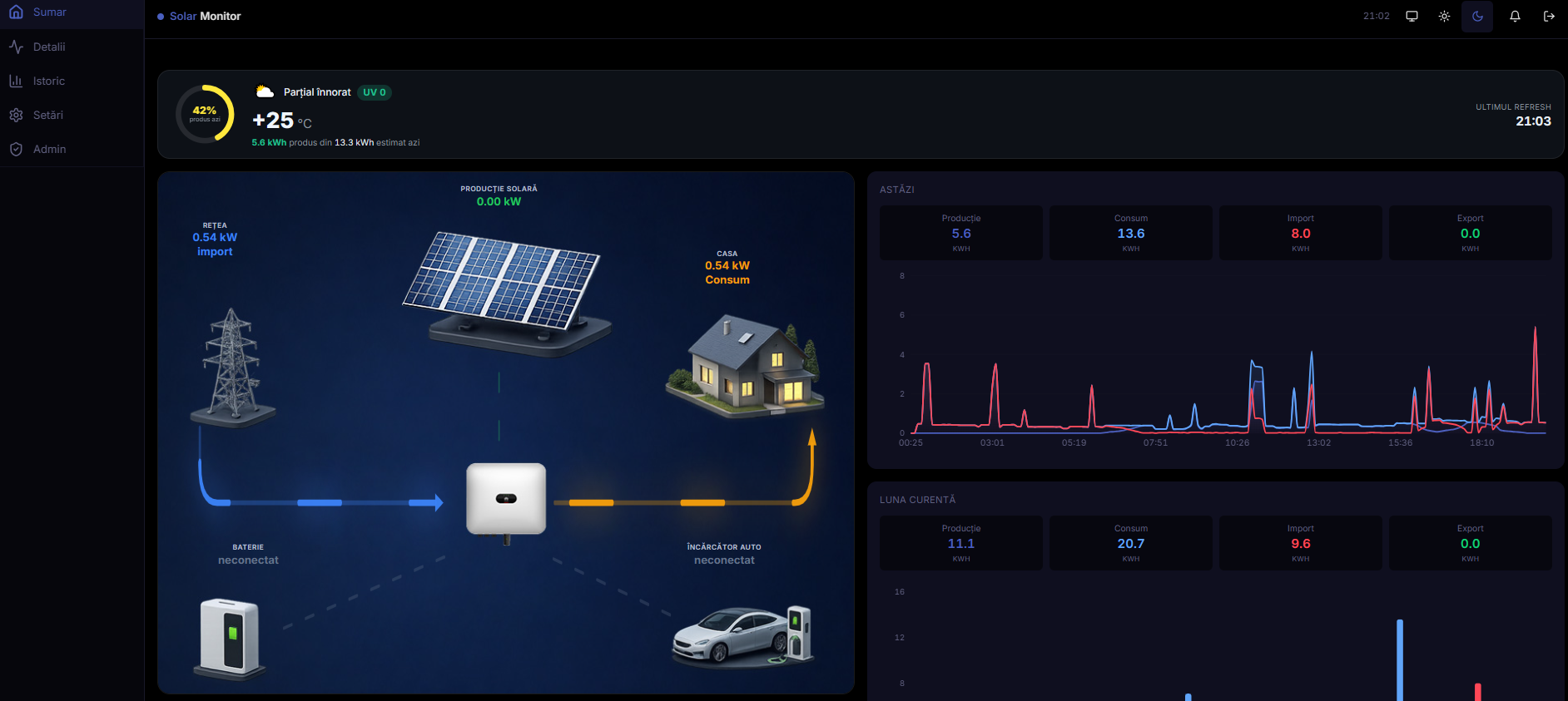

    Hi @astoicovski, following up on my earlier post — I have ~100 of these China-locked SUN2000 units (imported in 2022, same answer from Huawei EU: no warranty, no service, no FusionSolar enrollment).
    Since the cloud path is dead, I developed my own monitoring system that reads everything directly from the inverter over RS485/Modbus RTU — active power, string voltages and currents, daily/total yield, temperatures, alarms. The region lock only blocks cloud enrollment; the local Modbus interface works normally on Chinese firmware, so this works on 40KTL-M3 / 50KTL-ZHM3 as well.
    Hardware is a small ESP32-based gateway per inverter, data goes to a web dashboard with history, charts and alerts — including separate access for end customers, so they get their "FusionSolar-like" app back.
    I'm running it in production on my own fleet and I'm now offering it to other installers stuck with unauthorized-channel units. If you're interested, send me a PM and I'll share details and a live demo.
