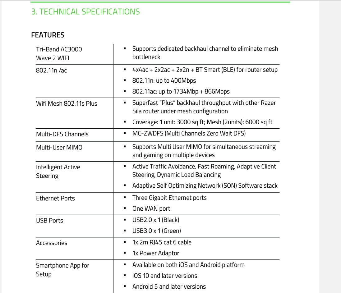

    I have a Razer Sila router and I would like to use it after plugging in the fiber in a month and a half.
    I do not know what equipment exactly T-Mobile gives, calling the Standard Router for PLN 0 and whether it has Bridge Mode.
    Maybe it's better to buy a cable router yourself without Wi-Fi with GPON and bridge mode? Only what and is it worth spending a lot on it or are such up to PLN 100-150 enough? Do I need to configure something special or do I connect optical fiber and ethernet to my router, set Bridge mode and that's it? :)
    It's hard to google anything meaningful about it.

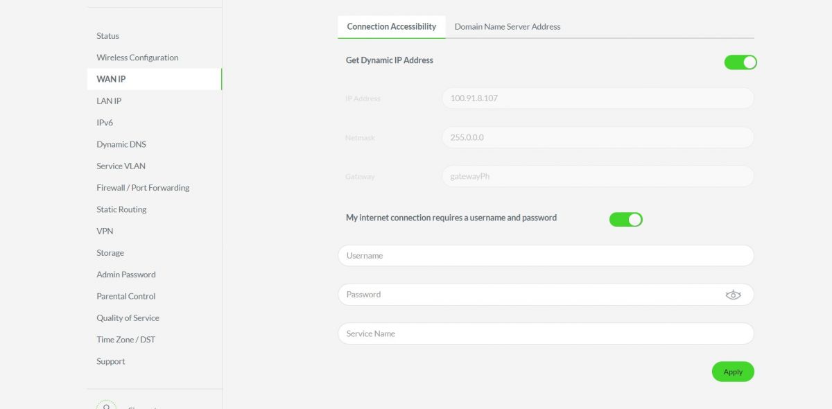

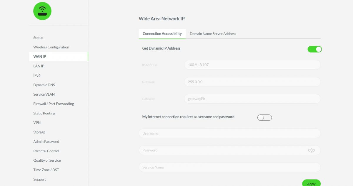

    This is the WAN configuration in Razer Sila:

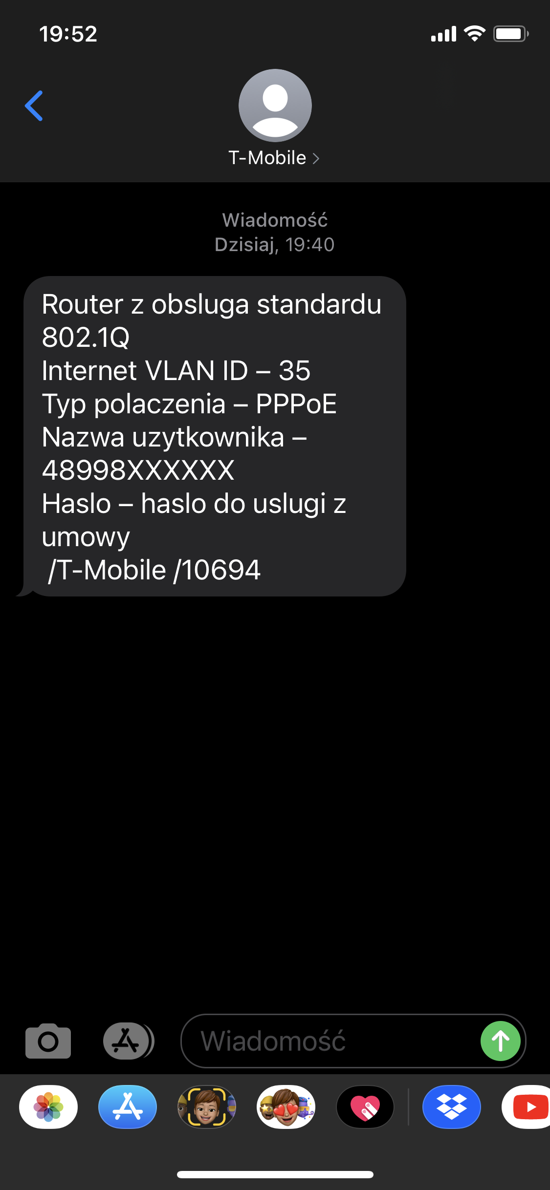

    In the end, I managed to overcome this stuff :P and called this T-Mobile Premium Tech Desk.
    The answer was that I can connect another router because the service mainly works in PPPoE. When I log into the service, I can call it, but it is recommended to use their router because then it can remotely view its configuration in case of any problems with the optical fiber.
    In addition, they sent an SMS which requirements in terms of standards must be supported by the router. I can't find this information about my Razer Sila. I would like to add that, as in the screenshots from my router, I do not have the option to choose PPPoe, but just login and password.
    They said that so far they do not have their routers, i.e. Standard and Premium Bridge Mode support

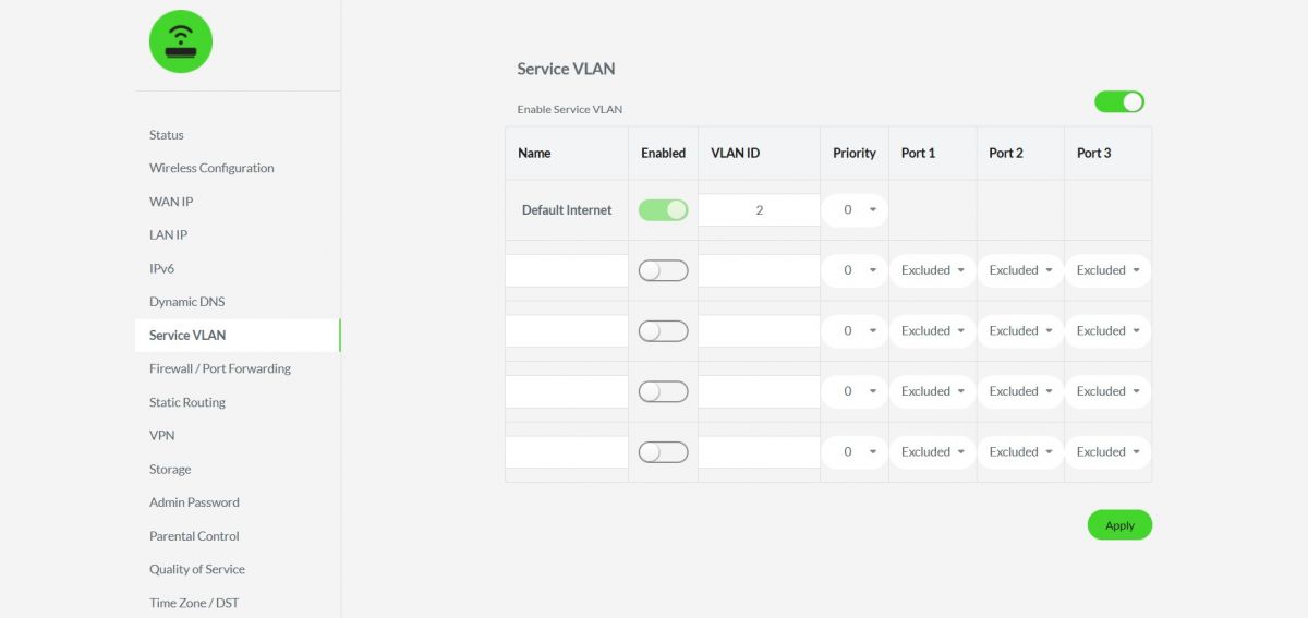

    Someone will tell me if this 802.1Q standard my Razer Sila should support this general standard in routers without modems?

    Maybe here is what you have to try. It is a bit strange that the specification does not have this, and the manual does not talk about it.

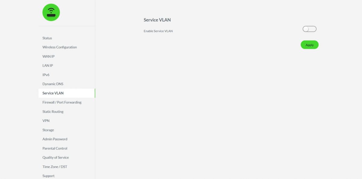

    I corrected the link in my last post. See in this VLAN service what I gave a screenshot, this is the VLAN ID what they sent me via SMS and that's what it's about. I have to set it to 35 and it should go since 802.1Q is VLAN.
  • #24 19012002
  • #25 19012007
    Garoz666
    Posts: 44
    Rate: 22
    I expanded the VLAN settings and set the VLAN ID, and this is Piority next to the VLAN ID ??
    Configuring Razer Sila Router with T-Mobile Optical Fiber: GPON, Bridge Mode, and Equipment
    Erbit wrote:
    Garoz666 wrote:
    ... and that's probably it. I have to set it to 35 and it should go since 802.1Q is VLAN.
    Exactly. Set VLAN 35 here and login and password "there".
    Cable with an outlet that will do in the router's WAN? :)

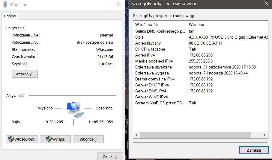

    One more thing I have an Asus VivoBook laptop and it does not have a port and a network card with an RJ-45 port. I bought a Baseus adapter (as it is professionally called) from USB-C to RJ-45 gigabit, or USB 3.0 will not limit anything here because in Win 10 in devices it says that it is connected via USB-C to USB 3.0?
    Added after 3 [minutes]:
    Connection status with Razer Sila via this RJ-45 adapter:
