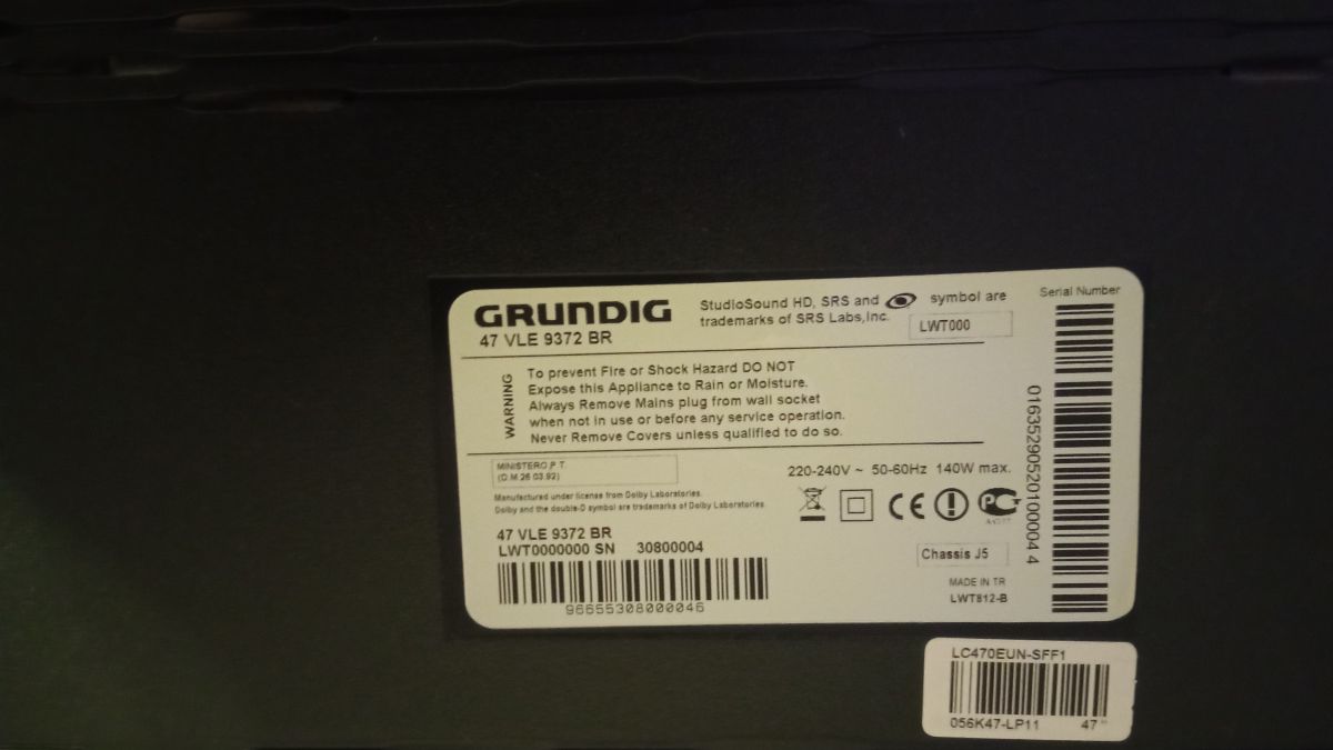

    photo of the tv label on the back
  • #3 21375041
    topsla
    Label of Grundig TV with model information and warnings.
