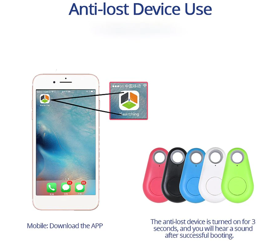

  • Suggesting an iTag tracker as a compact key fob
    #13 19633053
    austin007
    Posts: 768
    Help: 6
    Rate: 278
    Keys usually hang by the door and you can confidently limit the detection area to a radius of 1m from the receiver. ESP32 has BT in the structure so you could indeed write under it. However, I have not yet worked out BT support in ESP32. Security considerations are less important, but I would still prefer to only recognise registered devices (e.g. MAC_adr) :) I have something like the ITag Tracker key locator. He has a button to share, it is aesthetically pleasing and not large. The question is whether it would be suitable.

    Registered MAC addresses are easy to spoof
    #14 19633088
    TvWidget
    Posts: 4425
    Help: 472
    Rate: 699
    austin007 wrote:
    Security considerations are less important, but I would still prefer to recognise only registered devices (e.g. MAC_adr)
    Most tags have a fixed unique MAC address. The standard also allows dynamic addresses. These are used, for example, in the Android system. It is all about user privacy considerations.
    It is relatively easy to impersonate a device transmitting a fixed frame. It is similar to RFID with a fixed ID. As I have already written in more demanding systems, connection mode and authentication using encryption, passwords etc. are used.
    A classic beacon is constantly broadcasting. These 'anti-lost' devices probably work like that too. However, there is no certainty. Sometimes a different functionality is used. A connection is established with the tag and maintained. When the connection is broken, an alarm is sounded. The connection does require broadcasting. However, this can only be done by pressing a button.

Will anti‑lost iTag trackers work for this use?
Sometimes. Some anti‑lost tags only connect after you press a button, or maintain a connection and alarm on disconnect. Simple beacons are easier because they just advertise. Check your tag’s behavior before building. [Elektroda, TvWidget, post #19633088]
