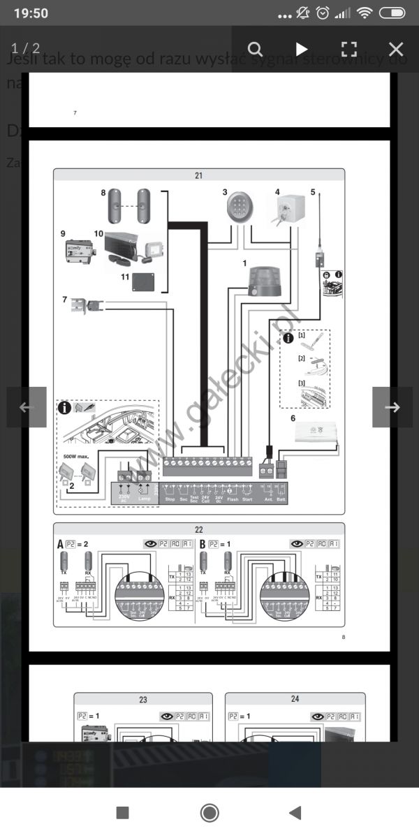

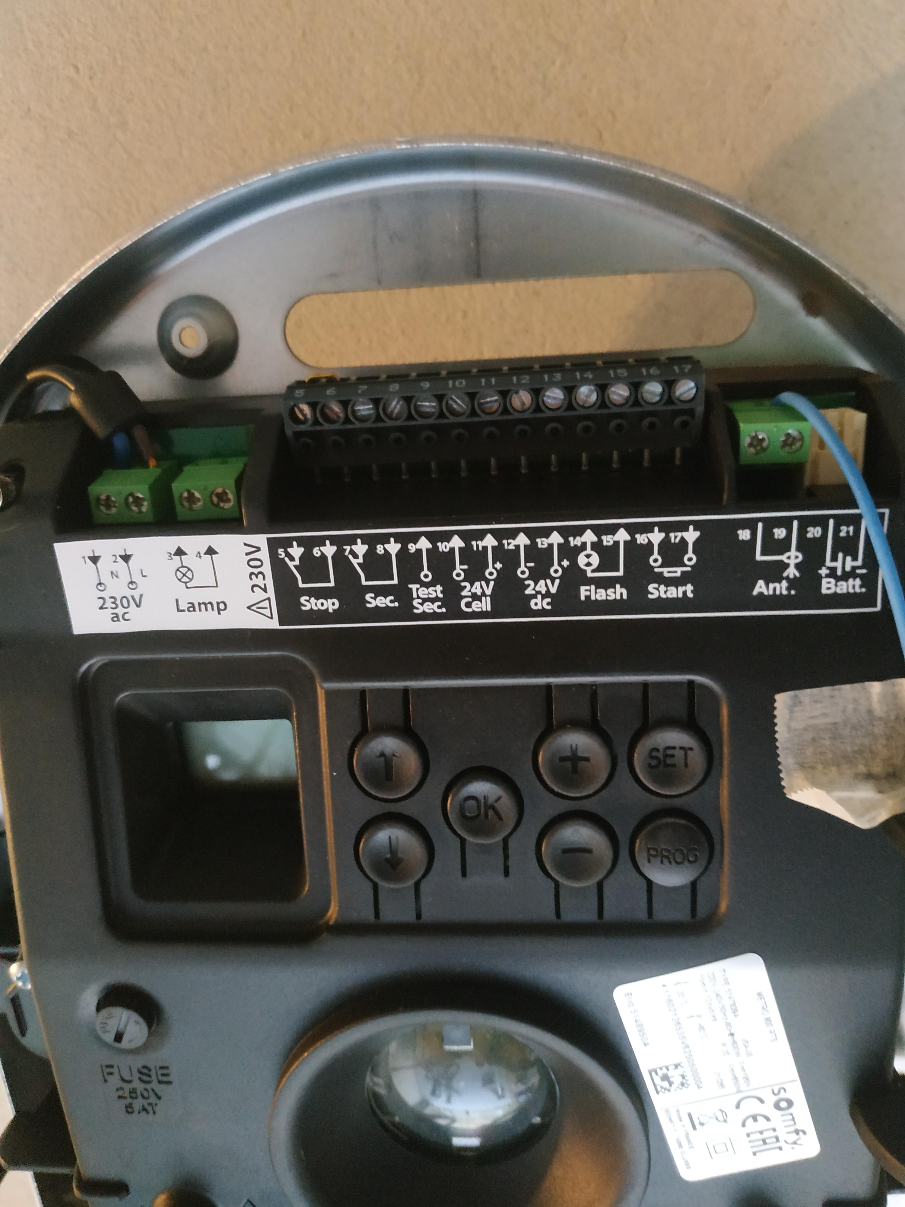

    Hi. Wiśniowski Metro 800/1000 RTS gate.
    I looked everywhere for options to connect the garage door control to a switch on the wall. I have remote control but I would like the control to be also from the wall. I have the cable wired. How do I hook it up to the doorbell switch? There is nothing in the manual about bell switches. Is anyone able to help?
    Attached is an illustration of the instructions and a picture of the control motor....

    2 wires?
    Because 5-6 is stop, 16,17 start ...
    Simple
    I'll call an electrician will call 100 zł lightly😰

    Short-circuit it for a test - you have a wall switch drawn there, by the way.

    To try to make a short circuit or burn out the motor😁.
    So bell 2 wires----- motor 16, 17 according to you?

    Exactly so - from the button to 16 and 17 described as START. You just need to have a bell button and not a regular switch like for lighting.

    As I wrote - call yourself 16 and 17 for a test - the gate should start to open.

    I connected the bell switch to 16,17-start. It works😁.
    Topic closed. Thank you.
