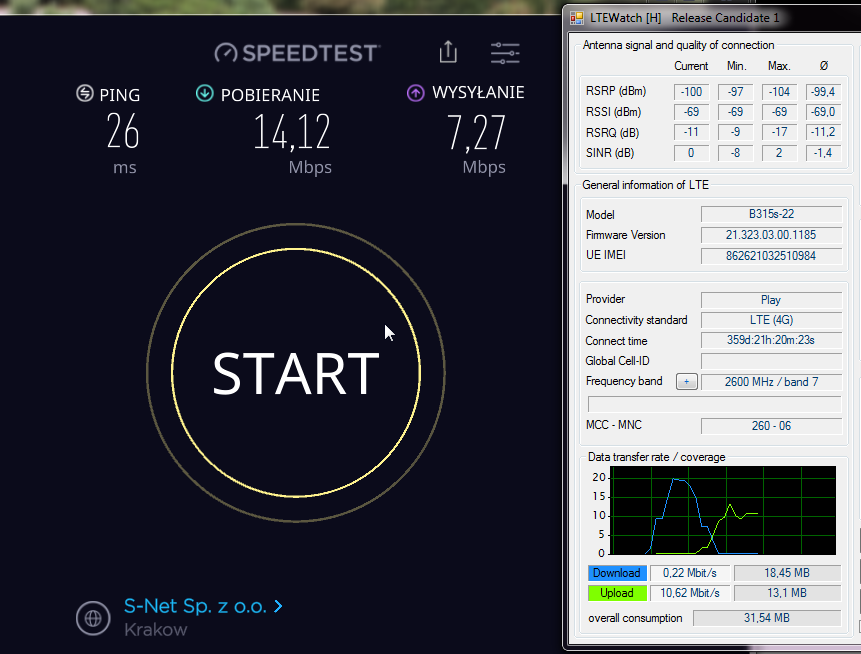

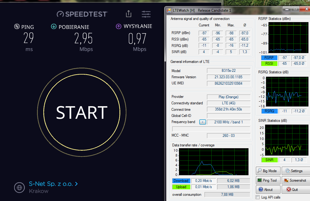

    The router currently in use is scary to write so as not to expose the siena to hate but B315s-22 :D
    I looked around the forum a bit and I see that there is a lot of hate for Plus, I have Premium Mobile that uses its infra. I chose it because it has a no strings attached contract. DL/UL ok but mainly at night and early morning, during the day and in the evening poorly (3.5.7 Mbps), and I need better, because remote work awaits me. The choice of the 2100 or LTE-A band in this German program does not change much.
    I don't use the antenna and I don't want to mount it because I'm moving soon. In a short distance (several hundred meters - 1 -1.5 km) a few cool T-Mobile BTSs and a little worse Play but I think it's still good.
    Does it make sense to buy a better router for PLN 300-400 NON-HISTORIC with aggregation, as one friend described here, or rather try to play on a 100 gb card and over-januszc? If so, please suggest models.

    @siewcu I tested it in different places of this Playa's house and it's better. It whetted my appetite, because there were glimpses of a worthy internet :D

    What LTE router with band aggregation max PLN 400 (may be a stimulant) What LTE router with band aggregation max PLN 400 (may be a stimulant)
    Playa speeds as it is in the B315 on the window with a few today.
    So far I have found three candidates at similar prices, stimulants well below the budget and good:
    B525
    B535
    B612
    Which will be the best? Rather, these models do not have a simlock, right?

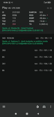

    At Oleska 86 you have a station with four bands, of which at least three are for aggregation. None of the three listed routers are suitable and will not use the station's capabilities. Unless 20Mbps is enough for you, take the B535. If you want more, you already need e.g. B628.

    What LTE router with band aggregation max PLN 400 (may be a stimulant) What LTE router with band aggregation max PLN 400 (may be a stimulant) What LTE router with band aggregation max PLN 400 (may be a stimulant) What LTE router with band aggregation max PLN 400 (may be a stimulant)

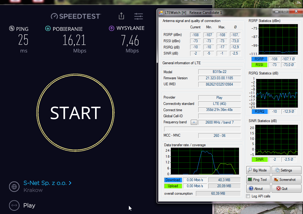

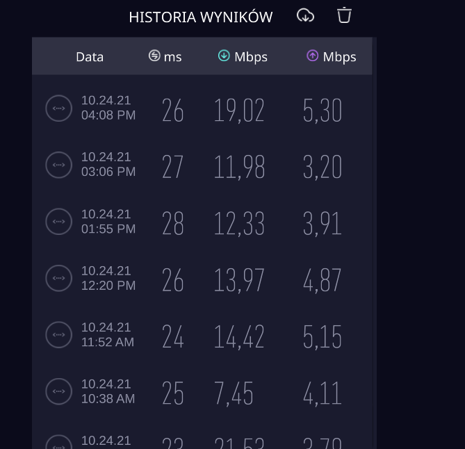

    Hello, I'm uploading further tests from the window on Monday evening when there is a load. Beyond 2600 it's a drama.
    @IC_Current I don't use it, because allegedly there is a problem with the cooperative's consent to connect, I only rent but it also puzzles me, not to say more clearly.
    20Mbps all day long would be enough for me. Something wrong with this B612? This B535 will be more expensive somewhere between PLN 50-100.

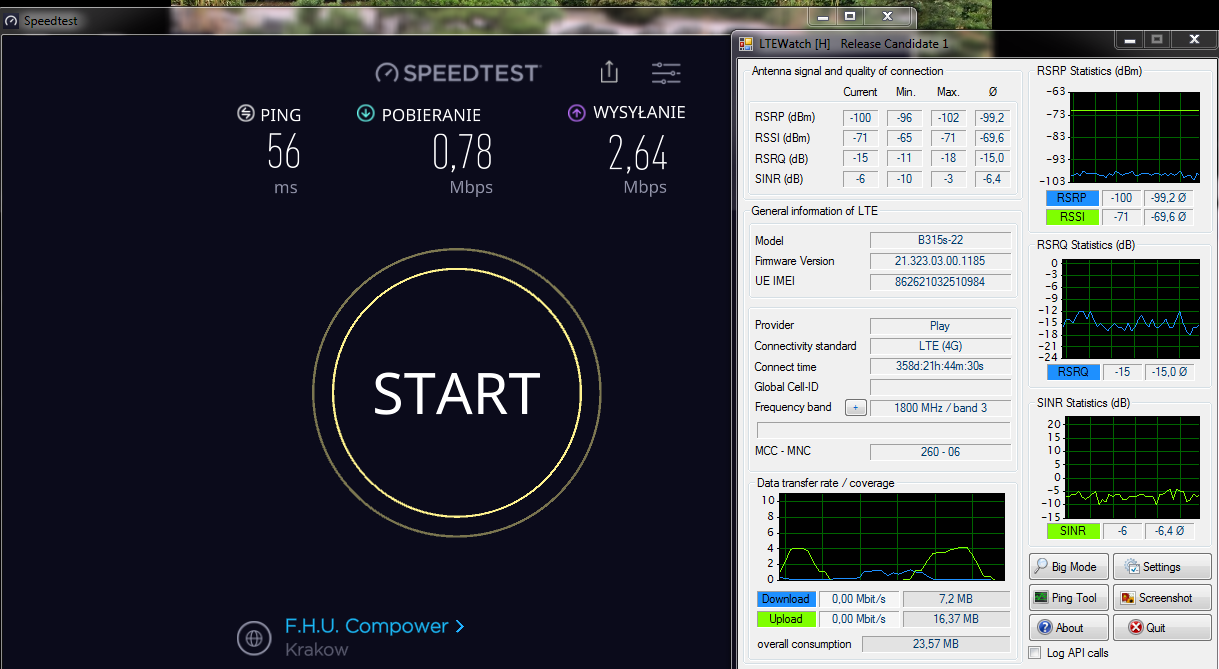

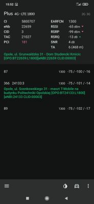

    Unfortunately, you have B315 with software that does not show CID, they were from Orange and T-mobile distribution. With your location, the fact of showing this data is important because you have Play base stations nearby at Sądowa 5, on the EOC chimney, these two have LTE2600 2100 1800 800 aggregation and the one working in LTE2100 1800 800 aggregation at the Odra stadium - mast lighting and one more LTE2600 2100 1800 800 on Solaris
    In tests on the phone, the one at the Festival popped up. In general, the application showed a connection on LTE2100 with it on the phone, but the signal parameters are similar to those from Sądowa so it is possible that the phone or router will jump on BTS because in addition there are other PCIs in the neighbors on NetMonster with carrier 523 responsible for LTE2100 with a bit a worse signal and these are the other stations in the vicinity that I mentioned above.
    In the LTEwatchH application on LTE800 you have the correct signal, the station is unknown because there is no CID, the LTE800 band is clogged with it, not worth attention, but the 5MHz operating on it is standard for you.
    LTE1800, the station is not identifiable due to the lack of CID, signal parameters are sufficient, the band is full. LTE2100 gives a little hope, the signal is sufficient, no CID and somehow it works, and finally the icing on the cake, i.e. LTE2600 and here it is a firecracker for the poor signal parameters, it works well and the fact that we don't know which BTS is from is worrying.
    So in short, it remains to ask from which side is the window where the B315 is located and whether it is open. As it is supposed to be budget, it's B535 and LTE2600 2100 forced aggregation on it, there is no problem with it because it will show all the necessary CIDs in band management and diagnostic applications. These are the two fastest bands in PLAY, together they have 35MHz and if you improve the signal on 2100-2600MHz it should be fine, but you have to mess with the router settings because as far as I know, you wouldn't want an external antenna and the internet should last until the change place of residence. You can buy a B535 router on OLX, second-hand Allegro for PLN 200-250. On OLX it is also for PLN 280 to negotiate from someone from Opole, call, maybe it will sell you cheaper.

    Thanks a lot, I'll try to put the other side on the window today and see what the parameters will look like.

    The measurement from the window on the other side of the apartment didn't tell me much... slightly better parameters of the lower bands, the 2600 in total similar.
    Assuming that now I have 15 Mbps on 2600, when aggregating bands on the B525 or B535 router, how much will it be approximately? 20Mbps? 25Mbps?
