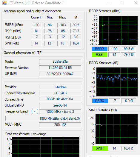

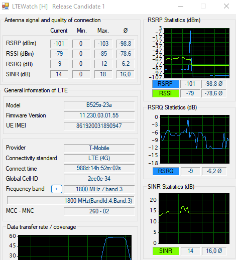

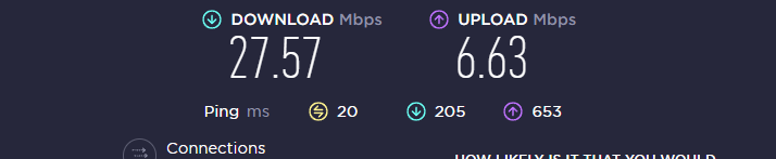

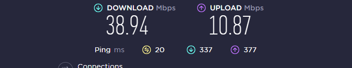

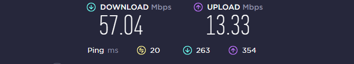

    #20 20190658
    TAGBA
    Posts: 201
    Rate: 85
    Hi In my case, will it be possible to improve the signal parameters for the 1800 + 800 bands after installing the external antenna? LTE huawei b525 router
    Network and transmitter T-Mobile (26002) ID: 22150. In a straight line to the transmitter 2.3 km
    Measurement:
    800Mhz
    Huawei B525 LTE: Band Aggregation 1800+800 Speed Issues, Orange Network, B315 Comparison Huawei B525 LTE: Band Aggregation 1800+800 Speed Issues, Orange Network, B315 Comparison
    1800Mhz
    1800 + 800
