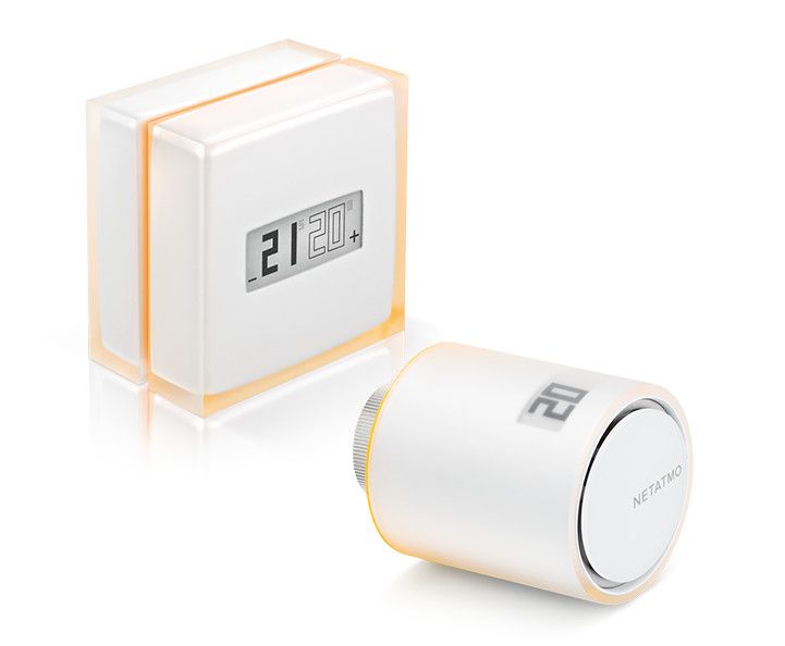

  • Remote home control is becoming increasingly popular. Legrand offers very intuitive solutions that work well together. In its range of Legrand Netatmo , it has a number of solutions to make the home even more secure and convenient - with one click you can turn off all the lights, lower the blinds or turn down the heating.
    An extremely important element of the Smart Home especially now - during the heating season - is the thermostat and thermostatic heads , which can also be found in the Netatmo offer. This convenient solution allows you to change the temperature in your home while you are away - for example, when returning from winter holidays. You can control the heating from your smartphone with clicks or, if you prefer, a voice assistant. The intuitive app should not cause anyone any operating problems. Simply answer five questions and the thermostat will create a schedule taking into account the habits and lifestyles of the home's inhabitants. Any number of schedules can be created.

    Does this kit have heating zones? That is, when any of the heads/sensors request that the cooker be switched on, the thermostat will do so, or does everything depend on the temperature registered on the thermostat?
    In the case of Honeywell Home, you can set up heating zones, group several heads in them, buy additional sensors and as soon as the room temperature drops below normal, the furnace starts heating even if the thermostat reads a higher temperature. Of course, all valves that are "above" the set temperature will be closed and the room in question will not be heated.
    I have seen many solutions where the only source of temperature for switching on the cooker is the thermostat and if you place it in the warmest room, you may find that the cooker will not start for a long time, cooling the other rooms even more.

    There is no information on how the valves are closed. I.e. what kind of actuators there are.
    There is no word about security, or how to react to e.g. .... no connection to the net, because the router broke down.
    There is no information about predictive control or the control of heat emitters other than radiators. It is not about lighting a fireplace or a goat....

    I have a question regarding Netatmo.
    I would like to install a Netatmo thermostat + heads
    How do I do this as my living room is underfloor heating and my rooms are radiators with heads.
    If I have mixed heating (underfloor and radiators), will it not work for me? I'm worried about the living room with underfloor heating, will a thermostat connected to the cooker and hung in the living room be responsible for the temperature there and switch the underfloor on/off, while Netatmo valves fitted to the radiators will be responsible for the rooms?
    Do I have to replace a thermostat in the underfloor and connect the Netatmo to it?
