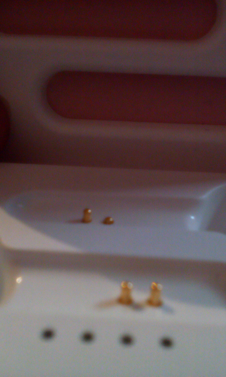

    One Bluetooth handset does not charge me, I put it in this charging box and it flashes red the charging cube sometimes does not turn on at all and with a working handset it charges normally and three want to put in a broken one it turns off and turns off it cannot be turned on what can I do in such a situation to make headphones to throw away?

    Hello. A frequent reason for the lack of charging of such headphones is the deterioration of the contact quality between the pins protruding from the box (charger) and the contact pads in the handset itself. Inspect it carefully and make sure there is no dirt or tarnish. For example, when women use such headphones, the contact areas are covered with foundation or other specificity applied to the face. 😁

    Thank you very much for your help, I looked at everything very carefully and it turned out that there is a pin in the box that is as if "pressed in", I pulled it out I put the handset in again it does not charge and it fell inside again as if it is not pushed up again, nothing I will ask what about thank you very much again for this

    I was supposed to write earlier about the elastic contact (that's how it can be called).
    There is only one piece of advice here - disassemble the charging box and try to repair this contact - the spring pushing the contact upwards is probably damaged. This is a job for the "handyman"
    I can't help much remotely. You have to look in your place of residence - maybe some mobile service will want to fix it.
    Good luck!

    I exchanged for new ones
