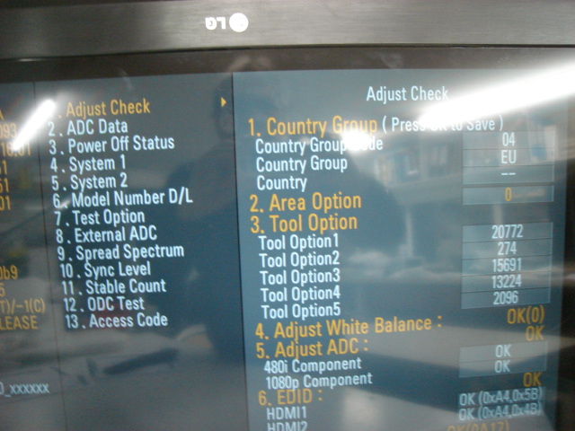

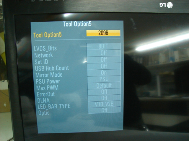

    good afternoon, after replacing the display on the lg 32ls3500-za TV the image was inverted and I can't access the mirror mode parameter, thanks for your help, along with the photo
    thanks

    Only with service remote control:
    Procedure:
    1. Press ADJ button on service RC to enter service mode.
    2. Go to "Tool Option5".
    3. Move to "Mirror Mode" and set option to ON or OFF (according to panel).

    Good morning, and thanks for the reply, I've tried this but mirror mode is not accessible and I can't change any option, the TV is not in hotel mode, I couldn't update by USB, I'll try to find the U401 firmware

    Mám tenan istý problém, vošiel som do servis menu zmenil parameter mirror mode to OFF ale nejde mi uložiť nastavený parameter.
    Viete mi advízať prečo
    Hello, I have the same problem, I entered the service menu, changed the mirror mode parameter to OFF, but I cannot save the set parameter. Can you advise me why?

    good afternoon, i think it is: service 0413 in START 0413 ADC DATA parameter 1 save to NVRAM :ON

    using the service remote control to rotate the image correctly
