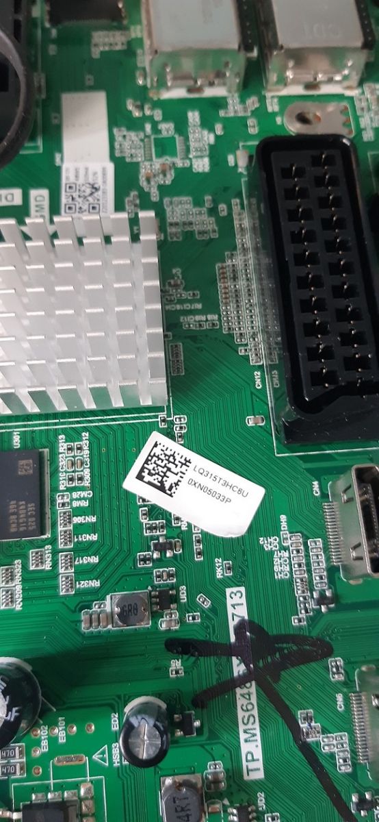

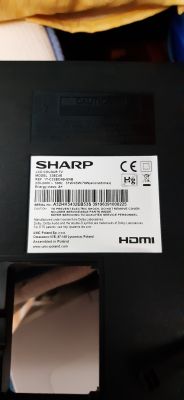

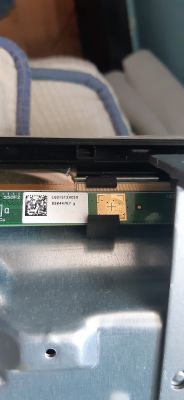

    Hello to all.
    Sharp Aquos motherboard burnt out TP.MS6486X.PBT13 for Panel LQ315T3HC5U.
    I bought a new one, TP.MS6486X.PB713, but the panel is LQ315T3HC6U.
    Now I have an inverted image (upside down).
    I tried many things, but none of them work.
    From the service menu, there is no way to change it.
    What firmware am I supposed to install?
    Do you have the firmware? Sharp Aquos TV motherboard with model labeling. Close-up of a Sharp Aquos TV motherboard labeled TP.MS6486X.PB713. Close-up of panel with label model LQ315T3HC5U. Label of a Sharp TV with model information and technical specifications.

    In the service menu can you enter the matrix type?

    here is the correct software for panel LQ315T3HC5U
    copy the files UMC_6486x_aes.bin and UMC_KMODE.txt on an empty usb stick fat or fat32 formatted
    sometimes it works in fat, sometimes in fat32
    insert the usb stick in the tv, then plug the AC mains, and then switch on the tv: an update bar should appear
    if a letter K appears on the screen: tv is in factory mode
    enter in service mode with the sequence MENU 1147, then Init TV or Shipping Init and press ok to reset the tv

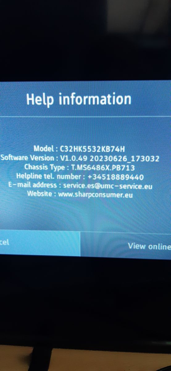

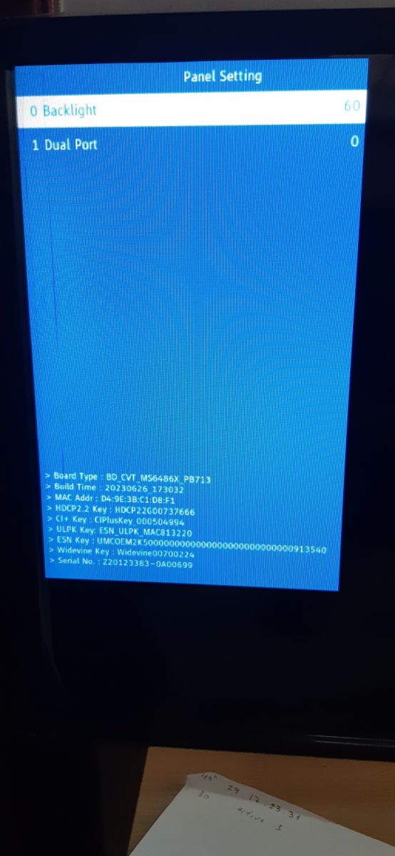

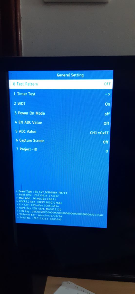

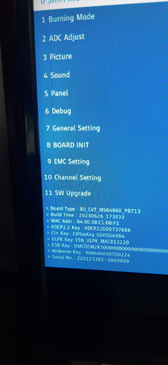

    >>20724177
    Negative I cannot see what panel it is
    Configuration settings screen displaying a list of options and technical information. Screen with panel settings displaying technical information. Service menu of a monitor displaying settings and motherboard information. Help screen showing model C32HK5532KB74H and software version V1.0.49. EMC settings menu displayed on a monitor screen. takes
    In Panel You can see ID Project and it's set to 0
    I tried with the next 6 numbers from 0 to 6 and the screen becomes black and has to install the firmware again
    After checking the log, I noticed that the matrix is: ************************Set default panel start*****************************
    ************************Set default panel end*******************************
    Warning!!! Mirror Type is not NORMAL, but Mirror is DISABLE. panel name len:14
    HD_LQ315T3HC6U
    Do you have any idea how to correct that error?

    Unfortunately, I still see the same.
    No change. Something is blocking the software from accepting the changes.
    The panel I logged into is the one on the motherboard, however, I think that probably it must be the matrix of the panel itself. Unfortunately, for some reason, it is not accepting the changes.
    Is there any way to edit the firmware?
    Thank you.

    in service mode, check if there is a item UART BUS
    if it's set to off, change it to on
    then retry with the software restore
  • #8 20725385
    mrodassotelo
    Level 4  
    Posts: 6
    Yes, there is a UART BUS and it is ON.
    I had already tried in different ways.
    This motherboard is strange. To enter the service mode, I have to press MENU and 1147 two times. It will be MENU 1147 1147. Otherwise, it is impossible to enter.
    Thank you for your cooperation.

    >>20725374
    I finally got it right!!
    All I did was modifying the UMC_KMODE.
    I had read in one of the posts that somebody did it only replacing the PANELID 9 and writing the panel number.
    I tried as well and it never worked.
    Today I modified the UMC_KMODE and in PANELID, I put the panel number of the TV, but I also added one line MIRROR:1.
    And now all is OK.
