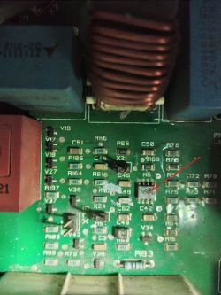

    az1234652
    I found this burned. I don't know the label. Does anyone know what this chip is
    Kemppi Minarc Evo 150 the display flashes for a few minutes and goes out Kemppi Minarc Evo 150 the display flashes for a few minutes and goes out

    IR1150 or IR1155

    How to examine A6W transistor?
    Do you have a scheme
  • #6 19891652
    smd
    Welding machines specialist
    Posts: 542
    Help: 98
    Rate: 249
    A6w is a diode, about 0.6V. I don't have a schematic.
