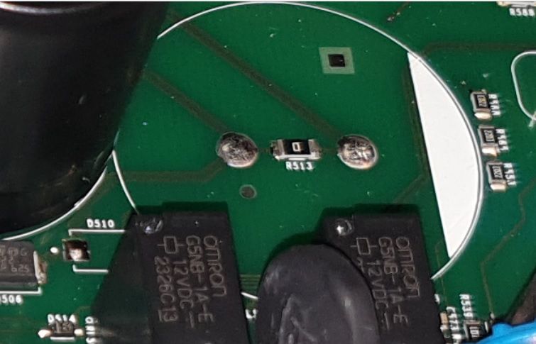

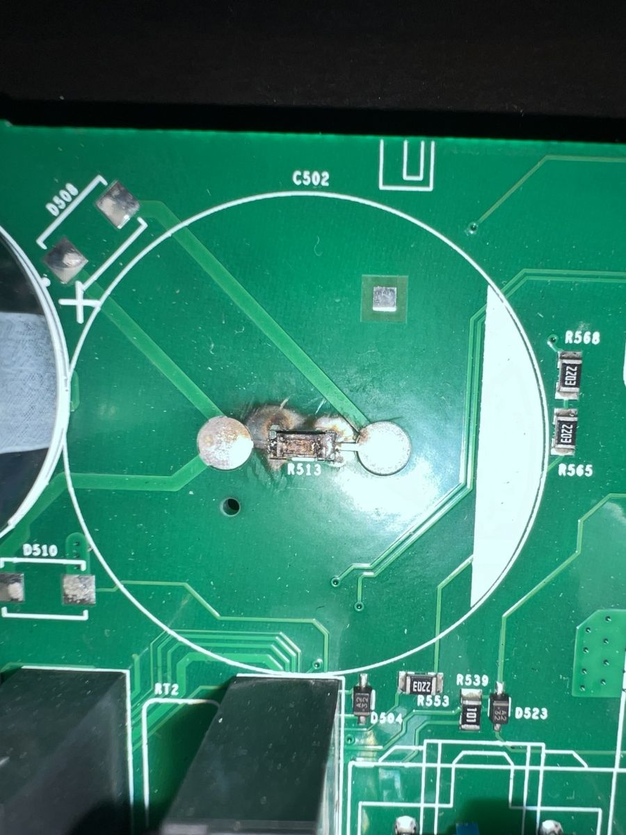

    Hi, I have the control board from an Electrolux dishwasher. The dishwasher is completely dead, the board seems to be fine. It has no hot spots or contacts, I only found this, see the attached photo.
    It is some kind of SMD resistor with position named "R513" - next to the (filtering) capacitor for the switching source. The repair is definitely unprofitable but I'd still like to try it. I have some experiences, unfortunately I don't have access to the schematics.

    It initially looked like a capacitor dischare resistor, but as crazycavan pointed, if that resistor is 0R and it blew up, it was probably placed there to allow the configuration with one capacitor or two in series (Maybe a voltage doubler for the american market?). In this case it is bypassing the non existing capacitor. The fact it blew could indicate a short into one of the IC modules.
    Normally one would attach a incandescent bulb across it for testing pourposes. If it tries to start, it is safe to bypass that resistor, If the bulb is fully lit, it means a short - will require further investigation before power can be safely applied...
    Disclaimer: Never mind me saying... This is full rectified AC mains - Lethal - Please only troubleshoot if you're confortable and qualified working with these sort of voltages. DC is far dangerous than AC.
    I don't see a rectifier on that board. Is there any other PCB, where the AC incomming supply comes from?
    Do check, if you have ~340V on that large capacitor, once powered (remove the SMD resistor first). I believe the brown capacitor next to the transformer should be a 400V type too. Check that too. It defenitivelly should have voltage. if none of them have, you need to track down the circuit to see what gave (Likelly a fuse or a PCB track).
    That black disc between the two relays is a NTC Inrush Current Limiter. Do check there's about 10Ohm across it.

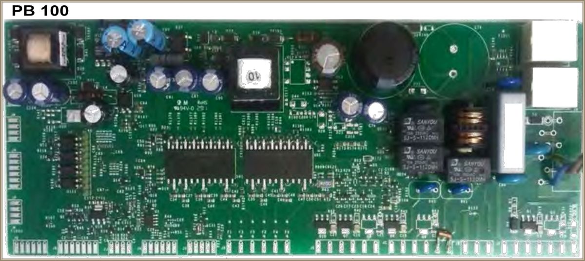

    Are you sure you`re not misleading us? Look, it`s only similar to me, and the photo shows PB100 (if you know what version it is, please write it) :)

    In the author`s photo there is a PB100 module, index 140000406078 -> 140000406011 -> 140000406102 -> 140000406136 -> 140000406201 -> 140000406169 -> 140000406185 -> 1400004 06268 -> 140000406243
    The same one with galvanic separation, second power supply and transformer is PB101 index 140101108102 -> 140101108128
    The photo you showed comes from the service documentation and I am not sure whether it was implemented into production in "this" form (the microcontroller is missing or it is from the external side).

    Ondrash1
    >>21026301
    You're right, repair is really unprofitable. After taking a closer look at the board, I found that the IGBT module housing had been lifted from the side and cracked. There are also heated SMD elements in its vicinity.
    Therefore, the owner finally decided to invest in a new machine. Thank you all for your replies.
    You are right, the repair is really unprofitable. Upon closer examination of the board, I found that the IGBT module case was lifted from the side and cracked. There are also heated SMD elements in its vicinity. Therefore, the owner finally decided to invest in a new machine. Thank you all for your answers.
