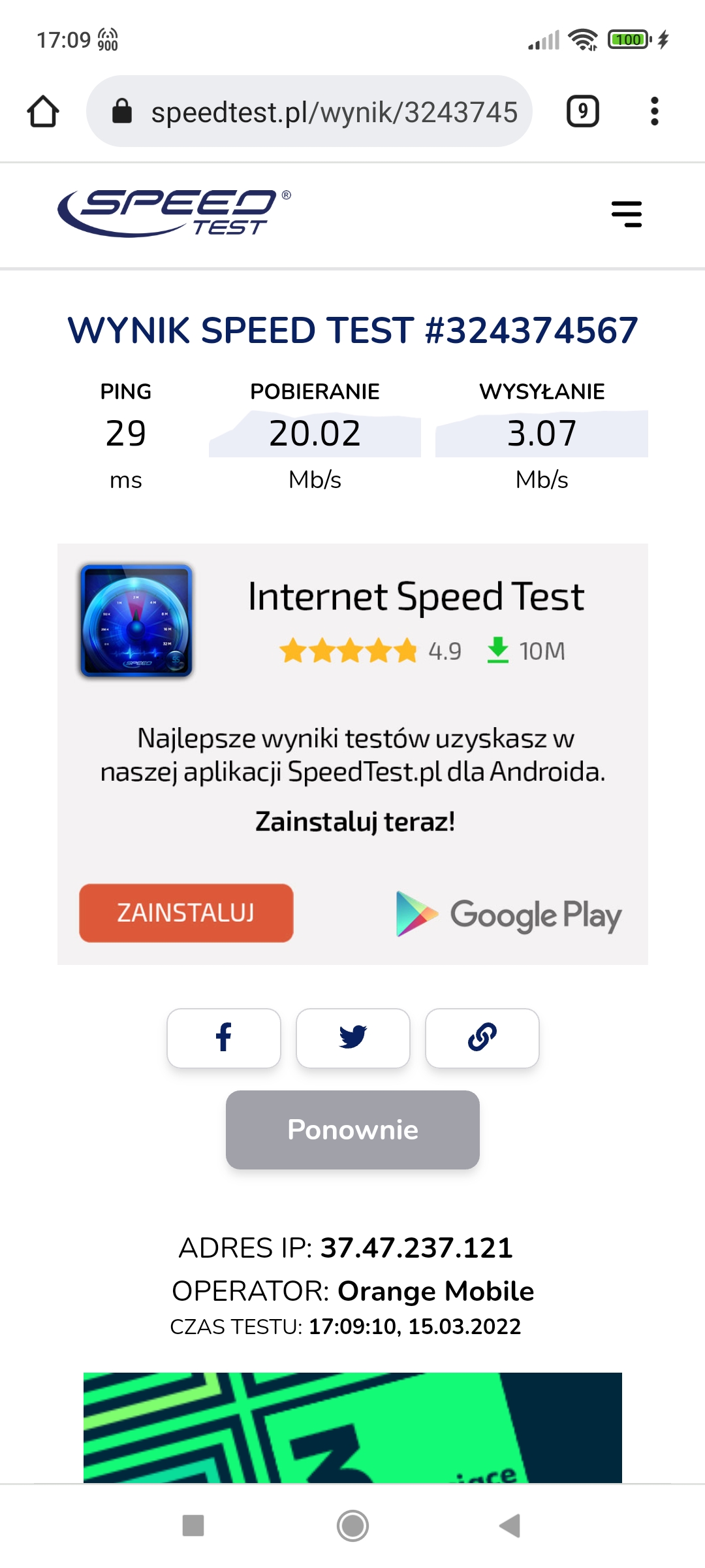

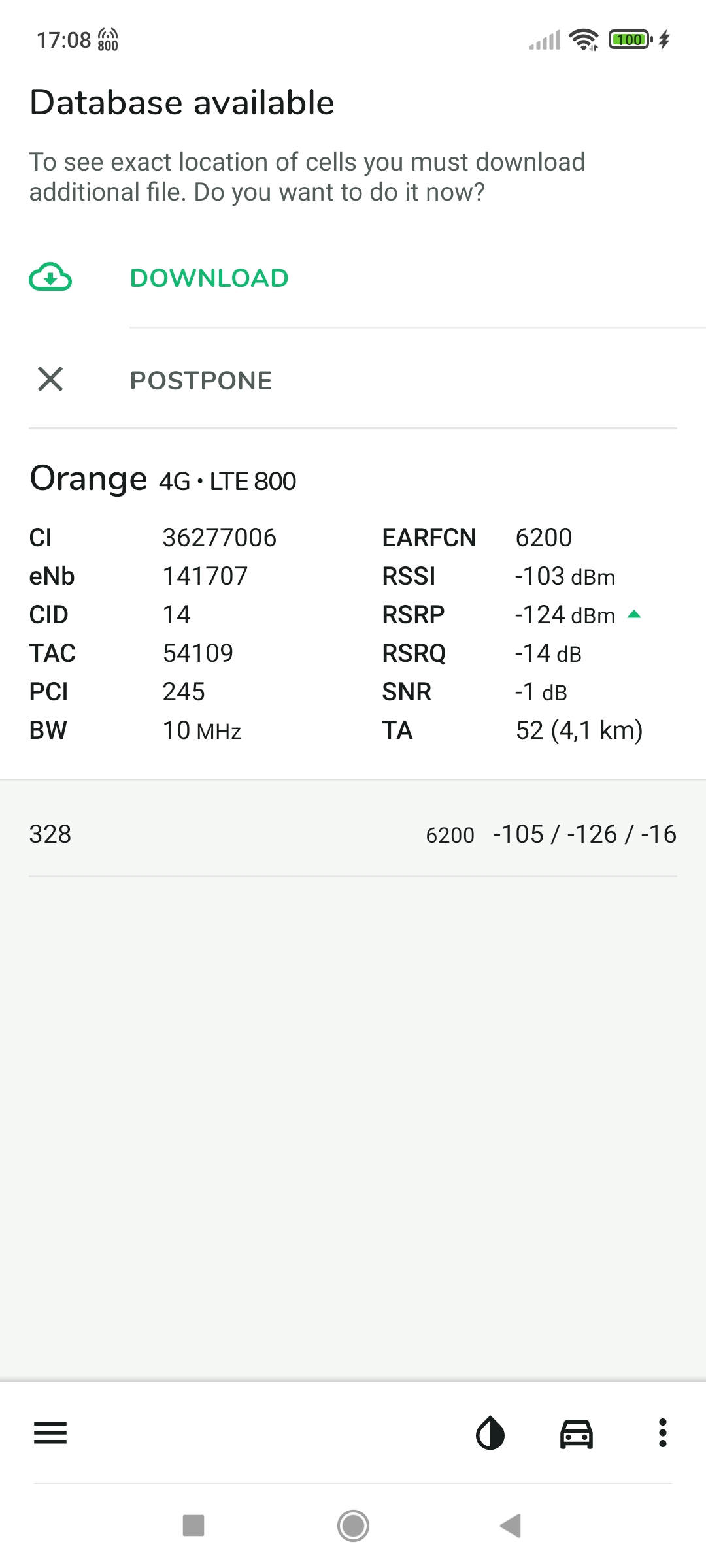

    Yes, I have the Orange network from the free market. 3km to bts. I have an antenna https://new-electric.pl/643-2470-antena-gsm3g...ektory-2x_sma/208-wybierz_dlugosc_wodu-2x10_m as from the link .
    • Is it worth choosing the TCL LINKHUB HH130V1 router to improve Internet quality? Screenshot_2022-03-15-17-09-17-468_com.android.chrome.jpg (435.53 KB) You must be logged in to download this attachment.
    • Is it worth choosing the TCL LINKHUB HH130V1 router to improve Internet quality? Screenshot_2022-03-15-17-08-11-111_cz.mroczis.netmonster.jpg (231.04 KB) You must be logged in to download this attachment.

    Test on the phone at home outside? Speedtest made over WiFi, so from the network of the MR6400 router with these antennas, do you at least know what LTE band this router connects to, what BTS? By the low UL, it can be assumed that the signal parameters on it are weak. The phone connects to LTE800 on BTS NetWorks Przechlewo, residual signal parameters, LTE1800 from this base station is not shown in the neighbors, apparently trace range or no coverage on this band. The station works in the LTE1800 + 800 aggregation, i.e. on the 20MHz band in the aggregation, I would like to see these 120Mb / s under BTS on a speedtest made between 19-23. The NetWorks infrastructure is very weak, naked base stations are based on 10MHz on LTE800, only the naked one in Przechlewo got another 10MHz on LTE1800 so it works somehow, no information about your location but it is obvious that you do not live in Przechlewo and you are quite far from the station.
  • Need LTE band and BTS details

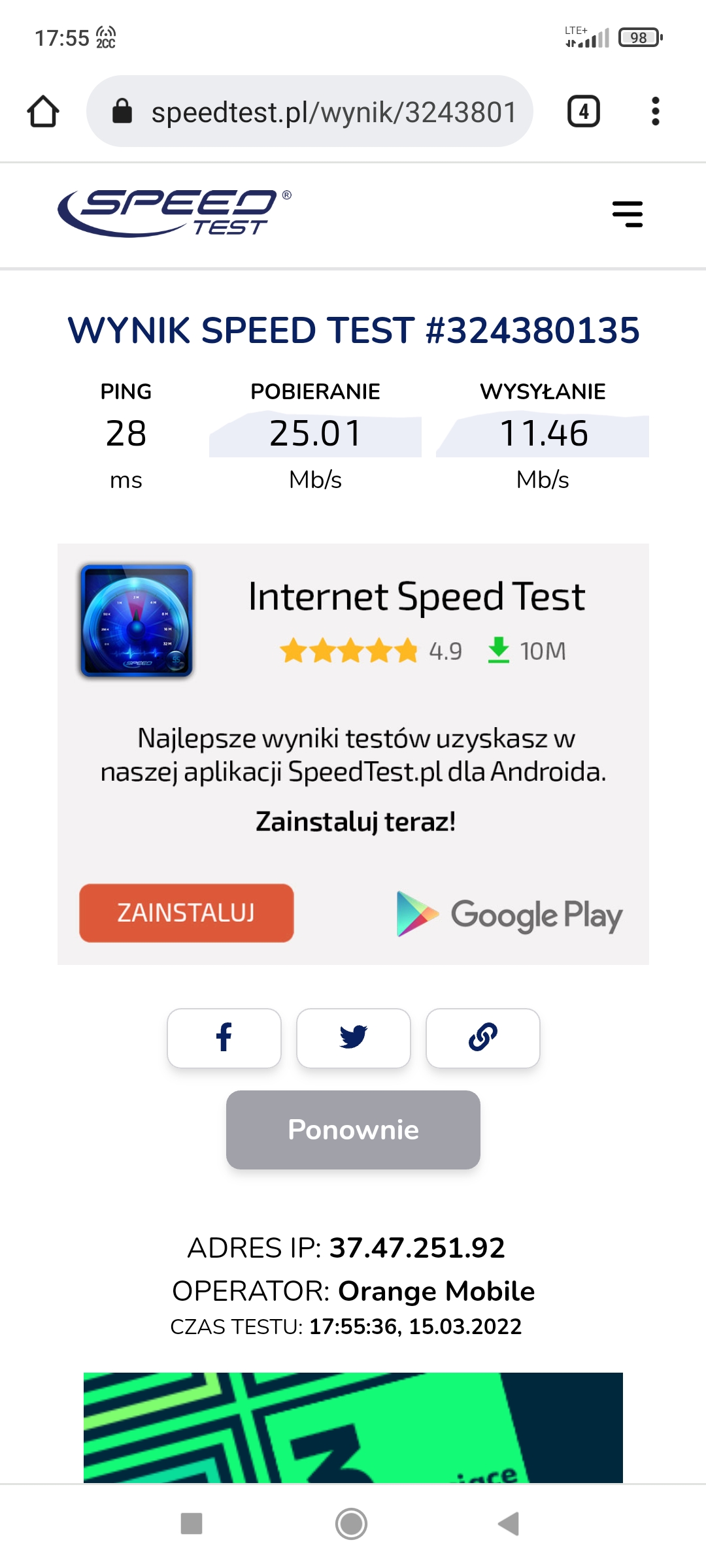

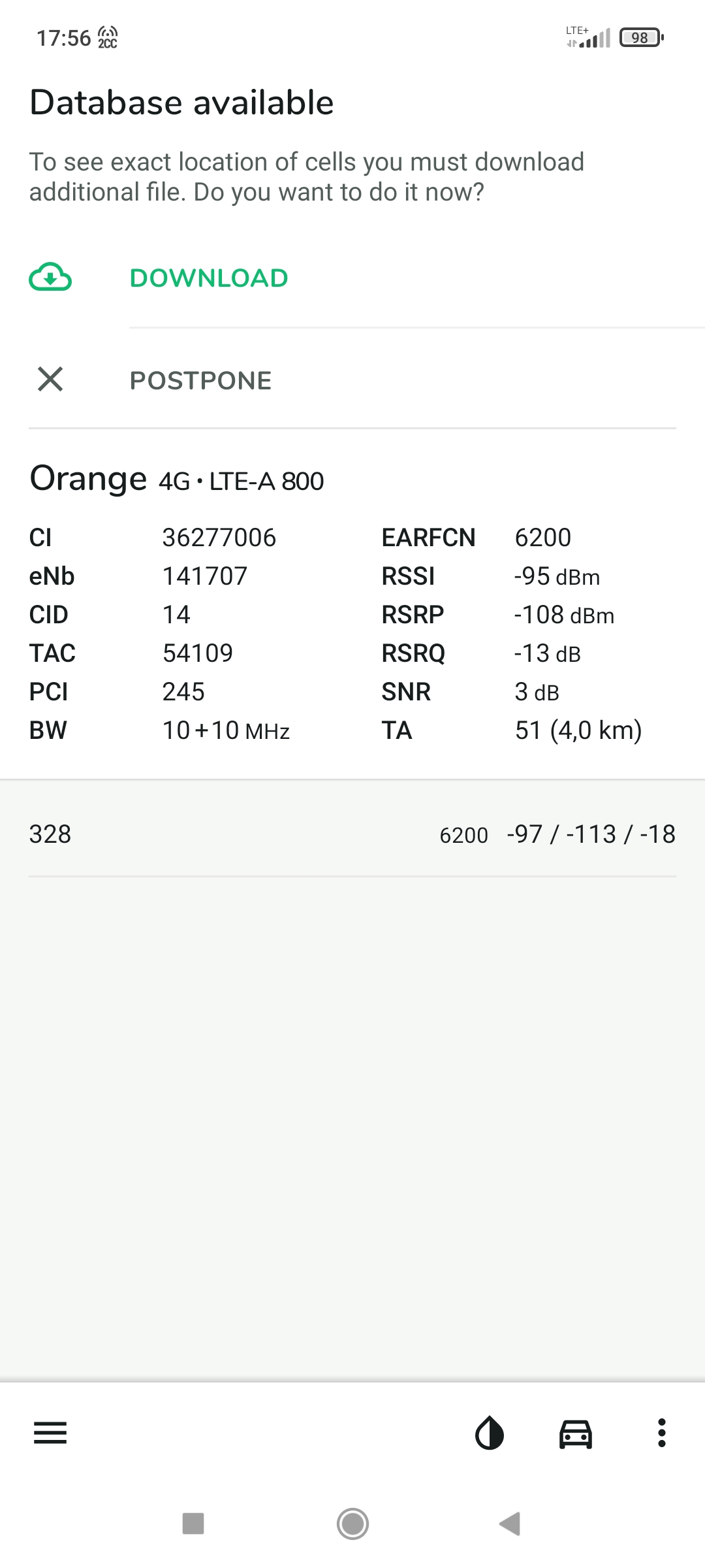

    In a straight line I have 1km, maybe 1.5km to bts. I'll test it soon and post pics
    Added after 7 [minutes]:
    matek451 wrote:
    Test on the phone at home outside? Speedtest made over WiFi, so from the network of the MR6400 router with these antennas, do you at least know what LTE band this router connects to, what BTS? By the low UL, it can be assumed that the signal parameters on it are weak. The phone connects to LTE800 on BTS NetWorks Przechlewo, residual signal parameters, LTE1800 from this base station is not shown in the neighbors, apparently trace range or no coverage on this band. The station works in the LTE1800 800 aggregation, i.e. on the 20MHz band in the aggregation, I would like to see these 120Mb / s under BTS on a speedtest made between 19-23. The NetWorks infrastructure is very weak, naked base stations are based on 10MHz on LTE800, only the naked one in Przechlewo got another 10MHz on LTE1800 so it works somehow, no information about your location but it is obvious that you do not live in Przechlewo and you are quite far from the station.
    • Is it worth choosing the TCL LINKHUB HH130V1 router to improve Internet quality? Screenshot_2022-03-15-17-55-43-263_com.android.chrome.jpg (432.68 KB) You must be logged in to download this attachment.
    • Is it worth choosing the TCL LINKHUB HH130V1 router to improve Internet quality? Screenshot_2022-03-15-17-56-08-461_cz.mroczis.netmonster.jpg (228.72 KB) You must be logged in to download this attachment.

    Now, probably outside, the phone connected to the LTE800 + 1800 aggregation from this BTS, hence the much better speedtest and UL on it. Signal parameters outside on LTE800 are weak, on LTE1800 probably even worse, speedtest is OK for not, you need to check speeds around 20 when the station is heavily loaded by customers.

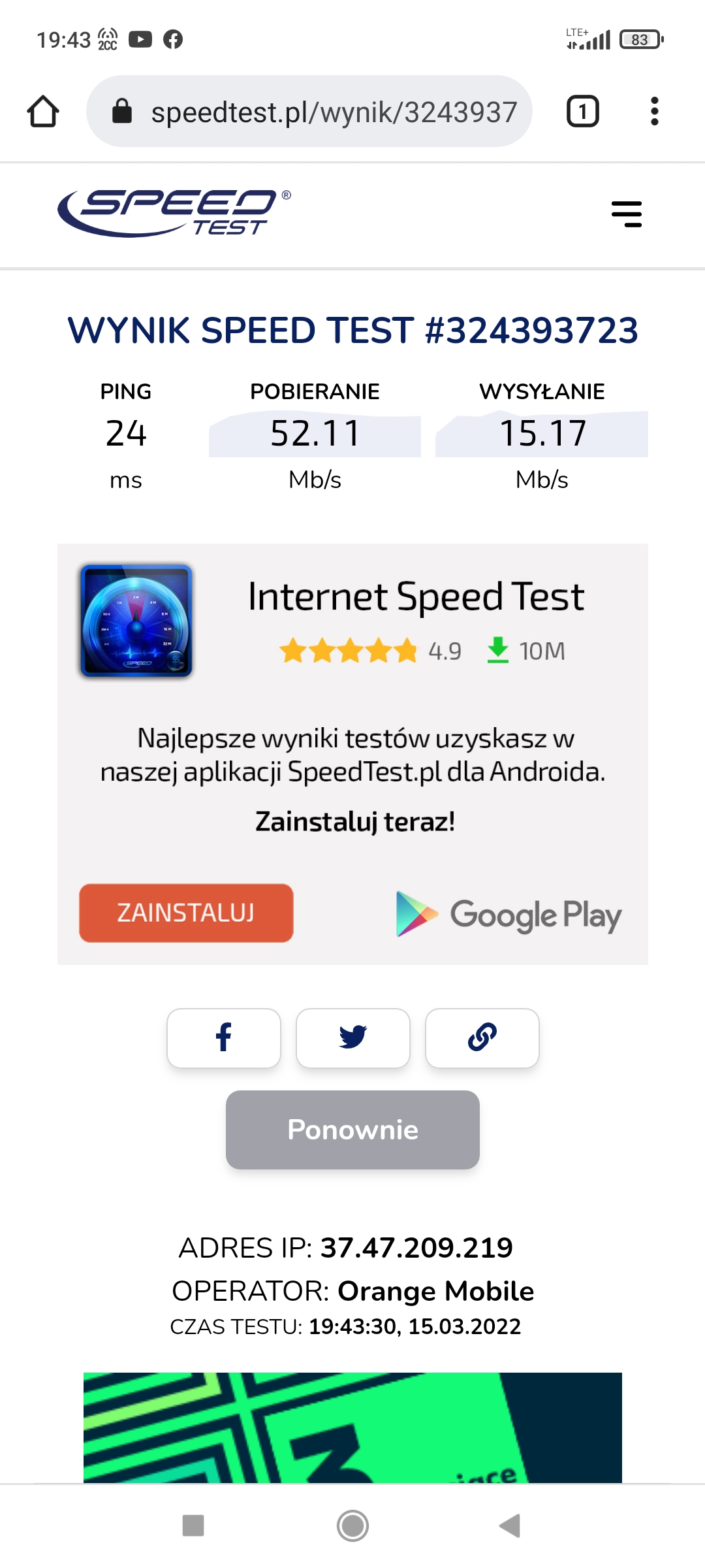

    kozowski66
    Posts: 17
    matek451 wrote:
    You don't need any mega equipment for the NetWorks base station you have at home, because, as I wrote, NetWorks in this area is misery, you are lucky that LTE1800 was added to your place, because the surrounding other BTSs with bare LTE800 are a drama, the nearest normal station with LTE2100 1800 800 is located in Rzeczenica. Do these tests and show the results.
    • Is it worth choosing the TCL LINKHUB HH130V1 router to improve Internet quality? Screenshot_2022-03-15-19-43-35-410_com.android.chrome.jpg (433.89 KB) You must be logged in to download this attachment.

    This is an outdoor test at your place, signal parameters unchanged, LTE800 + 1800 aggregation, very good speeds, the station is not heavily loaded.
