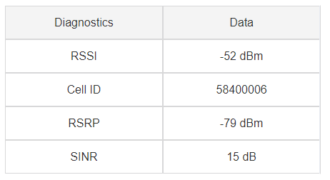

    Hello!
    I recently purchased the Internet from T-Mobile along with the TCL LINKHUB HH130VM router. The Internet is currently slow, but this is probably due to poor reception from outside.
    I`m asking what external antenna I can buy for this router to improve things and whether the antenna will do anything at all?

    And where do you use T-mobile on this TCL? This router does not have normal signal diagnostics, BTS, it does not show aggregated bands, what speeds do you currently have on it in T-Mobile?

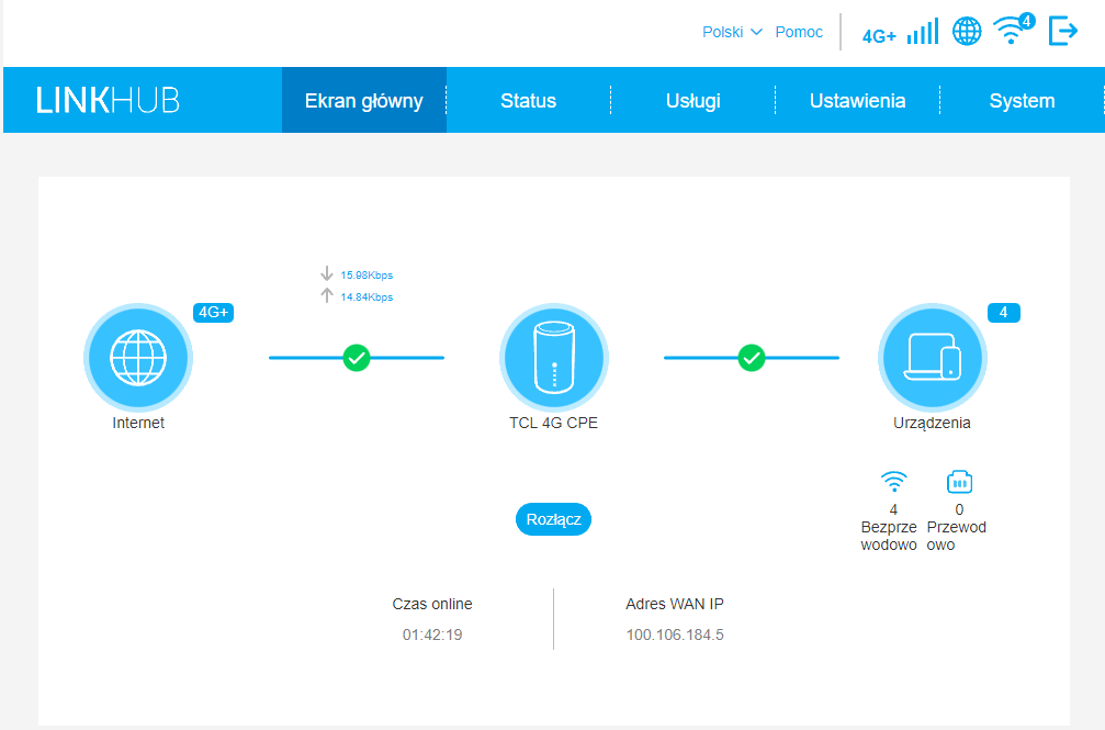

    I use it at home, I don`t know if it has signal diagnostics (I only had it yesterday), after logging in to the website I only see something like this.
    Which antenna should I choose for TCL LINKHUB HH130VM and will it improve the range?

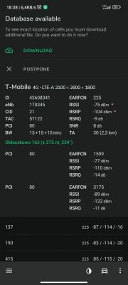

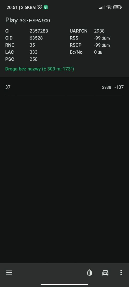

    But don`t show me the pictures because I have this weak router, of course bought only for testing and not for use, in my Play it reaches a maximum of 200Mb/saw in aggregation of 3 CC QAM256, T-mobile about 120Mb/s, I`m asking about your location, you need to check what NetWorks BTSs you have nearby, the next step is to test on the T-mobile card but not on TCL because nothing will work on it, only on the phone with the application https://play.google.com/store/apps/ details?id=cz.mroczis.netmonster&hl=pl&gl=US, screenshots from the application will show the necessary data, the test next to TCL, and the speedtest result on the phone. And you didn`t boast about the speedtest with TCL at this time.
  • Requesting nearby BTS data and NetMonster screenshots
    What`s the point with this app?
    Which antenna should I choose for TCL LINKHUB HH130VM and will it improve the range? Which antenna should I choose for TCL LINKHUB HH130VM and will it improve the range?
  • Need NetMonster screenshot for T-Mobile BTS identification

    But you would test on the T-MOBILE card, not the Play card, the speedtest over WiFi with TCL shows average DL and a very weak UL, tpo is normal with a weak signal on the basic LTE band, TCL shows LTE+ so it works in the aggregation of LTE bands. This is the only information that can be stated so far. The lack of a NetMonster screenshot for the T-mobile card does not allow you to check which NetWorks BTS in the Września area you are using.
  • Need NetMonster screenshot for T-Mobile BTS check

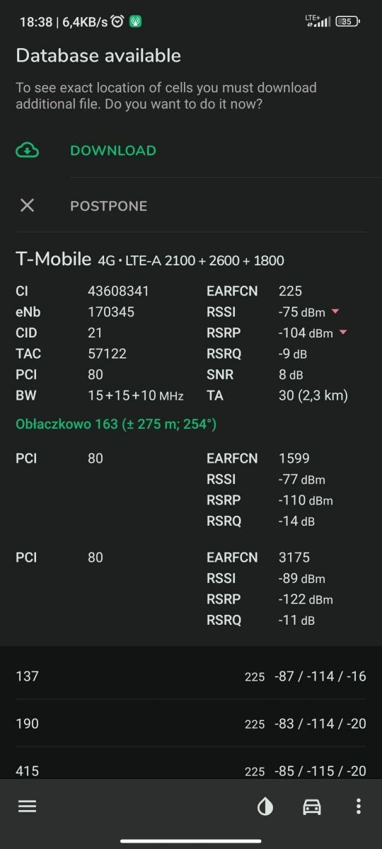

    I understand, I`ll give you a screenshot of NetMonster tomorrow.

    This is a NetWorks base station at Objazdowa 1 in Września, a weak signal on LTE2100, even weaker on LTE1800 and a partial signal on LTE2600. In such a situation, what does a speedtest look like on a phone with a T-Mobile card but not via WiFi? In such a situation, a Dual LTE1800-2600MHz antenna is necessary to aggregate these three LTE bands.
  • Dual LTE1800-2600 antenna recommended for band aggregation

    This station has an aggregation of 4 LTE bands, two sectors are directed to the A2 direction and the third to Obłaczkowo. The station probably has a lot of potential.

    In the direction of BTS, but you won`t be able to check the signal parameters on TCL because there is no proper diagnostics in WebUI.

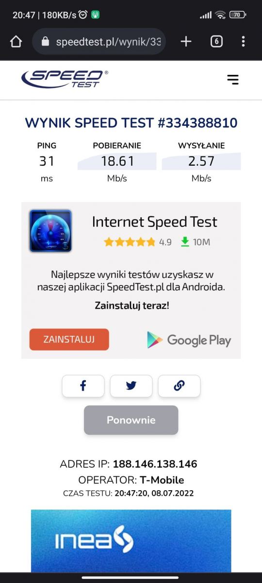

    So I bought this antenna, set it up, connected it and the result is even worse than without the antenna. I don`t know if I did something wrong or do I need to set something else to download it from the antenna?

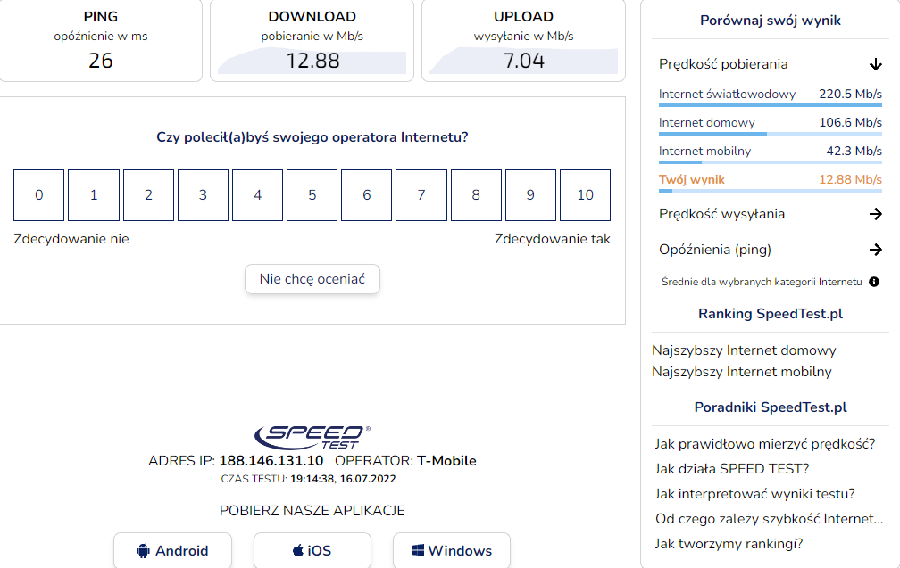

    matek451 wrote:
    The antenna is set to this BTS, what does the speedtest look like with it?
    Today there is something like this, yesterday on the speed test the download and upload speeds did not even exceed 1 mb/s.

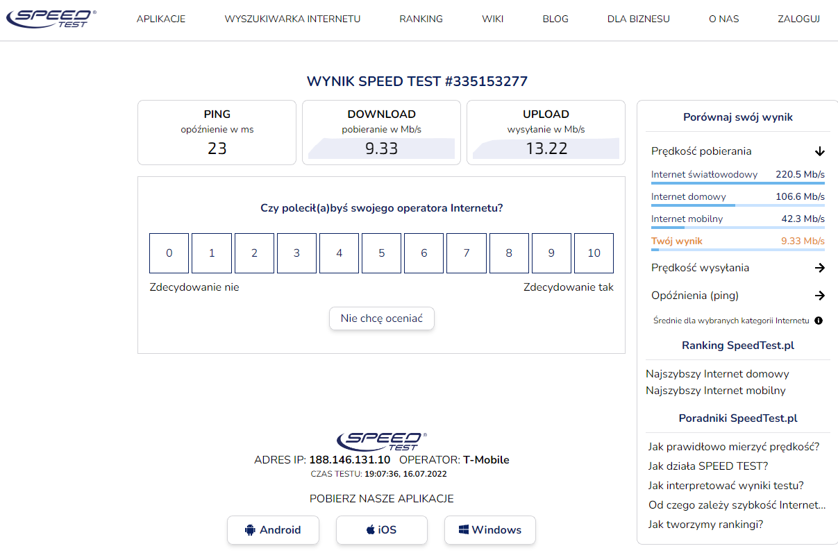

    Added after 4 [minutes]:
    Here is a speed test without an antenna connected for comparison

    The problem of this router is the lack of even basic station, band and signal diagnostics, so it is not known which bands are aggregated with and without the antenna, what basic ones and what signal parameters are on it, the first test shows that the sector on the base station is overloaded, no limit in T- mobile is taking its toll.
