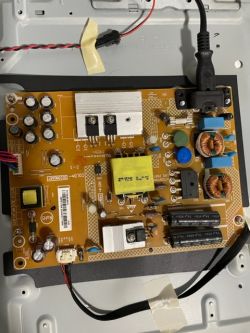

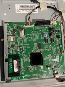

    here are pictures of mbo and psu

  • Backlight failure after firmware update
    #8 19943324
    vservis
    PHILIPS 32PHK4309/12 - TV turn on with logo and then screen off
    i made update, here is picture!
    I changed USB stick and i made update.
    No update screen shows when updating.
    now, when i turn on TV, get PHILIPS logo for 0.5 seconds, and then TV backlight goes off.
    but if i get battery light and put it on screen i see menu on tv.
    can change channels, play usb music.
    no backlight.
    backlight only 0.5 sec on start TV.
    so now need to fix backlight

  • #10 20526284
    kaz69
    Level 37  
    Posts: 3360
    Help: 393
    Rate: 543
    Replaceable LED backlight.
