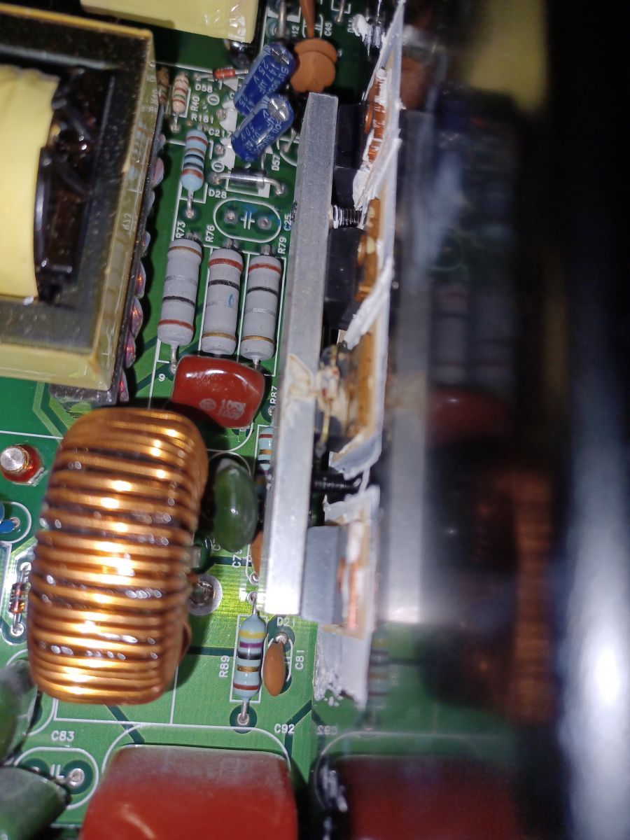

    Need help finding out what this cap is, it's labeled C75 on the picture. Reason being mine has burnt out and need to locate what it is so I can replace it. Thanks for any help or comments, all very appreciated.

    It's 100nF 100V. Best image I can get shows 105 100V and mine measures 96.5nF in circuit.

    If you tilt this C75 a bit, you can see the description and the light becomes bright.
    And on what basis do you claim that it is "burnt out"?
    To put it mildly, this would be a very strange and practically unheard of damage.
