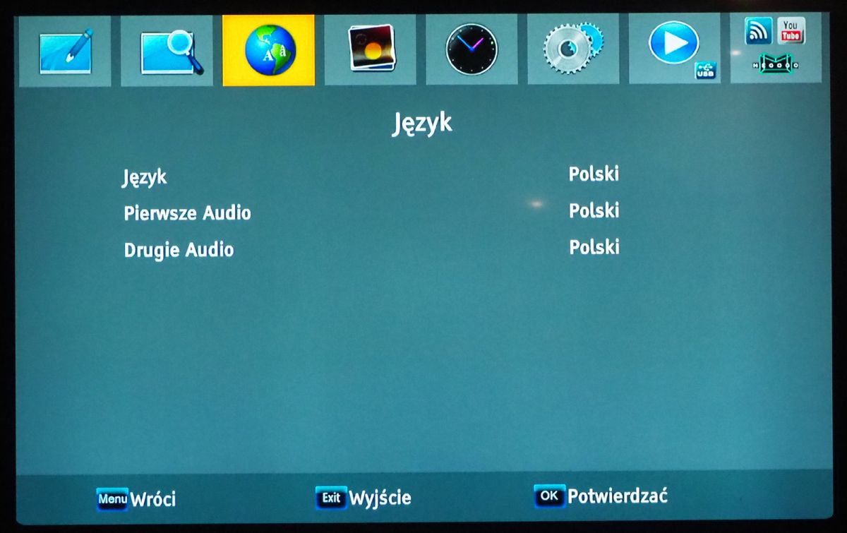

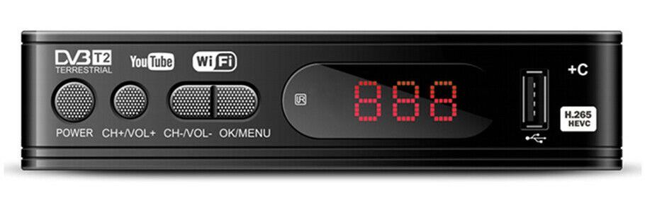

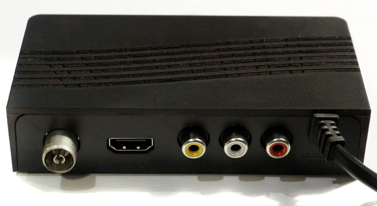

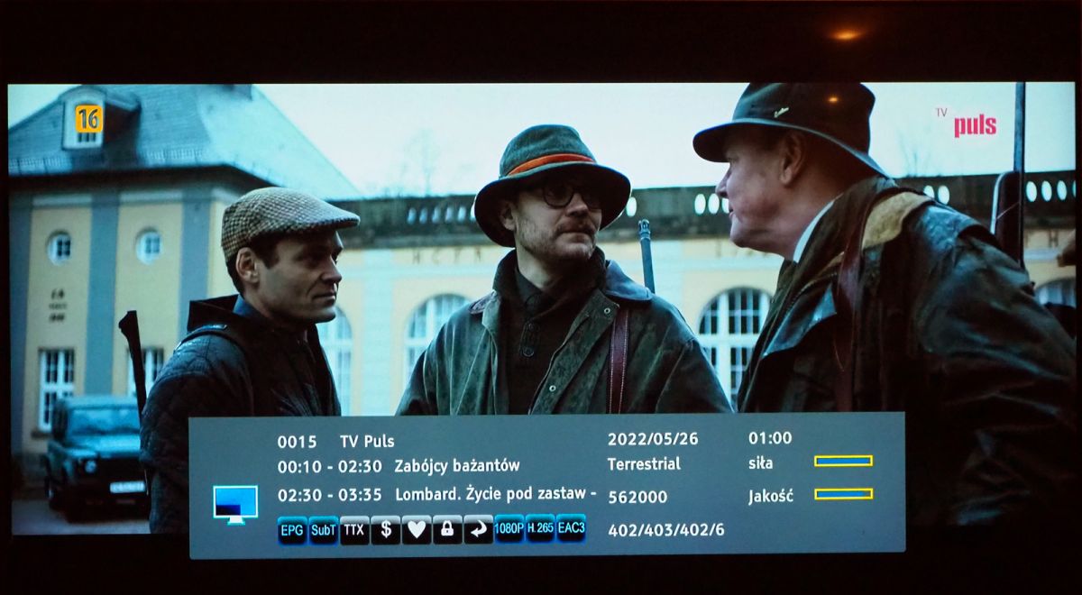

    I have a DVB-T2 HEVC decoder from Aliexpress that works, but there is no sound in h265 programs. Everything is displayed, signal parameters, type of sound, etc. There is no name or symbols on the decoder, after entering the menu there are data:
    Model: HD120_CID
    HW version: V202
    SW version: V10023_2021/03/30 17:57:38
    I found some more data
    Processor: MT2203
    Tuner: TC6800
    System: DVB-T/T2/C compliant
    Previously, the informative, test channel of Polsat worked, but when they turned on other h265 programs, there is no sound in them as well as in the test one from Polsat. Maybe someone knows what model it is and what current firmware to look for and where. Many hours on Google didn't help.

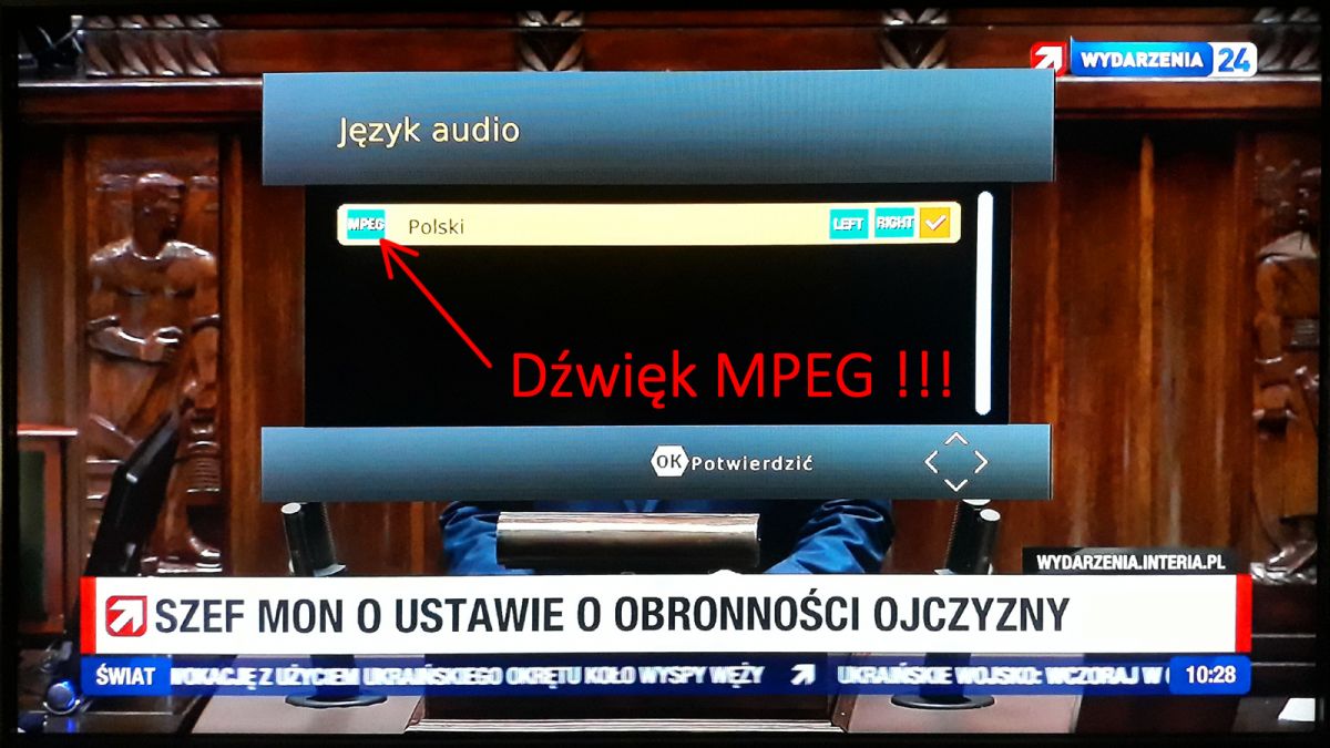

    _cheetah_ wrote:
    If E-AC4 isn't already implemented, I wouldn't count on any updates. Licensing issues, no matter how OEM it looks.
    Check in the menu and in the soundtrack, if there are no - maybe the Audio track is set wrong or something...
    https://forum.emitel.pl/viewtopic.php?t=8225
    I checked the soundtracks. Even when there are several to choose from in a given program, none of them work. There are no other sound settings.
    I noticed something strange, on another decoder, Events 24 has MPEG audio, and there is no audio either, and it used to be (before May 23, 2022).

    You probably won't solve the problem so easily now, this tuner is adapted to the Russian market and has support only for MPEG-1 and MPEG-2 Layer II, i.e. no support for MPEG-H (AC-3 and AC-4).
    Just once again, it should be noted that most set-top boxes bought on Aliexpress do not meet the requirements of the standard adopted in Poland, usually they are not even intended for sale on the European market.

    There are no regional settings. There is only software language change which doesn't change anything except the displayed language.

    You are unlikely to solve anything, the chipset does not have hardware support for the required AC3 and E-AC3 audio format.
    p.s. I can bet that programs recorded on the tuner and played on the computer have sound without a problem.

    The second version is a tuner with a different processor and support. Under this designation there were several versions of this tuner for different models and sellers.
    No new software will cause the operation of something that is not in hardware support.
