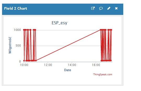

ESP Easy and ThingSpeak configuration - combining data from three devices on charts

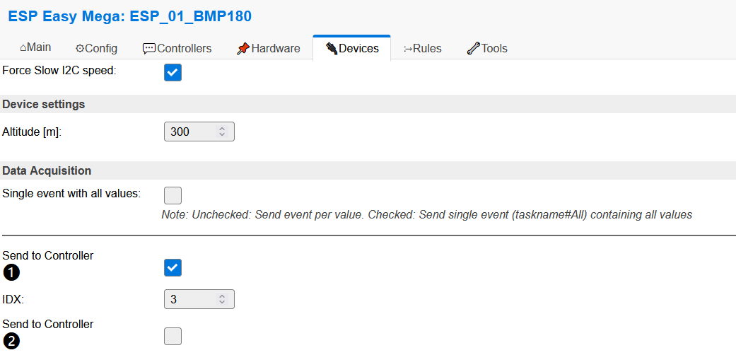

    First of all, uncheck "Single event with all values", ticked causes all data to be sent in the same message. When unchecked, temperature and pressure are sent in separate messages.

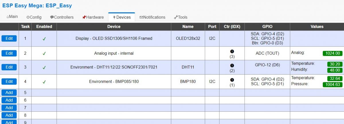

    Another issue is sending to the controller. Your controller is the ThingSpeak server, on the server you have several tables set up where the data is entered. The IDX parameter determines into which table the value should be written. In my case, temperature will write into table 3 on and pressure into the next table.
