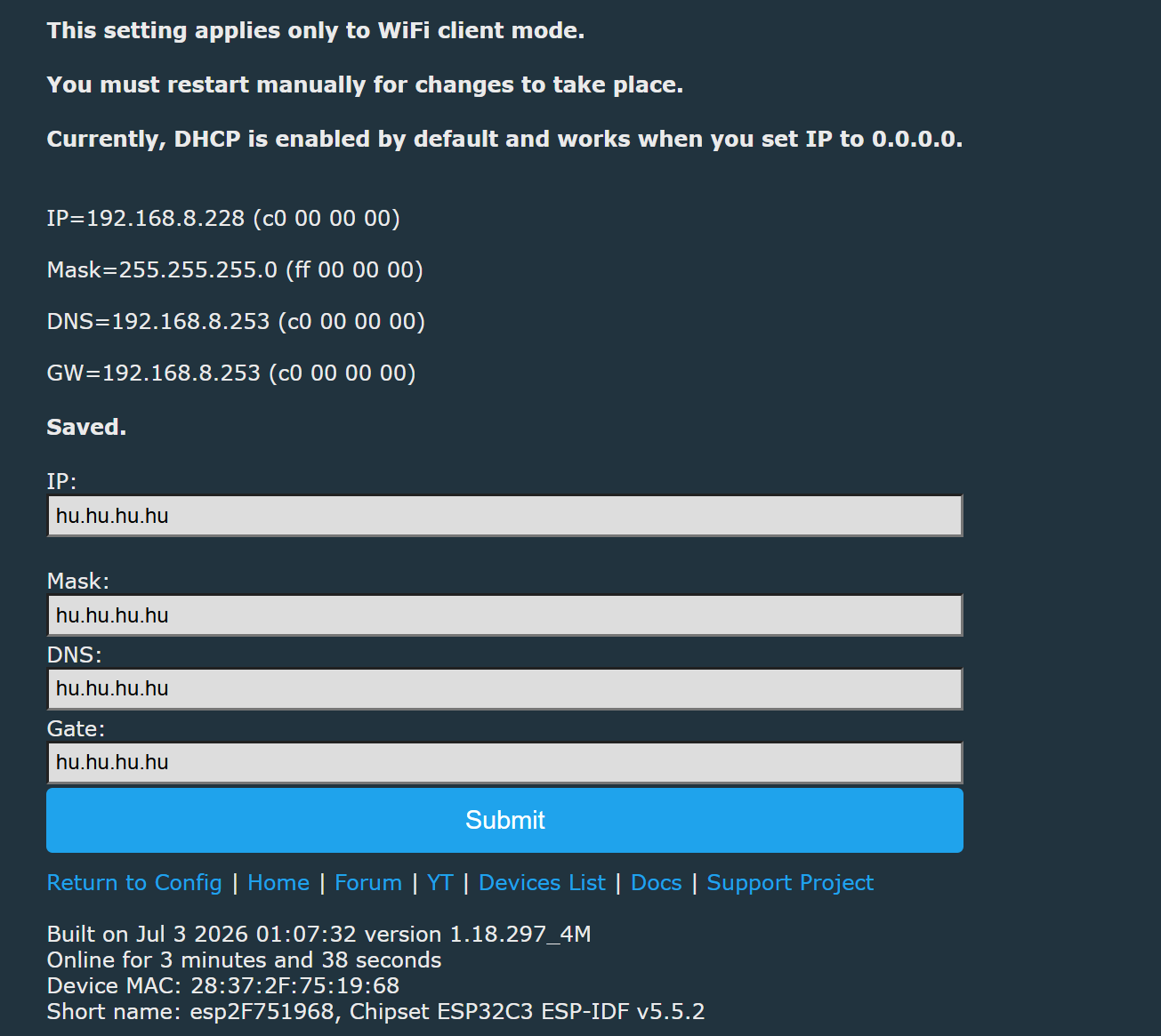

    Im struggling to set a static IP on the new port of the open becken for the ESP32.
    Using an ESP32-C3.
    IP is always assigned by the router via DHCP.
    Anyone having this issue?
    Here's some debug:

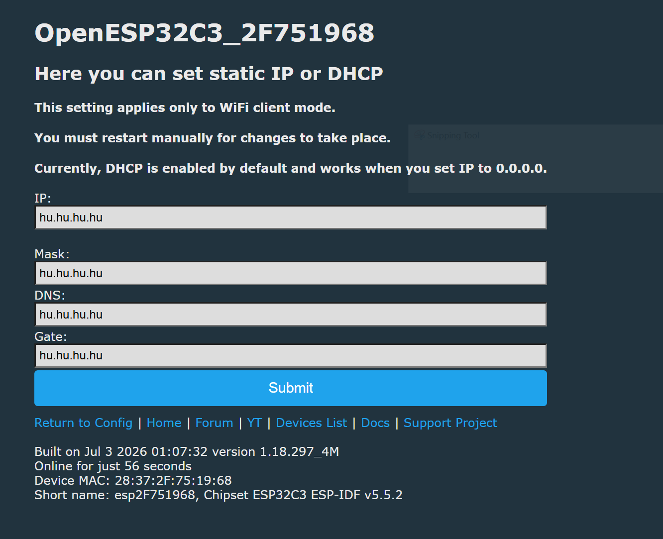

    flashed fresh factory firmware. Ap mode. Went to settings changed IP address, Wifi Settings Etc. Reboot.
    STatic IP ESP32 Port of OpenBecken
    The page shows strange values when it confirms the IP's
    Upon rebooting everything shows blank again, even after multiple attempts.
    OpenESP32C3 page for static IP or DHCP with fields for IP, mask, DNS, and gateway

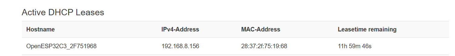

    Router:
