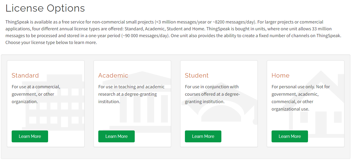

    Problem maybe trivial...
    How do I create an account on this platform if I don't have an email account associated with the university?
    Thingspeak. Setting up an account. Another platform with similar functionality.
    Can this be circumvented?
    Or what other platform should I choose?
    I want to obtain temperature graphs using ESP(8266, NODEMCU) and Arduino modules.

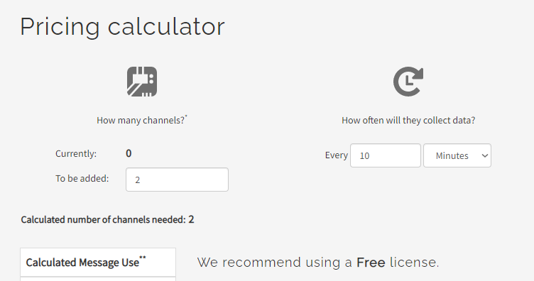

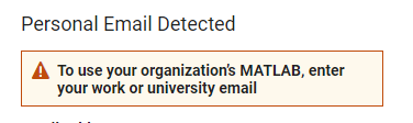

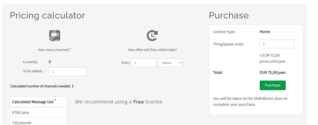

    Thank you for your reply.
    I don't know if I am wrong, because the HOME version is paid.
    I even selected updates every 1h....
    Do I make a mistake somewhere?
    Can I click with these 75 euro? Not very intuitive.
    Greetings.

    No.
    I created another account to see how it looks now. The accounts have been linked to mathworks and now it's actually on mathworks that they are set up to use thingspeak.
    After choosing to set up an account and entering my email I got a link to confirm it. There were a couple of attempts here, as sometimes it logged me in automatically to my old account, then after choosing to log in to thingspeak it tried to ask me for my password, which I had not provided. The third time I got a link where I entered a password and its confirmation, I logged in it mathworks.
    Message that I have no licence. I left there and went back to thingspeak.
    Now the login and password already worked, at this first login I selected personal from the selection options and created the first NEW channel. I can still create 3, so a total of 4, there are 3million messages left (device logs), this is the annual limit, the daily limit is 8219.
