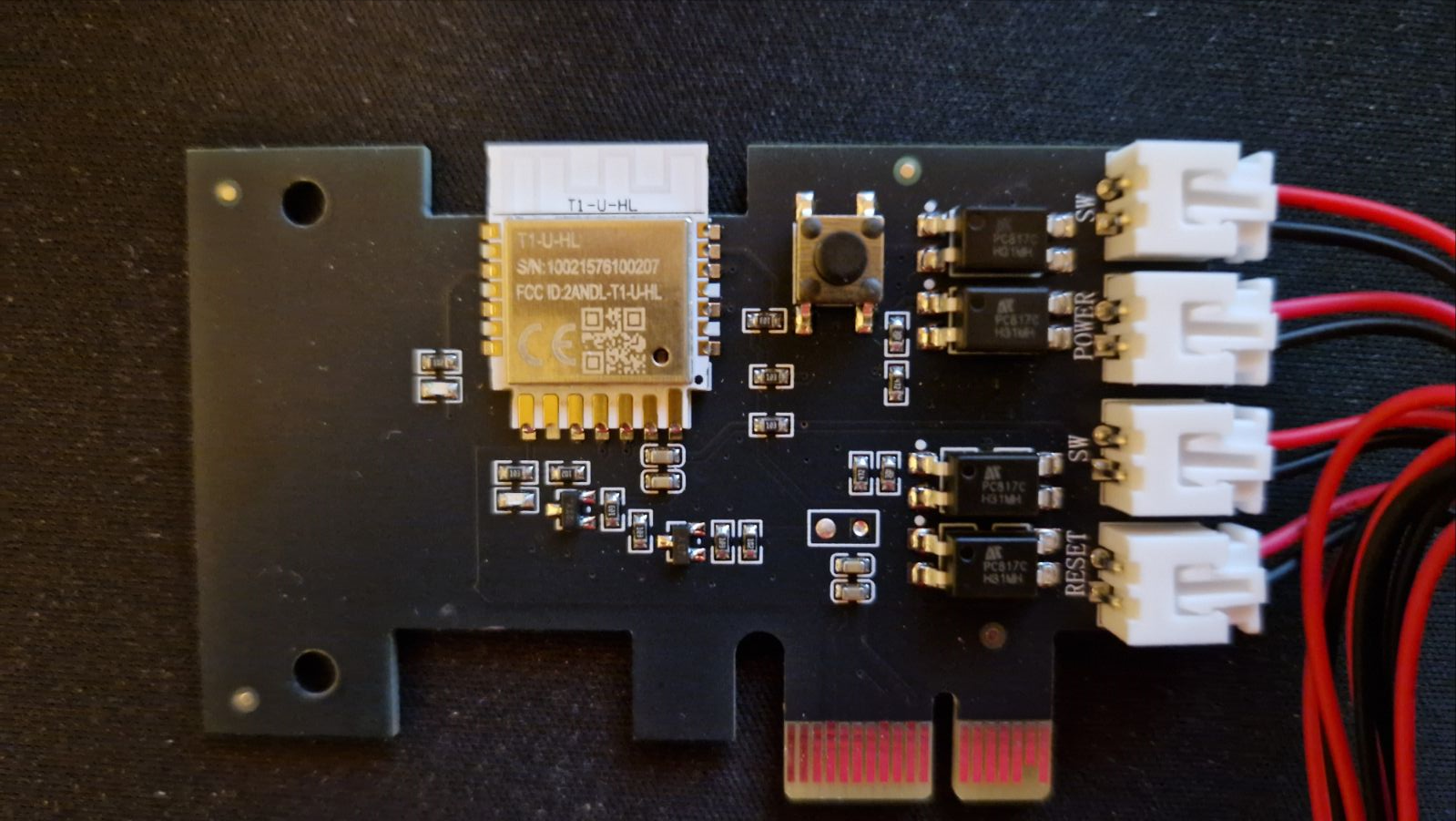

    The PCIe card shown here allows remote control of two buttons on a desktop computer – power and reset. It is available in two versions, Wi-Fi and Zigbee; here we will be looking at the former. The original buttons are completely bypassed, and the module offers two inputs and outputs isolated by optocouplers. This means it can provide a child lock function – preventing the computer from being switched on from the case. All of this is also available in the RF version, but we’ve opted for the Wi-Fi-only version – for just over $10:

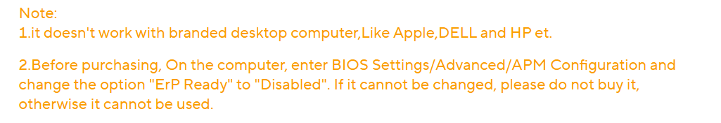

    The seller warns that the device does not work on branded computers and requires appropriate BIOS settings.

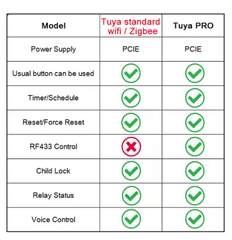

    The whole thing is also available in a PRO version with an additional radio remote control:

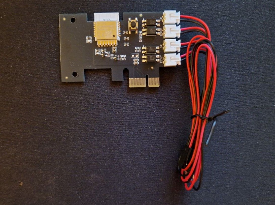

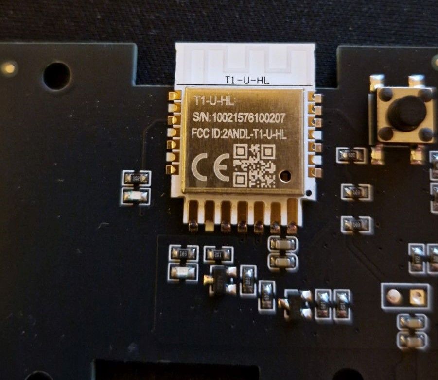

    Here’s a close-up of the board – there are four pairs of wires, two pairs are inputs and two are outputs. The device, with its factory settings, automatically pairs them; short-circuiting one input (where the button will be) causes a short-circuit in the output (where we’ll connect the motherboard):
    What was the Tuya Wi-Fi module doing inside the computer? Updating the PC Power Switch Remote firmwa What was the Tuya Wi-Fi module doing inside the computer? Updating the PC Power Switch Remote firmwa
    The whole thing used to be on a CBU module (BK7231N), but it’s now on the BK7238:
    A few words about the app are also in order. Tuya comes pre-installed, allowing you to control it for free from anywhere in the world. It also features a timer and integration with Google, Alexa and similar voice assistants.

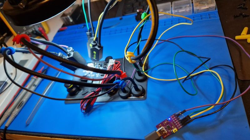

    Firmware update
    However, we wanted to experiment a bit more and flash our own firmware onto it. This is where you need to think carefully, because if you don’t have a server on the internet, there may be a problem with controlling it from behind your router, but this is normal for solutions such as Tasmota or ESPHome. Here, we’ll upload our multi-platform IoT firmware supporting as many as 32 platforms to the module.
    We’ve already shown the T1-U-HL pinouts on the forum: Data sheet for the T1, T1-M and T1-3S Tuya BK7238 modules, pinouts and flashing, Home Assistant

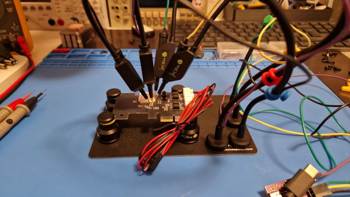

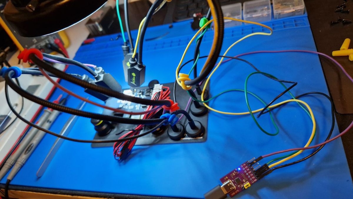

    You can change its firmware – all you need is a USB-to-UART converter:
    First, we burn the firmware using our Flasher, then we upload the OBK:

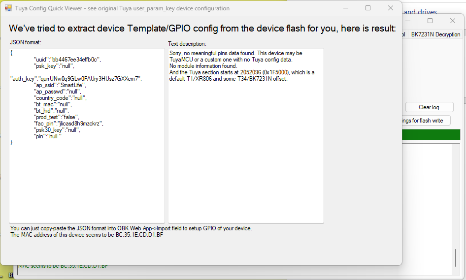

    However, the Flasher did not detect the GPIO this time:
    We determined the GPIO roles by tracing the paths:

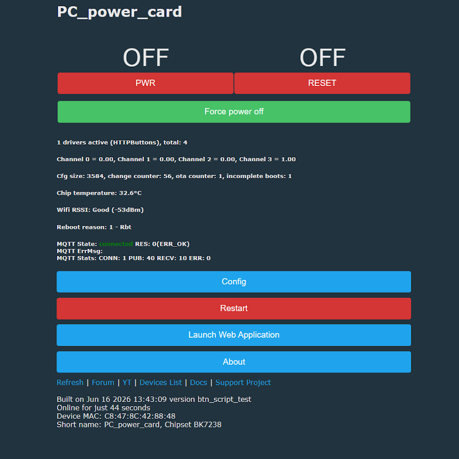

    Autoexec.bat allows the OBK to handle device events and add buttons to the main panel:
    alias force_power_off backlog setChannel 1 1; addRepeatingEvent 5 1 setChannel 1 0
    alias short_click backlog setChannel 1 1; addRepeatingEvent 1 1 setChannel 1 0
    startDriver httpButtons
    setButtonEnabled 0 1
    setButtonLabel 0 "Toggle Power"
    setButtonCommand 0 short_click
    [inContentAd]
    setButtonEnabled 1 1
    setButtonLabel 1 "Force POWER off"
    setButtonCommand 1 force_power_off
    SetChannelLabel 1 PWR
    SetChannelLabel 2 RESET
    SetChannelLabel 3 PWR_ON
    addEventHandler OnHold 21 force_power_off
    addEventHandler OnClick 21 short_click
    The script above:
    - sets the channel names
    - adds events that manually map a button click and a long press to a short and long relay closure respectively
    - adds buttons to the UI that trigger these events – these will then also be visible in Home Assistant

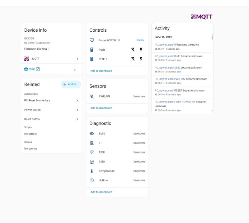

    Screenshot of a panel with a single scripted button:
    Similarly, you can add a RESET button (a second button and relay):

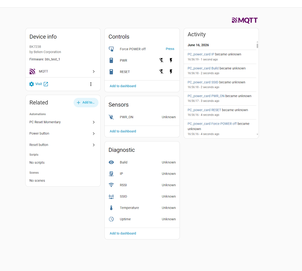

    Home Assistant dashboard showing PWR and RESET controls and an MQTT activity log
    This way, you can bring this module to life without the cloud. There is still the matter of the child lock – the remote lock. This can be added by including an additional condition check in the button and event handling via if :
    SetChannelLabel 10 "Child Lock"
    addEventHandler OnHold 21 if $CH10==1 then force_power_off
    Then, click events will only be triggered when we allow them to.

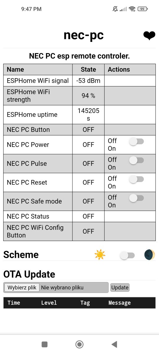

    Hetii
    Posts: 519
    Rate: 420
    I’ve modified a module like this https://devices.esphome.io/devices/sinilink-xy-wpce by flashing it with esphome.
    I also soldered a wire from the power connector to a free GPIO pin to confirm that the PC is switched on.
    Despite the thick sheet metal and the almost airtight casing, my ESP has no trouble connecting to the router.
    This is what it looks like at my place:
    Phone screenshot of “nec-pc” ESPHome panel with status table and PC control toggles

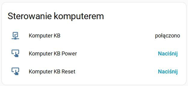

    Z2M allows you to create a new device definition. After some tweaking and with Claude’s help, I managed to define the device description for Z2M:
    Code: Javascript
    The definition had to be in fingerprint format, otherwise it would overwrite my original TS011F plug-in :) If anyone connects this device, they should check the manufacturer carefully. Mine is very strange: _TZ32981000000_rghq9fag. If it’s different, but the layout looks similar, you can change it to your own.
    It’s very easy to add your own device definition to Z2M. In the folder containing the Z2M configuration (the configuration.yaml file), create a directory called external_converters. Place the converter files in this directory. All you need to do is save the contents of the JavaScript code above as, for example, pcie.js and copy it into that directory. After restarting Z2M, the new definition will be visible. You can add it to the dashboard:
    “Computer control” panel with three entries: Computer KB, Power, Reset, and “Press” action links.
    There are two buttons: power and reset. I’ve also added a “PING” integration, which allows me to see whether the computer is running or not (whether it can be pinged).
