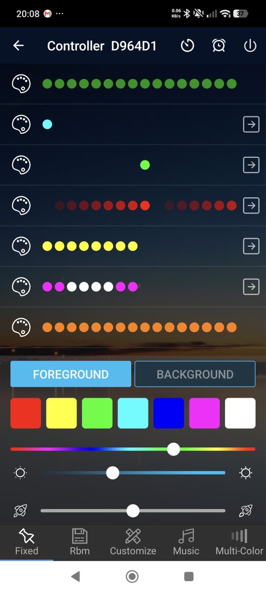

    The first drawback that strikes me is the lack of buttons on the LED controller itself. So you can either control it via the remote or via Wi-Fi. Instructions:
    How are colour LED hexagonal panels controlled via Wi-Fi constructed? Firmware update How are colour LED hexagonal panels controlled via Wi-Fi constructed? Firmware update
    The great thing is that you can ‘split’ the LED signal into several branches, as the instructions clearly demonstrate. They also mention pairing and the Magic Home app, which I decided to give a go.
    How are colour LED hexagonal panels controlled via Wi-Fi constructed? Firmware update How are colour LED hexagonal panels controlled via Wi-Fi constructed? Firmware update How are colour LED hexagonal panels controlled via Wi-Fi constructed? Firmware update How are colour LED hexagonal panels controlled via Wi-Fi constructed? Firmware update

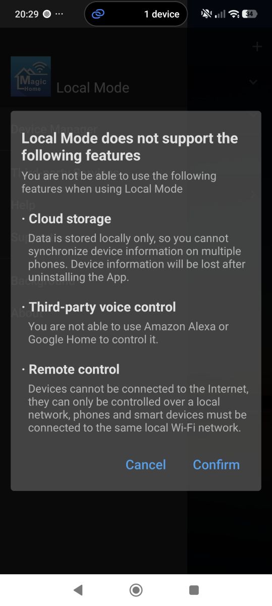

    Unfortunately, and rather strangely, even after switching on Bluetooth and the device being detected, I am unable to pair it with Wi-Fi. To be more precise – the device connects to my wireless network and appears in the DHCP list, but the app reports a pairing failure and no longer detects it. I’ve tried pairing it again by putting the controller back into configuration mode via several power cycles, but to no avail. Incidentally, the LEDs in pairing mode will display a slow colour animation:
    Discouraged by the pairing failure, I turned my attention to our Electrode firmware . It is uploaded via the USB-to-UART converter .

    (report):pixle config change
    (report):switch changed -> 23
    (report):light model changed 00 -> 25
    (report):light speed changed 0 -> 50
    (report):light rmode changed 50 -> 50
    ___________local report__________
    blufi report:(51){"code":0,"payload":"81A3232501320064000003000006"}

    paired OK for me
    Screenshot of an LED control app titled “Controller D964D1” with color palettes and sliders
  • #3 21927935
    Posts: 14814
    Rate: 12986
    Did you log in? Maybe I should have logged in first, but still, it supposedly works without an account...

    I appear to be in local mode. not logged in
    App screenshot showing a “Local Mode” popup listing unavailable features, with Cancel and Confirm buttons
