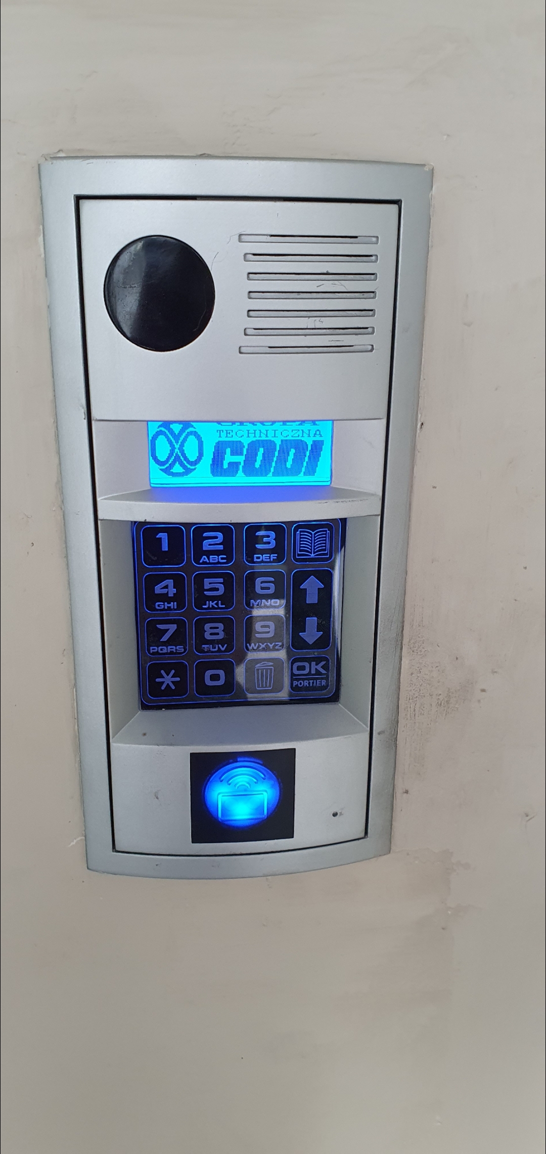

    Hello, I live in an apartment building and I would like to have a proximity key fob without entering the code. I had one in previous housing estates, even with the same model of intercom, but here there is no intercom. If it is possible? Do I have to have at least one to copy it, or is it possible to program it somehow without the original one?

  • #10 20108994
    Ircys
    Intercoms specialist
    Posts: 6969
    Help: 1342
    Rate: 2085
    air40 wrote:
    I don`t want to take it because the administrator has forbidden it,
    So I would ask the administrator, because this is at least a strange approach to the matter.
    For technical purposes: provide a photo of your panel with a proximity reader at the entrance door.
  • #11 20109241
    air40
    Level 4  
    Posts: 295
    Rate: 21
    Photo of the intercom

    #12 20109298
    WojtekRav
    Posts: 162
    Help: 29
    Rate: 64
    You can program the key fob yourself. Below are the instructions:
    After purchasing an additional RFID key fob/card, the tenant can independently enter it in the database in the external panel. To do this, take the following steps:
    - enter the apartment number on the external staircase panel
    - touch one of the arrow fields
    -enter the PIN code to enter the facility
    - the number of cards already entered at a given address of the premises will be provided (maximum 15)
    - present the new card (key fob) within a maximum of 4 seconds
    - if the card is not repeated (then "REFUSAL"), a save will be made.
    -after the system returns to rest, check the operation of the new card (key fob)

  • #13 20109315
    air40
    Level 4  
    Posts: 295
    Rate: 21
    Thanks, mate ! I will check it and let you know if it worked :)
