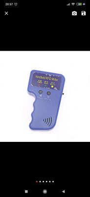

    Hello, I bought a Chinese pit and pit copying device but I don't want to put a signal on a new pit.
    I started to search the net and something I saw that there are different types of seeds, even though they look the same, that some can be overwritten others can't. So I guess I have some that can't be overwritten. Then what are they for?

    I have this device: Title: Copying 125khz RFID Intercom Pit: Issues with Chinese Device & Overwriting Different Types
    As I wrote, the old pit was read to me, but it does not want to apply to the new one.
    I guess then I must have non-programmable seeds. What are they for?
    I bought them on this auction:
    https://a.aliexpress.com/8Q09ZGL2b

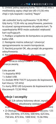

    You wrote that the tablet was an alarm. It doesn't matter much.
    After your additional answer, I checked the kit you bought and you didn't even read what was included.
    125MHz cards and 13.56Mhz key rings are listed as usual.
    That's why the card works and the key fob doesn't. These are two different systems.

    Part of an RFID copier manual, mobile website.
