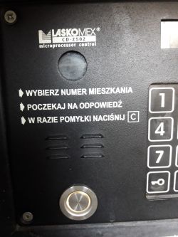

    Ok, I have this intercom: Adding a key fob to the Laskomex CD 2502 intercom without the installer code
  • #7 18662944
    ta_tar
    Posts: 6493
    Help: 699
    Rate: 2052
    The RFID keychain is usually read near the keyboard, and iButton keys (Dallas) have an appropriate socket on the panel housing to which the key plugs.
    You added a photo and you can see the nest there. Buy iButton key (Dallas).
    Unique key fobs do not fit this reader. Here you need a touch key (not proximity!) iButton.
    http://www.laskomex.pl/biblioteka/ Klucze-elektroniczne.php?z=6

    It looks like this panel DOES NOT have an RFID reader. There used to be hybrid panels with both Dallas and RFID, but we have not sold them for at least 2 years.

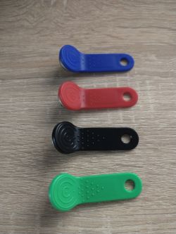

    Hello and welcome. Today I tried to save electronic keys based on your instructions. I entered the menu normally. I changed the ringtone volume and melody. Everything works. When trying to assign the iButton, I press button 8 - the ADD message appears - I place the iButton against the reader. Unfortunately, I do not receive any other message later (the manual states that the word NEU should appear). I applied the tablet for a dozen or so seconds. Maybe too short? Pressing 8 twice shows the inscription SCN (scan?), I also placed the tablet then but nothing changed.
    I have a Laskomex CD-2502 intercom
    I have DALLAS - iButton S0990 tablets

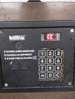

    I have such an intercom. Laskomex cd-2502.
    Adding a key fob to the Laskomex CD 2502 intercom without the installer code Adding a key fob to the Laskomex CD 2502 intercom without the installer code
    and these tablets were bought new, 4 pcs on a popular website on AL... I checked all 4 by touching the round reader to the ADD code - after about 30 sec the SCN message appears and then everything disappears and returns to the starting point.
    from the item description: Electronic Keys, IButtons DALLAS - "iButton S0990". Compatible with most DALLAS readers and system standards on the market used in combination locks, intercoms and video intercoms equipped with a DALLAS reader. Each lozenge has its own unique code printed on it, which can be entered into the memory of any Dallas system reader.
    Maybe I’m doing something wrong or the ability to add keys is blocked.
    And that`s where we should have started, rather than writing under other posts.
    As Col. Gkwiatkowski rightly pointed out: you have the wrong keys - you need RFID.
    Regards

    Thank you very much for your help and understanding. Today I checked the RFID keys and everything works as it should. Regards.

3-step: How to program an iButton?
  1. Enter user menu (see above).
  2. Press 8; “ADD” appears.
  3. Touch iButton firmly for 2 s until “NEU” blinks, then exit. Success rate exceeds 95 % with new keys [Elektroda, Serwis_LX, post #19795245]
