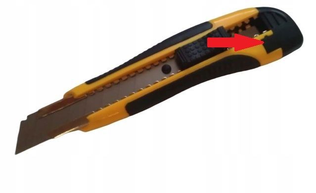

    Hello, I apologize in advance if this is in the wrong topic.
    The question is as in the description, I have such a knife and I have no idea how to recreate it to replace the blade. I assume it's not possible, but I'd rather ask. Replacing the blade in a wallpaper cutter - step by step instructions

    I just can't remove the tip, do you have any ideas on how to do it?

    There should be a latch on the black tip. You need to try to press/pry.
    Are all the blades broken off and you want to replace them?
    These strips on the blade are where they break off.

    As far as I can see, there is no latch.
    I just want to know if it can be removed and replaced.

    There is a latch and you either remove the black tip or, if not, you fold it away. All these knives have 100% replaceable blades

    Gently pry in the marked place: Replacing the blade in a wallpaper cutter - step by step instructions If it is also on the other side, you pry both latches at the same time.

    I just found it hard to believe that anyone could make such a pain in the ass system to open it. there were 3 latches

    Sometimes the black, removable tip had a notch for safely breaking the blade.
