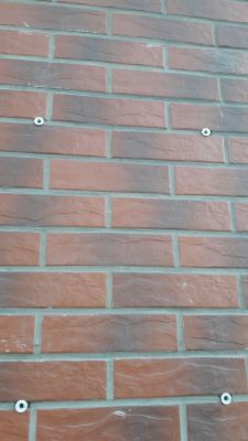

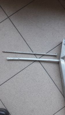

    I have a problem with removing the pegs from the wall. These are quite long pegs about 50 cm - they pull out while pulling out. Maybe someone has some other way to get this long plastic pin? I have to take out a few dozen ...
    Title: Removing 50cm Long Wall Dowels/Pegs: Tips & Tricks for Extracting Long Plastic Pins Title: Removing 50cm Long Wall Dowels/Pegs: Tips & Tricks for Extracting Long Plastic Pins

    I use a selected spax instead of the original screw, I screw a little bit and try to pull it out. It is good to choose it so that it winds a little tightly before it reaches the place where it swells.

    Virtually not removable, but can be removed by drilling it with a drill bit and covering the grout. Do you want to use the collection a second time?

    If it is laborious then it should be cut and that's about it.
    I thought there was some clever way.
    Thanks for the info.
    I will probably take a dremel from the inside of the peg and cut it ... and a fugue.
    Dremel and 50 cm questionable, but I do not forbid.
    At 1.5 cm from the front of the dowel, and the grout ...

    I screw the screw in a little and pull it out by the screw. When the screw itself comes out, I screw in a little harder and pull out the screw. You just have to pull hard.

    I twist the screw a little in the middle and pull out the screw. When the screw itself comes out, I screw in a little harder and pull out the screw. You just have to pull hard.
    I tried - I took one out after 10 minutes of jerking. :cry:

    And these are non-impact hammers? Because what could be useful here is a skein / inertial puller called ...

    With a slide hammer it will certainly tear too much. You just have to pull it evenly, not yank it. You take a piece of a thicker board, in the middle there is a hole that will pass the pin and the head of the screw you use, and pull it with the nail paw.

    I wonder about the length of the peg. Thermal insulation, any other layers for the dowel to do its job? May the removal of the pins inertia not be associated with the implementation of a new facade.
