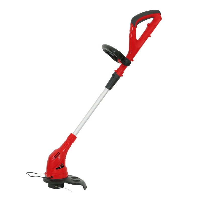

    I do not know how to replace the cutting head for the GRIZZLY ERT 450 electric trimmer
    any ideas ?. Procedure for Replacing GRIZZLY ERT 450 Electric Trimmer Cutting Head Procedure for Replacing GRIZZLY ERT 450 Electric Trimmer Cutting Head Procedure for Replacing GRIZZLY ERT 450 Electric Trimmer Cutting Head

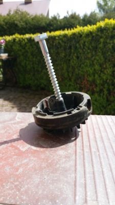

    I have a GARDENA EasyCut 400 trimmer.
    As a colleague "Krzysiek" wrote on the axis of the engine is the so-called a push-in Christmas tree.
    I changed my head as follows:
    In the center of the head there is a hole in which the spring is placed.
    After removing the spring, you can see the end of the motor shaft.
    In this hole I screw a wood screw with a diameter slightly larger than the diameter of the hole.
    The hole is 7mm in diameter. The screw has a M17 head.
    I screw in with the wrench holding the head until it comes off the axis.
    It looks like the picture.
    Regards.
