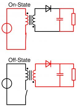

    1. Introduction
    Flyback converter is a buck-boost converter. It is one of the most popular topologies used to power devices with low power, has gained popularity thanks to its simple design and simple principle of operation. Many companies have added their solutions, improving some parameters; dynamic losses on the key were reduced, interference emission was removed from the optocoupler).
    The principle of operation is very well illustrated by Wikipedia, so I will quote it:
    Flyback power supply in Circuit Maker
    Fig. 1 Diagram of the flyback converter
    Fig. 2 Two operating states of the converter
    The schematic of the converter is shown in Fig. 1. It operates on the principle similar to the buck-boost converter with a separated choke creating a transformer. When a continuous stream of magnetic induction in the reactor is maintained (continuous operation), two operating states can be distinguished:
    - When the key is short (figure 2 at the top), the primary winding is connected to the voltage source. The current flowing through the primary winding and the magnetic flux in the core increases and the energy is stored in the transformer. The voltage on the secondary winding polarizes the diode. The output load is fed from the output capacitor.
    - When the key is open (figure 2 at the bottom), the magnetic flux in the core decreases. The voltage on the secondary winding polarizes the diode in the direction of conduction and the current of the secondary winding flows through this diode into the load and the capacitor.
    https://pl.wikipedia.org/wiki/Przekszta%C5%82tnik_flyback
    The schematic diagram is a simplified version that allows a better understanding of the principle of operation. The actual system is struggling with many problems that would not occur in an ideal arrangement, among others dynamic losses on the key, overvoltages on the primary winding, need for feedback or power supply for the controller. The following material is to bring closer the requirements regarding the power electronics equipment and problems related to PCB design. The material was created with the help of the user -RoMaN-, and the used controller is TNY280.

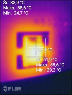

    3. Heat dissipation from elements (element dissipation power and heat sink)
    A common mistake in beginners is a misunderstanding of the power dissipation parameter on the element. This parameter is given for very good (in practically unachievable conditions) heat dissipation by the heat sink. In the case of TNY280, we have two PCB surfaces that act as a heat sink (thermal pad) (232 mm ^ 2 and 645 mm ^ 2) for which thermal resistances are given (analogously 70 degrees / W and 60 degrees / W). In my case, it is a little over 300 mm ^ 2 and I do not overload the system over what the manufacturer gave me. Additionally, it is worth remembering that the barrier diode on the secondary side also has quite a lot of power, so it is worth to have a larger thermal pad.
    It must be remembered that such thermal pads make it difficult to solder elements, because the power starts to dissipate on the heat sink, which makes it much harder to warm up the soldering point.
    Figure 20. Photo from a thermal imaging camera. All PCBs
    Figure 21. A picture from a thermal imaging camera. The diode on the secondary side.
