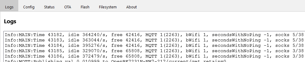

    On Firefox (107.0.1 64 bit) the Logs window appears like this without being able to resize/enlarge :
    OpenBK - Apps Page - Logs window does not show up correctly in FireFox
    It works fine on Chrome Browser.
    Any possibility to fix this?

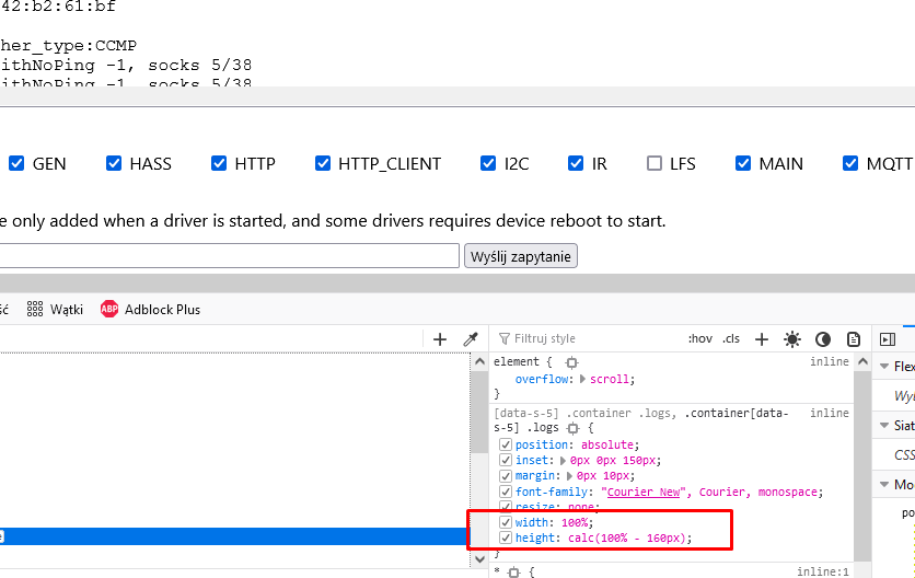

    Hey, thank you for reporting error. I have tested just now on Firefox and indeed there is a problem.
    I will try to look into it, but I don't know CSS too much.
    The problems seems related to this:
    https://stackoverflow.com/questions/15855951/how-to-fit-textarea-exactly-inside-a-div-css
    Ok ok, I am trying to resolve it, so far I have added that to CSS:
    I hope it won't break other browsers! Let me see...

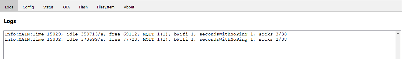

    I have pushed changes to the WebApp repository, can you check now? Of course clear browser cache first...
  • Scrollbar still renders outside the browser window
    #3 20319142
    jkwim
    Posts: 186
    Rate: 25
    Works great!
    Thanks for that quick fix.

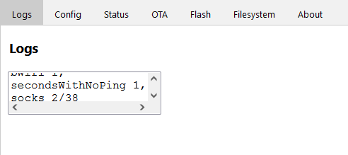

    Oh!
    I noticed that the vertical scroll bar is not within the browser. That is a minor issue for me for the time being.
    Please check that also when you have time.
  • #4 20319367
    Posts: 14797
    Rate: 12955
    Thank you for checking, I must have missed that.
    https://github.com/OpenBekenIOT/webapp/commit/f5281a037b9ab5d1d93f917c5797acd22eec6905
    Can you check now (on Firefox and maybe other browser as well)?

    That's good. CSS is not my thing but I figured it out.
