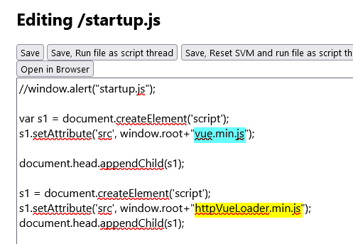

    Host following files in LittleFS:
    /startup.js
    /httpVueLoader.js
    /vue.min.js
    /logs.vue

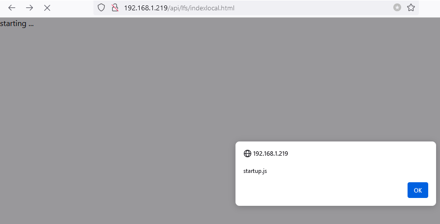

    Note that the paths within startup.js needs to be modified to access them within a single directory.
    var s1 = document.createElement('script');
    s1.setAttribute('src', window.root+"vue.min.js"); <================
    document.head.appendChild(s1);
    s1.setAttribute('src', window.root+"httpVueLoader.js"); <=============
    Also modify the path for the logs.vue and delete all other components:

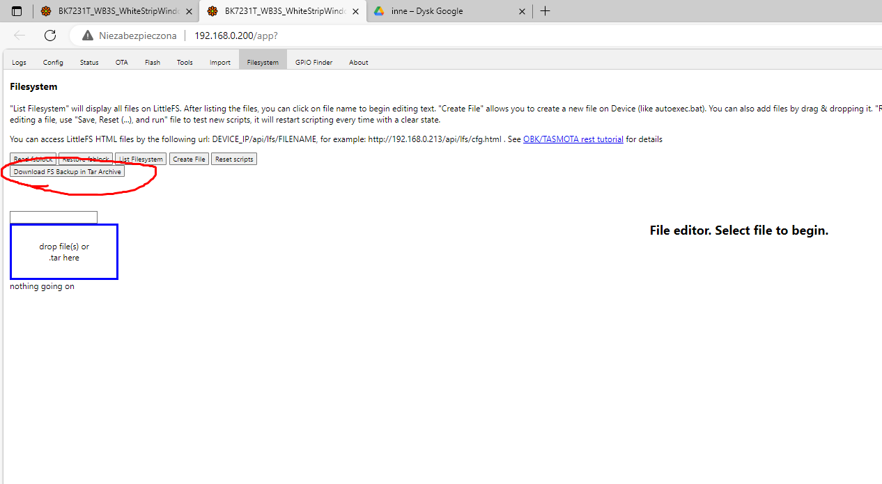

    You may get LittleFS being erased by OTA but it's not a problem, just keep a backup, you can easily download LFS backup here:
    User interface for managing LittleFS filesystem with backup download option highlighted.
    Use lfs_format to create LittleFS of required size, see our command docs:

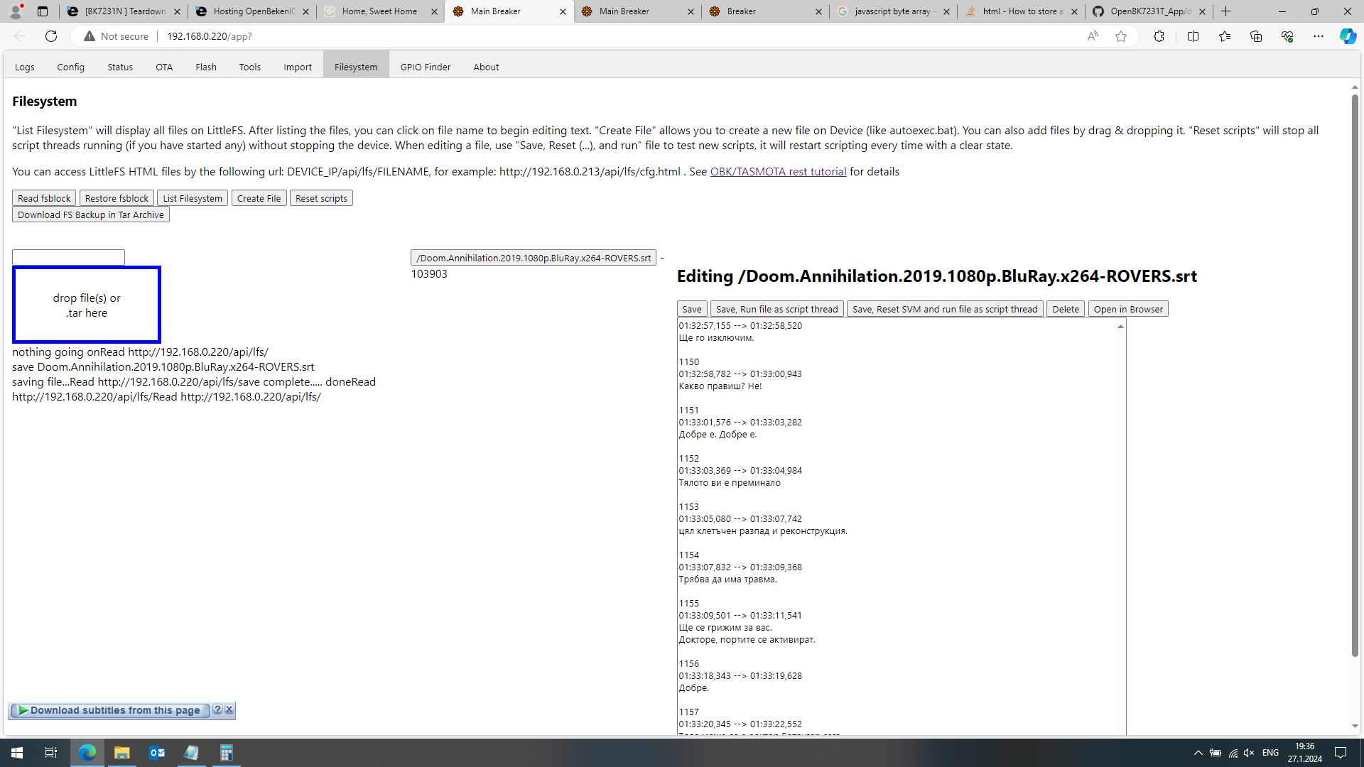

    EDIT:

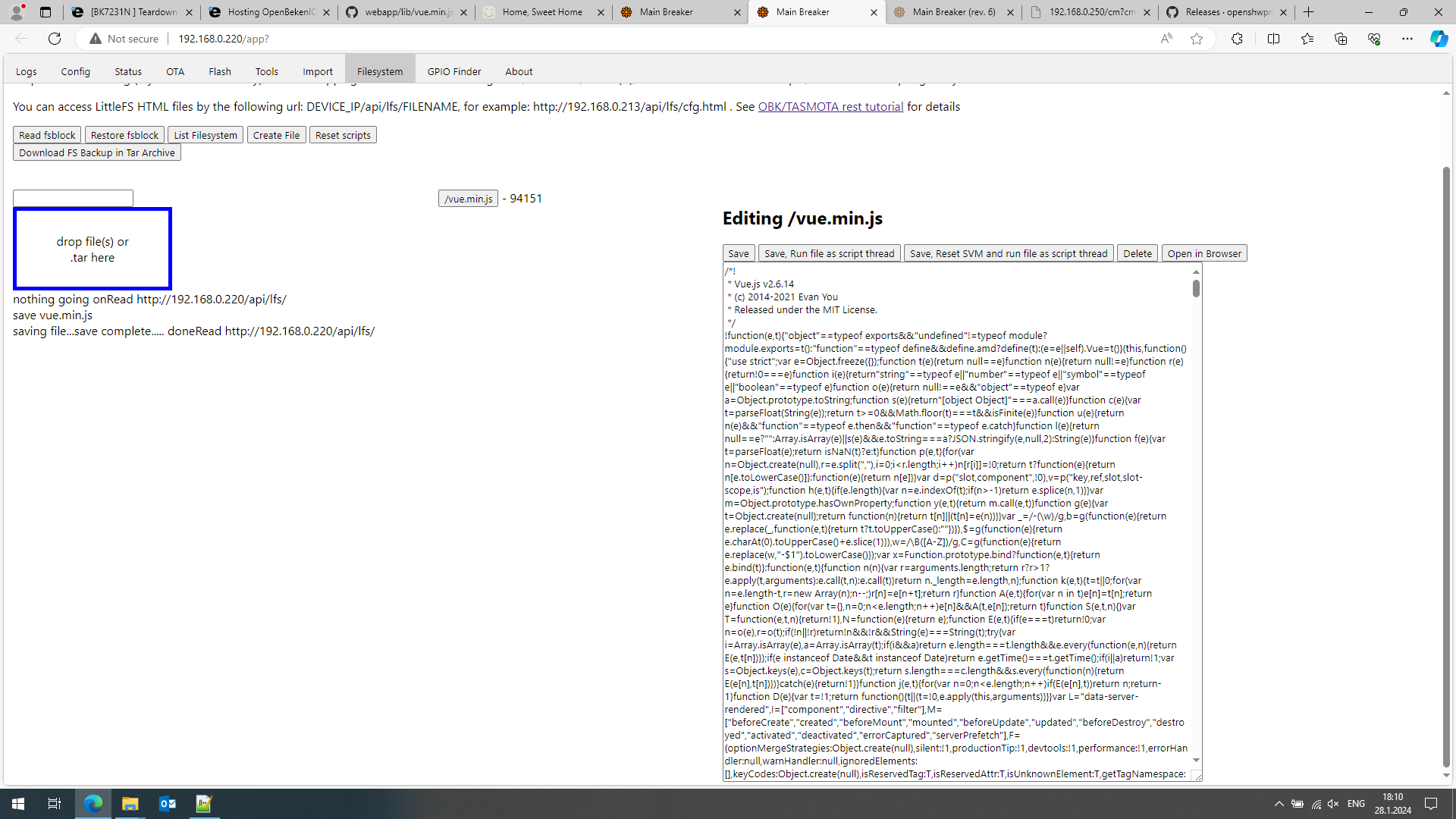

    I formatted lfs with lfs_format 0x32000
    Then I was able to copy file more than 100KB

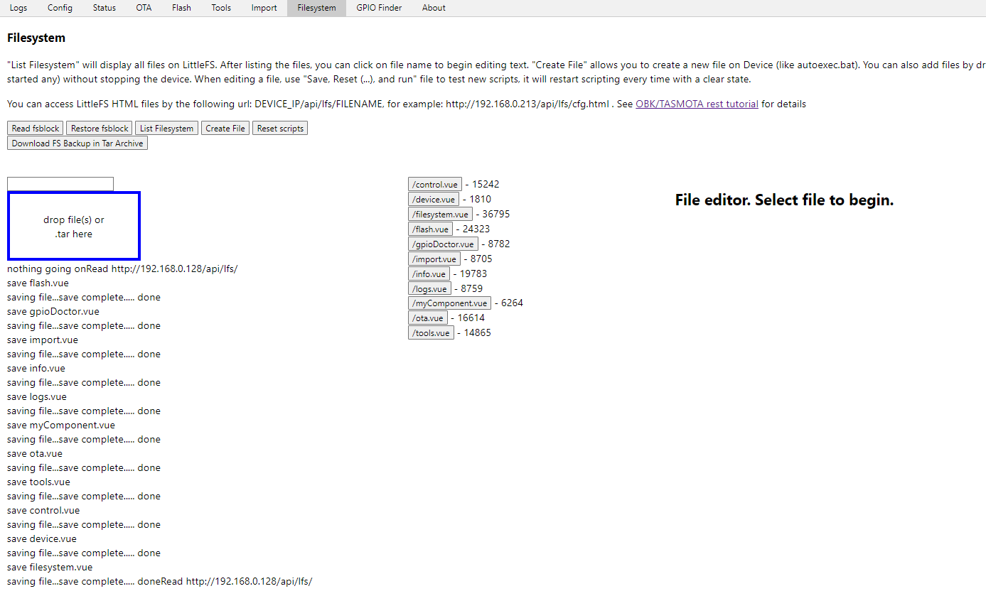

    Filesystem browsing interface in a web browser.
    Then I am able to copy more files:
    Screenshot of the OpenBeken interface with HTML file editing in the device's filesystem.
    As you can see files copied to LFS are 156k (exact as per occupation by block size of 4K) and about 147k real size, but still works. I copied the largest one first. It takes about 30-40 sec. to copy the largest file (very slow, but it works... at least by me).
    EDIT2: Can you finally post some more details about your device. It is possible your device to have less flash or some other peculiarities...

    @jkwim Tested and it looks like everything is okay:
    Software interface for managing LFS files via browser on BK7231T device.
    LFS formatted with lfs_format 0x32000
    The device is BK7231T, WBS3
    However, the firmware is 1.17.425. It's probably a good idea to upgrade the firmware.
    Added after 10 [minutes]:
    Hmm... Just tried with 256K fs
    I also noticed the following - after the tests yesterday, I performed an OTA update to clear everything. Of course, all files from LFS were wiped. I thought LFS was back to 32K, but now when I was doing the last format command, I noticed LFS was remembered as 0x40000, i.e. 256K. I didn't check LFS size before formatting though...
    Added after 11 [minutes]:
    @jkwim
    As you can see from the next screenshot, I am able to fill the whole 200K fs. File Breaker_rev4.html was the last one copied, but it is already beyond LFS size....
    Screenshot of a web application for managing LittleFS files.
    So, upgrade the firmware and format LFS with no more than 200K (0x32000) and try again - these are my recommendations

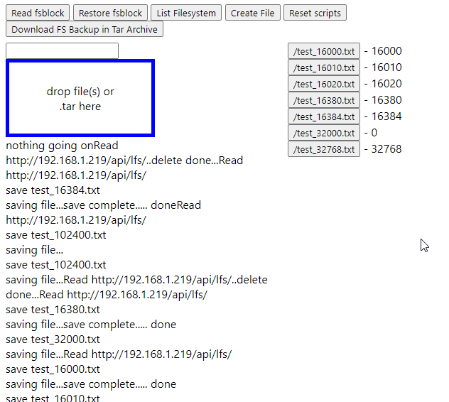

  • 32 kB uploads still reboot the device
    #13 20937919
    jkwim
    Posts: 186
    Rate: 25
    I was busy for the last few days and tried to revisit the issue using a different device.
    Upgraded the device to 1.17.404
    NO PROGRESS!
    Wonder what I may be doing wrong.
    1. Tried two different browsers, Firefox & Chrome
    2. Captured Wireshark trace and confirmed that HTTP request contains the entire file content. So I can eliminate any PC side issue.
    16kB size appears to be working consistently. 32kB size appears to be hit and miss.

    Screenshot of an application's interface with file management functions, such as file upload and file list.
    The only other option that I have is to change the wireless router (which I doubt will make any difference).

    1. I have tried opening blank file and pasting text
    2. I even tried pasting text incrementally to see where it fails. Around 17kB it fails
    3. Uploaded number of smaller files (max 16kB per file) and I can continue till about 100kB. I changed the partition size to 128k for this test.

    I've drag and dropped all WebApp files on LittleFS:
    File editor interface with a list of files in the LittleFS system.

    It looks like there is some problem with N devices. Whatever I do, I'm not able to copy vue.min.js on N device.
    Added after 3 [hours] 18 [minutes]:
    I was finally able to copy vue.min.js on N device, but with some little work around.
    I copied the file to T device and downloaded .tar file, then I dropped the tar file on N device and it works.
    Firmaware on N device - OpenBK7231N_delay_for_littlefs_ca445c8961ba
    Attached is corresponding tar file from T device
    @jkwim Please try with the attached tar file
    • vuemin.tar (100 KB) You must be logged in to download this attachment.

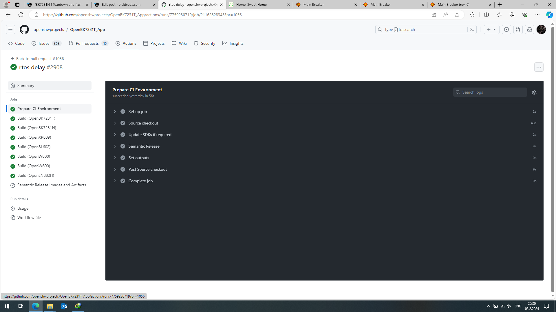

    https://pipelinesghubeus25.actions.githubusercontent.com/4Xw7PsXpqsl3BbjpdO8r7bfQ8DnPQoHACkdPhNFilyJSUGfp4T/_apis/pipelines/1/runs/2884/signedartifactscontent?artifactName=OpenBK7231T_App_1056_merge_ad333e21dec2&urlExpires=2024-02-03T18%3A26%3A42.6955336Z&urlSigningMethod=HMACV2&urlSignature=dA4JxryeFqPh9BABlZeomKGjl%2Bg4FjcF5la02yuaw00%3D

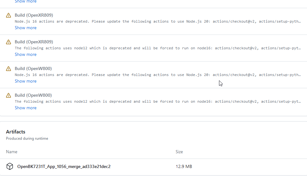

    In general - Follow the link p.kazcmarek2 sent. Then in the window "All checks are passed" click on any "Details"
    Then you should have this window:
    Screenshot from GitHub showing the activity page of the OpenBK7231T_App project.
    Click Summary, as indicated in the screenshot above then scroll to the end where you will find zip file with all builds. Download, extract and flash your device with correct rbl file

    Ok, I had to click on "Artifacts" to see this :
    Screenshot showing warning messages from OpenXR and OpenW about deprecated Node.js actions.

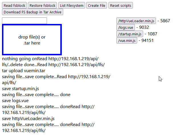

    SUCCESS!
    I was able to upload the following in to a 128kB FS in OpenBK7231N_1056_merge_ad333e21dec2 on a N (CB2S) device.
    However, I also encountered the issue with vue.min.js as with @Angel0fDeath. I used his tar file instead.
    Will test on all modules that I have WB3S, CB3S as well.
    User interface of a file upload tool with debug console
    Added after 1 [hours] 35 [minutes]:
    I uploaded following files with modifications made to the file paths as indicated in the first post in this topic.
    List of JavaScript and HTML files with their sizes in bytes.

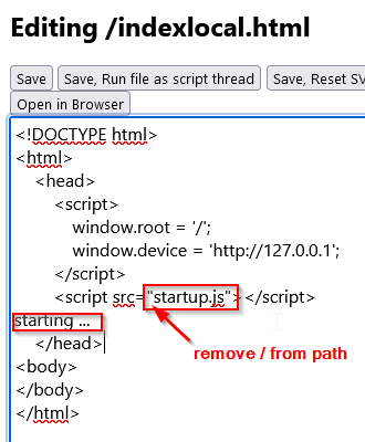

    <!DOCTYPE html>
    <html>
        <head>
            <script>
                window.root = '/';
                window.device = 'http://127.0.0.1';
            </script>
            <script src="/startup.js"></script>
    starting ...
        </head>
    <body>
    </body>
    </html>
    I accessed the page using:
    http://192.168.1.219/api/lfs/indexlocal.html
    I can see the test string that I have added in to indexlocal.html in browser:
    starting ...
    And nothing more.
    I used the original indexlocal.html file from WebApp.
    Wonder there is more changes required in the paths.
    Added after 2 [hours] 56 [minutes]:

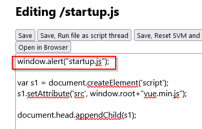

    Further, confirmed that startup.js is getting invoked by following modifications:
    Following files are in
    Screenshot showing the structure of JavaScript files in a browser along with the size of each file.
    Following components have been allowed in startup.js

    Screenshot of HTML file editing with code highlight and annotation.
    Screenshot showing the editing of the startup.js file with a highlighted code line
    Screenshot of a browser displaying a simple HTML page.

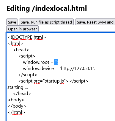

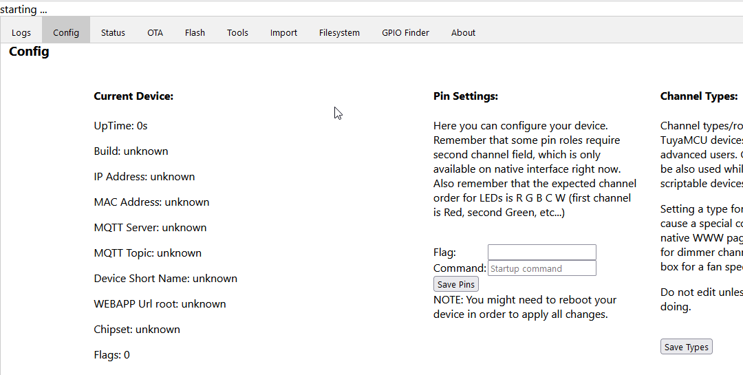

    Added after 26 [minutes]:
    Some further progress:
    By removing the '/' window.root I was able to get to the screen shown with no data nor links working:
    Device configuration with unknown settings and command input field.
    Screenshot of HTML file editing with source code.

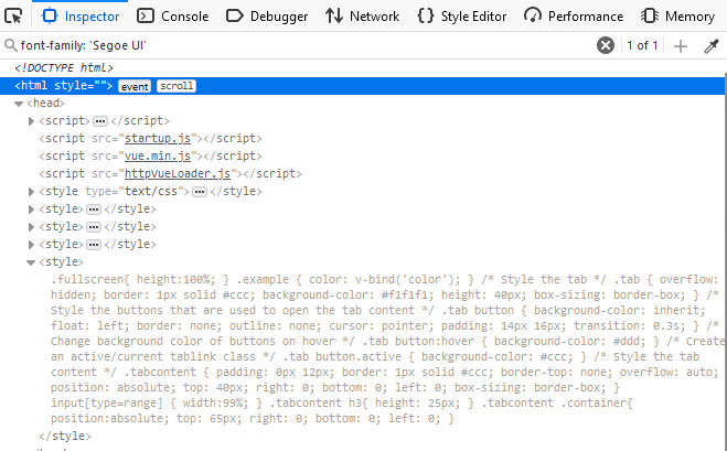

    Here is the debug window from browser
    Screenshot of a browser debugging tool showing loaded HTML, JavaScript, and CSS code.
    So looks like the javascript files are getting read.
    Now it is the matter of how to incorporate with the internal API

    4. Modified startup.js as follows (note the modified paths also):
    Screenshot of a code editor with an edited startup.js file, featuring a script to load vue.min.js and httpVueLoader.min.js files.
    Screenshot of a text editor showing JavaScript code for editing the /startup.js file.

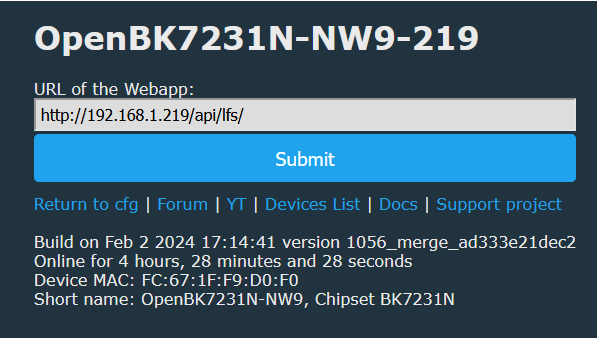

    6. Configured WebApp
    OpenBK7231N-NW9-219 configuration interface with entered URL.

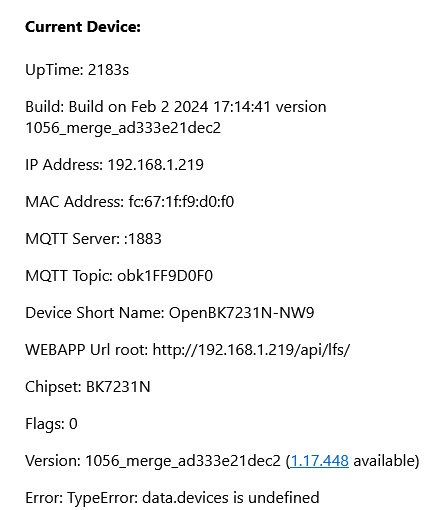

    7. Viola!
    Screenshot displaying information about the current device, including IP address, MAC address, and a TypeError.

    7. I named the minified files as .min.vue and modified the startup.js to reflect the same:
        window.components = [

    If anybody wants to test this here is a tar file with modified files. It is a zipped tar file.
    Ofcourse when the GitHub pages get updated you need to manually make the updates again.
    • LittleFS-196kB_OpenBK7231N_minified_vue.zip (48.32 KB) You must be logged in to download this attachment.

    Don't forget each file occupies 4K blocks, regardless of the size. So compare filesize of your min.vue files, calculate how much blocks file occupies and if there is no difference with the original file - don't minify this file. If there is a difference of at least 1 block (4K) - then minify it.
    For instance - info.min.vue is 12344 bytes (3.01 blocks which means 4 blocks), but it occupies 16K. If the original file occupies also 4 blocks - no minification is necessary.
