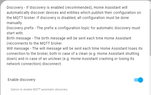

    Hi,
    I've started flashing my devices on OpenBK (ver. 1.17.405) but I've stopped at one place from which I can't quite get started.
    I've already set up a connection to Mosquitto broker (ver. 6.4.0) in HA (ver. 2023.12.4). De facto I have a message that the connection to the server has been established:
    Screenshot of MQTT status showing connection.
    Screenshot showing MQTT connection logs with Mosquitto server.
    However, still no MQTT does not show my device in the list - it is a BK7231N based bulb.

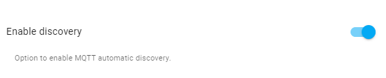

    Of course I have automatic search set up:
    Switch with MQTT automatic discovery option enabled.

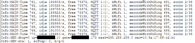

    I can see some communication:
    Screenshot of system log messages showing connection data related to MQTT and networking.
    Does anyone have any idea what is wrong with the configuration? I suspect it's some sort of configuration error or some oversight of mine - generally the unit works - colours etc work fine, it's visible on the network.

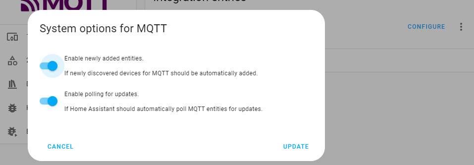

    Thanks for the reply, but it didn't help - perhaps I'm not clicking where I need to - if you can let me know if those are the two places you meant:
    Screenshot of Home Assistant configuration options for MQTT automatic discovery.
    Screenshot of system options for MQTT in Home Assistant.
    Previously I used the tutorial, which is posted on YT - despite several reboots, changes selecting Start Home Assistant Discovery and typing inSet/Change/Clear startup command line - scheduleHADiscovery 10, I still have the same situation. Do you have any idea what else to check/verify? I still see 15 devices in MQTT - which is the same as the initial state.
    Check whether OpenBK publishes Home Assistant discovery topics
    #4 20907889
    Posts: 14771
    Rate: 12914
    This is very strange. The next step in that case would be to suspect in Home Assistant in the log or in listening whether OBK publishes Discovery information when it is called. HASS Discovery works in such a way that when you call it then OBK on the appropriate subject should do a publish with a description of the device. You can also show the OBK configuration, although everything should be ok there.
    Example of HASS discovery below:
    Topic: homeassistant/light/WinTest_3145CAFF_light/config
    Payload: {"dev":{"ids":["WinTest_3145CAFF"],"name":"WT3145CAFF","sw":"Win_Test","mf":"Microsoft","mdl":"WIN32","cu":"http://127.0.0.1/index"},"name":"Light","~":"testRGBCW","avty_t":"~/connected","pl_on":"1","pl_off":"0","uniq_id":"WinTest_3145CAFF_light","qos":1,"rgb_cmd_tpl":"{{'#%02x%02x%02x0000'|format(red,green,blue)}}","rgb_val_tpl":"{{ value[0:2]|int(base=16) }},{{ value[2:4]|int(base=16) }},{{ value[4:6]|int(base=16) }}","rgb_stat_t":"~/led_basecolor_rgb/get","rgb_cmd_t":"cmnd/testRGBCW/led_basecolor_rgb","clr_temp_cmd_t":"cmnd/testRGBCW/led_temperature","clr_temp_stat_t":"~/led_temperature/get","min_mirs":"154","max_mirs":"500","stat_t":"~/led_enableAll/get","cmd_t":"cmnd/testRGBCW/led_enableAll","bri_stat_t":"~/led_dimmer/get","bri_cmd_t":"cmnd/testRGBCW/led_dimmer","bri_scl":100}
    You should see similar as you listen under topics starting with homeassistant/.
  • #5 20907973
    kamilm20
    Posts: 53
    Rate: 20
    Thanks for the tip - the cause was the Polish characters used in the name - by the letter "Ś" in Topic - that's why it wasn't letting me go. Thanks for your help!
