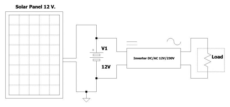

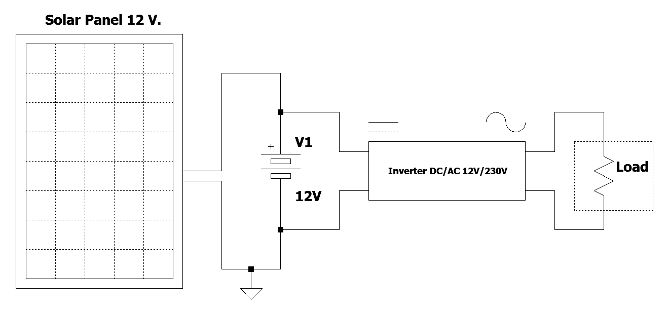

    Circuit formed by solar panel, battery, inverter, and load
    To fully understand the functionality of the charge controller, let us first examine a simple, low-power photovoltaic system consisting of the following components:
    • a 12 V solar panel;
    • a 12 V battery;
    • an inverter (DC-AC 12 V to 230 V);
    • a load.
    At the moment, it is not essential to know the amount of current circulating in the circuit. What is important is to understand the basic concept. As can be seen from the diagram in Figure 1, the components are connected to each other using a general solution, which is widely used by users with a low to medium level of knowledge of electronics. The realization of such a solution is, however, not advisable at a stable, professional, and lasting level, as the system encounters many problems in its normal use. Let us now examine the two states of operation, i.e., the charging state of the battery (in the morning, in the presence of the sun) and the discharging state (in the evening, when the battery supplies the load but is not charged by the solar panel):
    • In the morning, when the sun is shining, the solar panel generates a voltage that is certainly higher than that of the battery. The current therefore flows through the circuit and recharges the battery itself. Its voltage, of course, starts to increase more and more, but there is no control over either the amount of current delivered by the panel, or the voltage reached by the battery. If the light hitting the panel is excessive, the battery could even be damaged by overvoltage, overcurrent, or excessive temperature. In other words, there is no control over the charging mode, and for a good automated system, this is simply not acceptable. Furthermore, the cost of batteries (especially lithium batteries) is very high, so the user cannot allow a crude circuit, without any control system, to charge batteries in this simple but dangerous mode;
    • In the evening, the solar panel produces no current, and its voltage is very close to 0 V. The battery voltage is much higher than that of the panel (usually 12.6 V), so most of the energy regularly feeds the inverter, but a significant fraction of it flows back through the solar panel. In some cases, the latter may be damaged.
    The importance of a charge controller in a photovoltaic system
    Figure 1: Functional but non-functional schematic of a small solar system

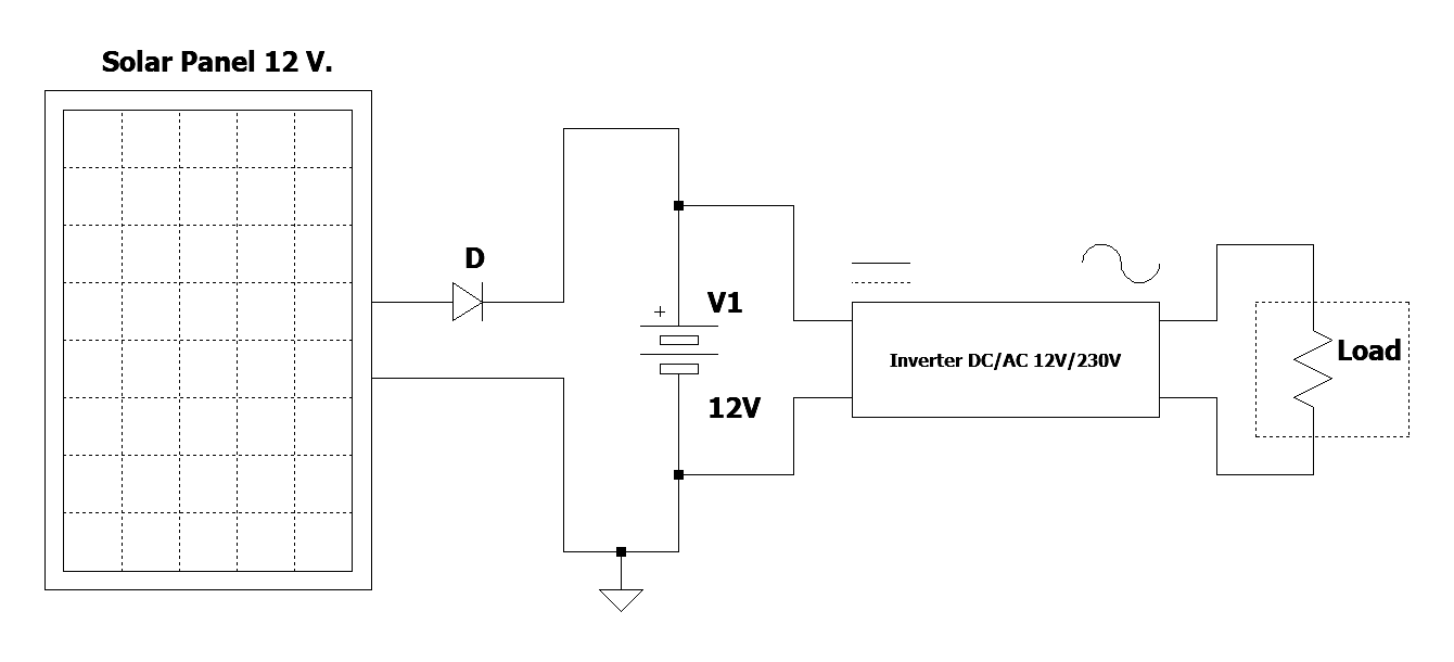

    Circuit consisting of a solar panel, battery, inverter, load, and blocking diode
    A first solution to the problem is to prevent current from flowing backwards by adopting a blocking diode, which can allow energy to flow from the solar panel to the battery but not vice versa. The diode to be used must withstand a current greater than that flowing through the battery during charging. Unfortunately, the diode is known to produce a voltage drop at its ends of about 0.6 V, so the voltage of the solar panel would be decreased by this factor, which is sometimes unacceptable. To remedy the problem, power Schottky diodes can be used, which offer a much smaller voltage drop. Figure 2 shows the principle diagram of a small solar system using a blocking diode connected between the solar panel and the battery. The solution of using the diode solves the problem of current return to the solar panel, especially at night or in very low external light conditions. However, the problem of charge control, both within the voltage and current limits, is not solved. This solution therefore only safeguards the integrity of the solar panel but not that of the battery.
    Figure 2: Using a diode to block the night-time current from the battery to the solar panel

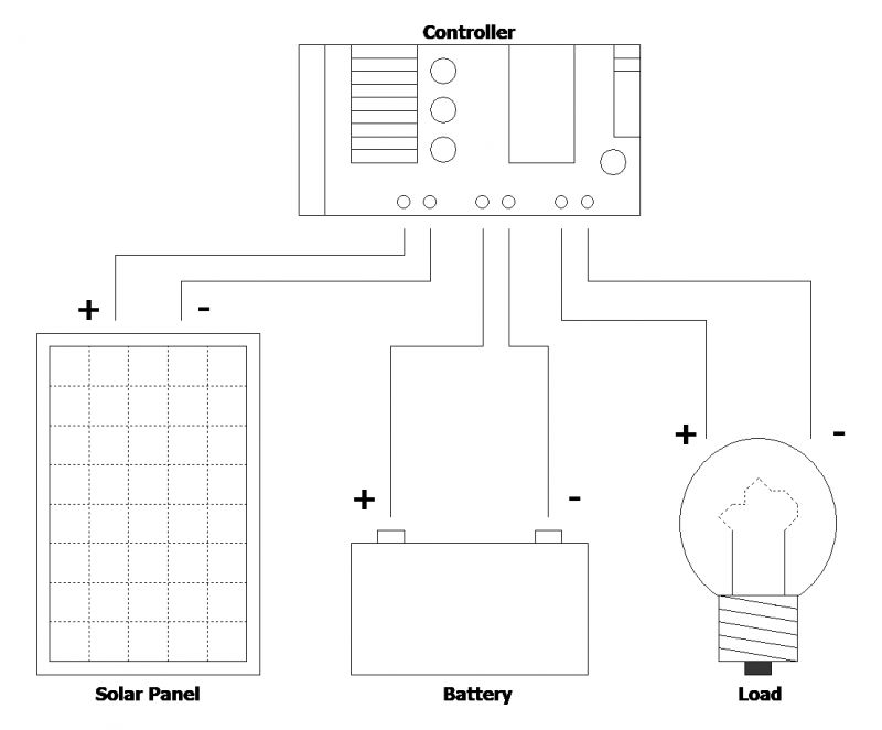

    As can be seen, therefore, the work performed by the charge controller is extremely important, and it performs, in a fully automatic manner, many valuable functions that secure the various electronic components of the entire system. In this way, the user can also sleep soundly. Figure 3 shows the general wiring diagram with the four basic components, namely the charge controller, the solar panel, the battery, and, of course, the load(s). Respecting the correct polarities, the connections to be made are as follows:
    • The solar panel is connected to the input of the charge controller, obviously respecting the maximum permitted voltages;
    • The battery is connected to the central terminals of the charge controller;
    • The load is connected to the output of the charge controller, respecting, of course, the maximum permissible voltages.
    Note that loads can operate in direct current, e.g., at voltages of 12 V or 24 V. The load could also consist of an inverter (DC-AC) that converts the 12 V or 24 V DC voltage into 230 V or 115 V AC voltage. To avoid possible damage to the devices, the correct polarity of the connections between the devices must be strictly observed. Furthermore, the voltage of the solar panel must not exceed the maximum voltage tolerated by the charge controller, otherwise it may be damaged. Charge controllers in all market ranges have light indicators or LCD displays to show the information from the battery analysis. Thus, the user could read, for example, the regulator's current mode of operation (battery charging or discharging), the instantaneous voltage of the battery itself, and any messages or various warning indications.
    Figure 3: The generic connection diagram between the charge controller, the photovoltaic panel, the battery, and the load

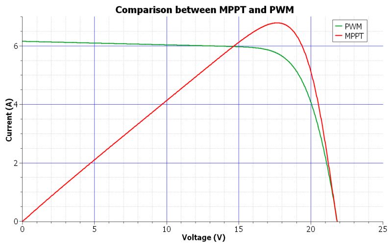

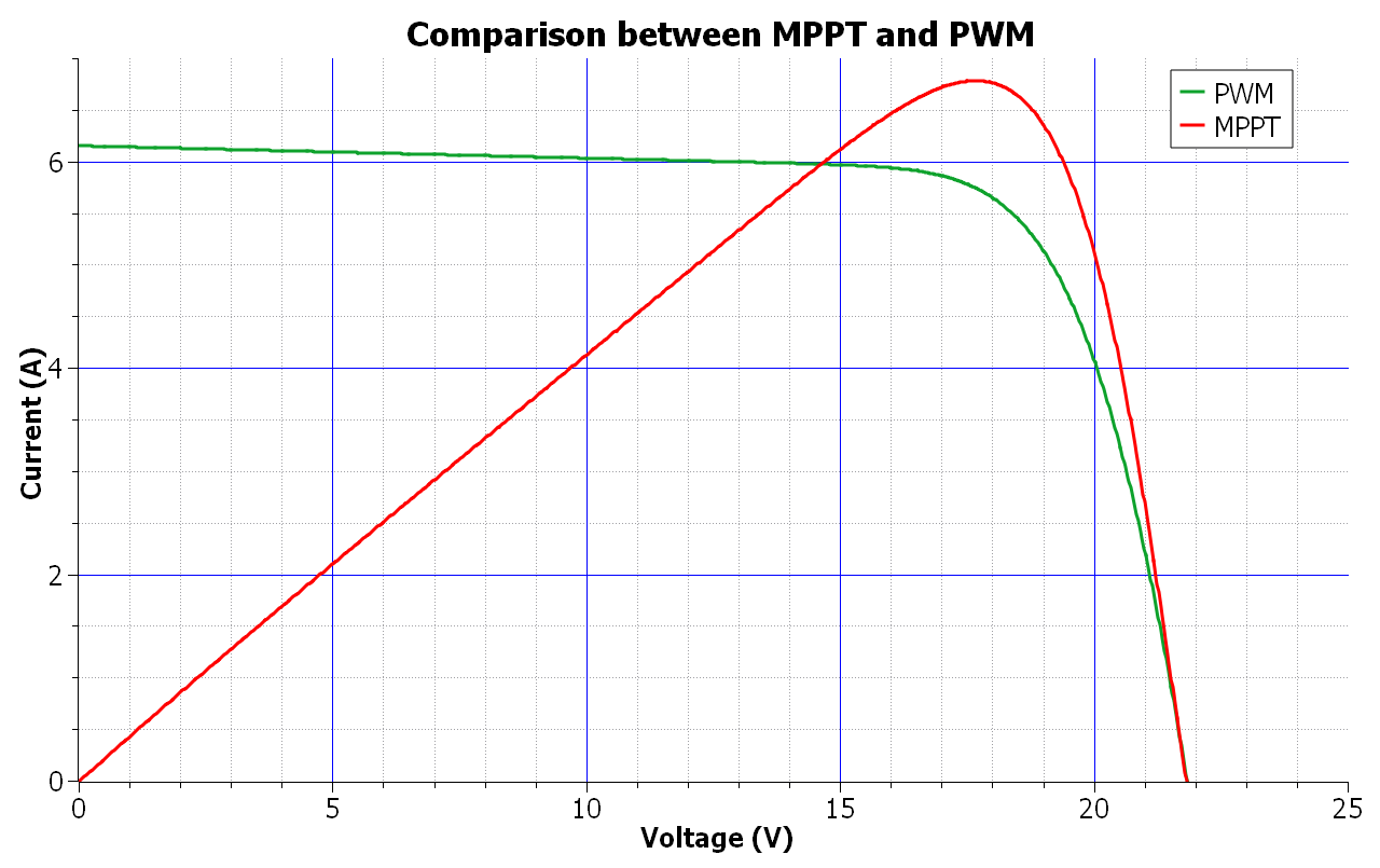

    PWM and MPPT charge controllers
    Both charge controller technologies can be used to charge batteries using energy produced by solar panels. The PWM controller is a switch that connects the solar panels to the battery. It reduces the voltage of the panels to the level of the batteries. The MPPT controller, on the other hand, is more sophisticated and expensive and always uses a microcontroller. It adjusts its input voltage in order to collect the maximum possible power from the solar panels and, therefore, transform the energy to return it to the optimum level for the battery. The graph shown in Figure 4 shows the course of the current in relation to the voltage.
    Figure 4: Generic comparison between a PWM controller and an MPPT controller
