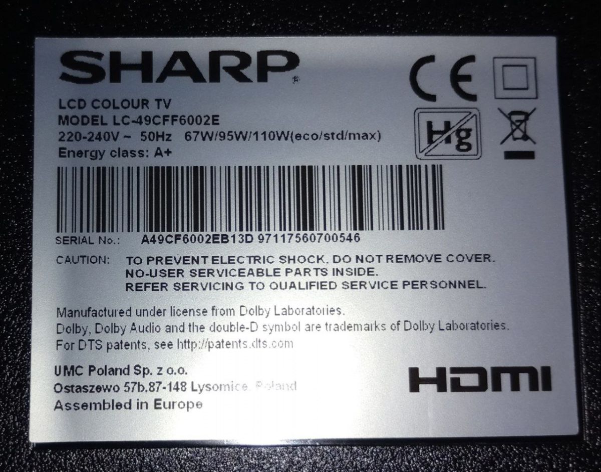

    servicesse
    Can someone help me with the latest firmware for my Sharp LC-49CFF6002E? (Model year 2016)
    Serial: A49CF6002EB13D97117560700546
    The issue: in settings it showed that "Update is available". I clicked "Update via Network". Wi-Fi was connected, so the Internet was working; no power outages. It asked for a USB stick, I plugged in an empty FAT32 USB stick. It downloaded SW; a progress bar was shown on the display. Then it turned off and never turned on.
    I have checked the files on the USB stick, and it was empty. So now I think it's trying to load the firmware file from the USB. That's why I am looking for this file.
    Current states:
    1. When I turn on TV with everything unplugged: the TV LED is blinking/flashing with RED for 1 second and BLUE for 1 second. Or maybe a bit less than 1 second, super quick. It's a loop; it doesn't stop blinking.
    2. When the USB stick is plugged in: the TV LED is blinking/flashing with RED for 3 seconds and BLUE for 3 seconds. Slow blinking. It's a loop as well; it doesn't stop.
    I was able to find a firmware Sharp+LC-4...F6002E.rar (105.98 MB)You must be logged in to download this attachment. file (SW name inside allupgrade_6308rtbm.bin) on the other forum, but it's not working; so I assume it is the wrong file, or the wrong firmware version.
    Also, I found a PDF sharp_lc-4...02e_sm.pdf (9.66 MB)You must be logged in to download this attachment. with documentation for this model, in case anyone needs it, or it will help experts to fix my issue
    Huge thank you!

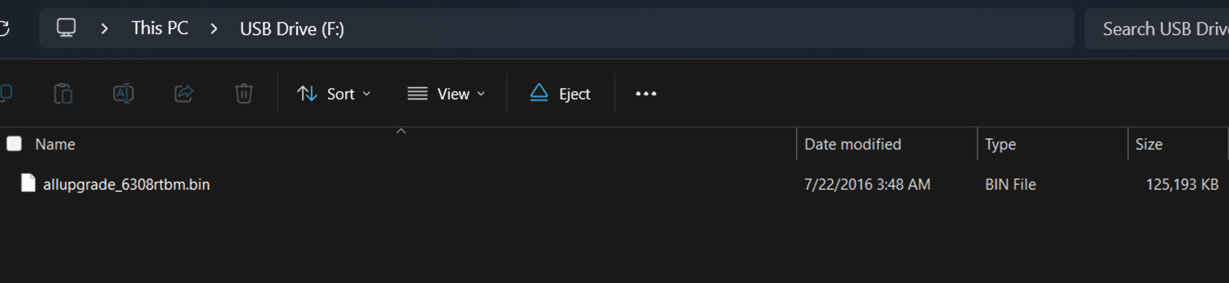

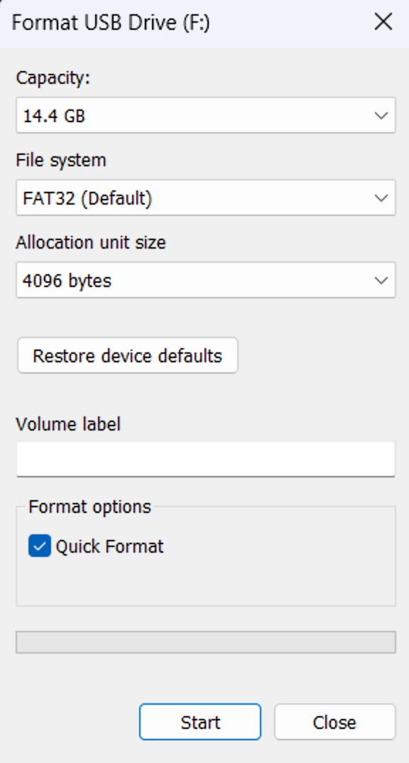

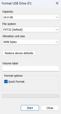

    #3 21750213
    servicesse
    >>21750182
    Hi billobirillo,
    0. I have downloaded the new file you provided.
    1. A 16 GB Kingston USB stick formatted under Windows 11 to FAT32. Copied one file, allupgrade_6308rtbm.bin, to the USB drive.
    2. Disconnect the power cord from AC mains for 10 seconds (until the standby LED has extinguished).
    3. Insert the USB stick into the USB port on the rear/side of the TV.
    4. Reconnect the power cord to AC mains while pressing the standby button on the TV.
    TV behaviour after step 4:
    Red indicator on start, then blue for 3 seconds, then red for 3 seconds, and in a loop again and again. From what I see it's supposed to be blue for some time, more than 3 seconds
    New test
    1. I unplugged the USB and disconnected the power plug:
    2. I connected the power plug to the TV with no USB connected:
    3. In this case I see blue for 3 seconds, then red for 1 second, then blue for 1 second, and then it's just blinking 1 second red 1 second blue.
    Opinion:
    From this I see that maybe it's trying to read something from the USB, since the LED gives different signals if USB is connected.
    Maybe there are other ideas about what I am doing wrong?
    Format USB Drive (F window with FAT32 file system and Quick Format enabled
    Screenshot of USB drive folder with file allupgrade_6308rtbm.bin

    #5 21750226
    servicesse
    >>21750218
    OK, trying with 4 GB stick
    This TV has no power button on it, but it has STANDBY button like in your instruction above. Usually this TV has a red LED indicator after the power cord is connected.
    Added after 1 [hours] 9 [minutes]:
    >>21750218
    A 4 GB stick is a pretty rare thing, so it will take a few days for me to find it. I'll reply after tests
    Many thanks!
    Added after 1 [hours] 21 [minutes]:
    >>21750218
    I have some good news. Many thanks billobirillo for being with me on this journey.
    TV works fine. Long story short: USB stick must be MBR and not GPT
    Nice suggestions to add to the general instruction or whomever you will help next.
    I think this applies to all old TVs and must be confirmed for all old TVs.
    I used USB stick 16 GB, but I used Gparted linux software to change partition table from GPT to good old MBR. After that I created only one partition with 1GB, rest was free. I think this way for a TV it was good enough.
    The rest was exactly like in your instruction.
