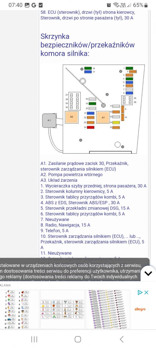

    Will someone throw a photo showing the diagram, where the relay from the secondary air pump, Seat Leon II should be located?

    Diagram of fuse/relay box in the engine compartment for the Seat Leon 2 1.6 MPI model.
    Seat leon 2 1.6 mpi A2 relay, the same as in Altea

    >>20844878 .
    Thank you, good man :)
