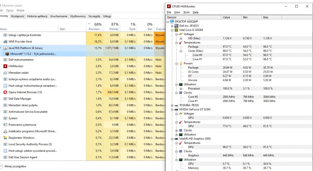

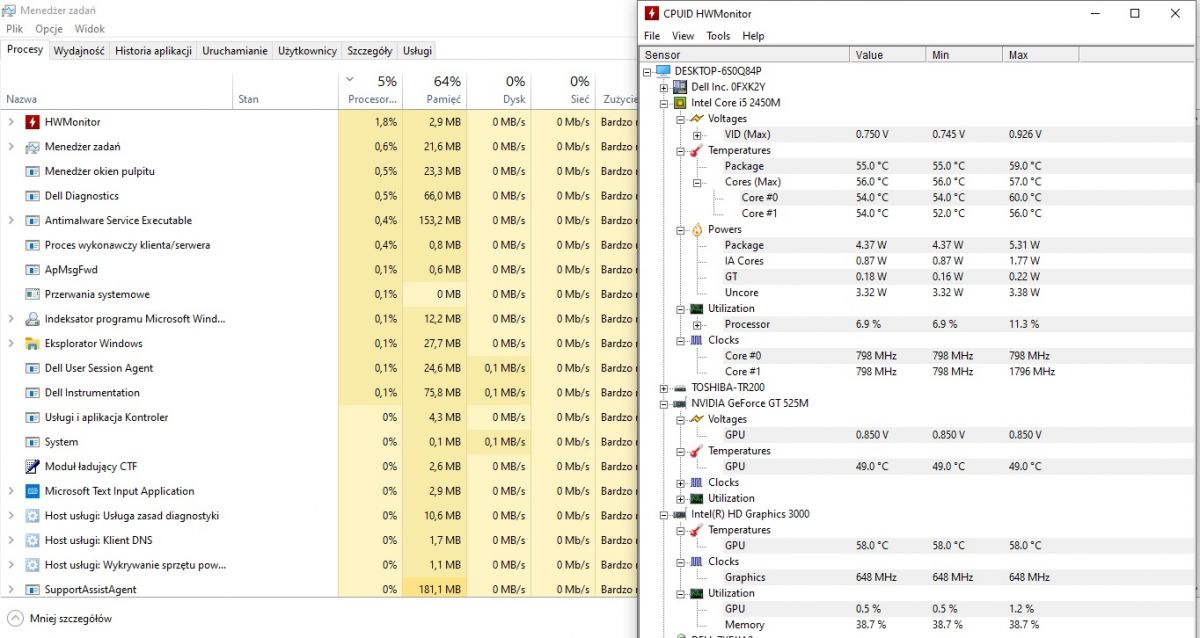

    Hello. First, I should start with the hardware configuration I guess :) Windows is tenth, 4Gb RAM, the rest as in the attached picture. The battery is basically dead, although it shows 100% so grandpa is running on the power adapter. When unplugged, it crashes like a landline :)
    If it works, I'll make a new one for it.
    Dell N5110 Laptop Overheating & Fan Constantly Running: Causes & Solutions (Max 90 chars)
    This screenshot is taken calmly, without load. And now, turning on anything, e.g. Opera, the load increases to the max, crashes, loads for a good half a minute and then returns to normal.
    I changed the power plan to balanced, because the processor was clocked at max, now it changes the frequency smoothly. Unfortunately, when you turn on any game (Minecraft here), everything immediately increases to the max, the fan almost jumps out of the housing and the temperature is still 95-98 degrees.

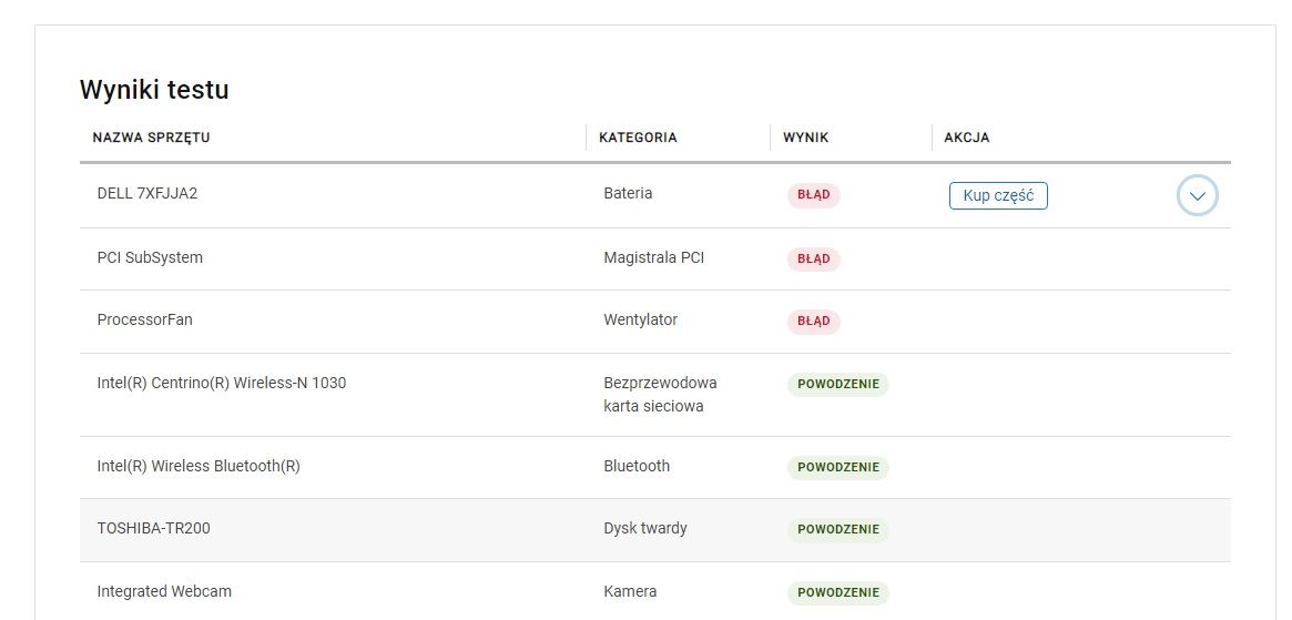

    One more thing. Yesterday I also did a quick diagnosis on the Dell website and here's what came out:
    While the battery is dead and counterfeit and the fan in the next full test was ok, I'm wondering about the PCI bus error.

    Looking at the temperatures and the size of the load at a given moment, the cooling system is clearly not working. The temperature rises, the processor slows down, protecting it from complete destruction, hence the hangs probably.
    If, as you wrote, you change the paste regularly and the fan runs at high speed, there is still insufficient contact between the processor and the heat sink / cooling system.

    Looks like you're right. I measured the temperatures on the heat pipe at the processor and at the fan outlet. They are basically the same. But as the hw monitor shows 80 degrees on the processor, the meters on the heat pipe and fan show max 45. So you probably have to take care of putting the paste on correctly :)
