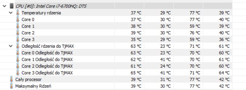

    Above, you can see that without my stand, the SSD heats up to 61 degrees and the CPU oscillates around 70-80 degrees, reaching higher temperatures over time.
    Below the same graph after some time:
    System stability test graphs in AIDA64 showing temperatures and CPU usage. .
    Above you can see that the temperature is still rising, with the cores reaching 80-92 degrees.
    Ok, I turn it back on to full cooling, see below: .
    Temperature and CPU usage graphs in AIDA64 Temperature and CPU usage charts from a laptop cooling test. .
    SSD is down to 30 degrees, cores are at about 50-60. not bad!

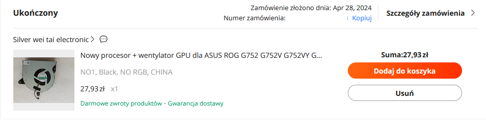

    He has been heating up quite a bit since the beginning. Generally it is cleaned every so often, the carving with the pad I decided to do additionally to see how much it would help. I also recently replaced one fan in the middle because it died after 5 years of use:
    Screenshot of an online order for a new GPU fan for ASUS ROG G752. .

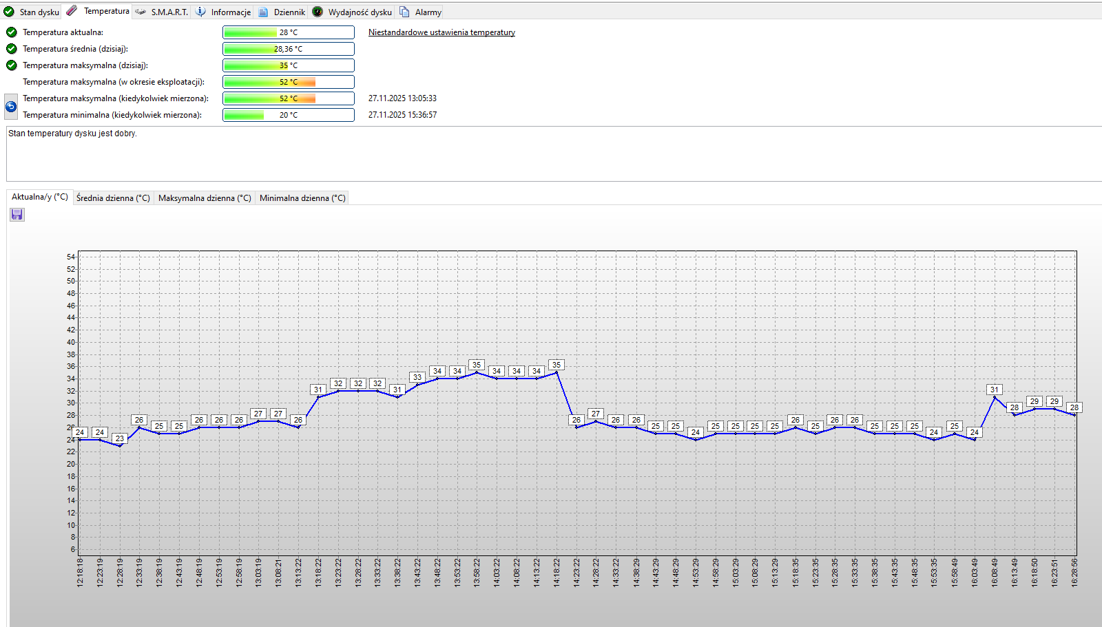

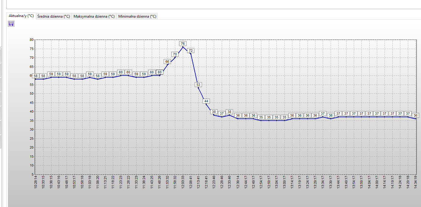

  • Cooling stand keeps SSD below 76°C with low fan speed
    #24 21325956
    Posts: 14765
    Rate: 12899

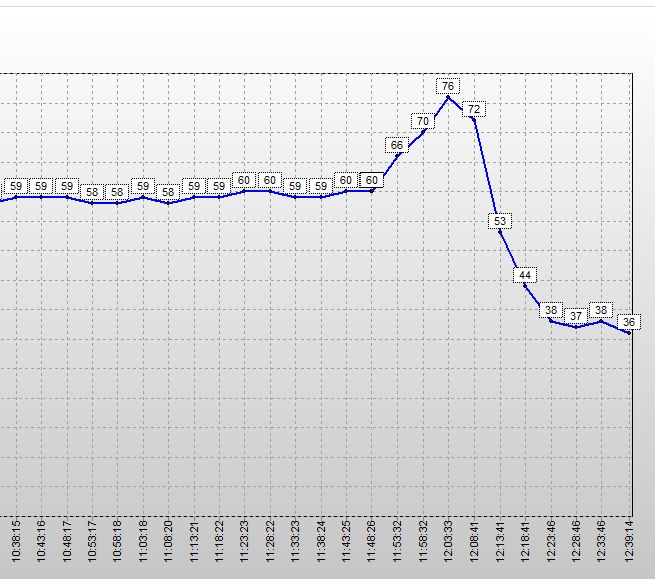

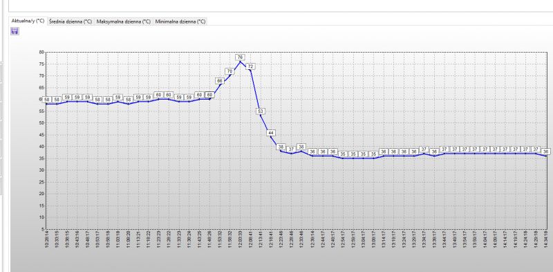

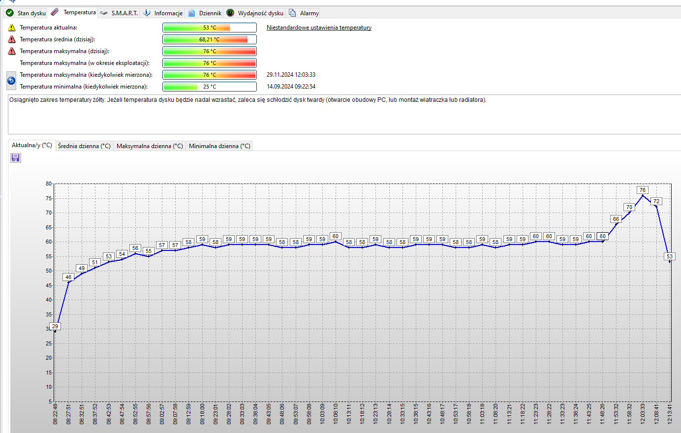

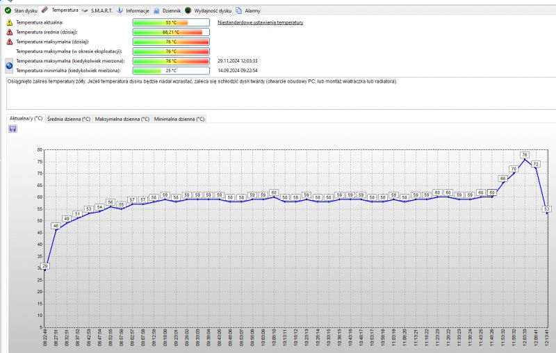

    A small update. I use my "coaster" all the time and am happy with it. Today I forgot to switch it on once and the SSD Samsung 960 PRO 2TB already started to heat up by some miracle to 76°C, am I seriously torturing the hardware that much?
    Graph just after turning on the cooling and a little later:
    Temperature graph for Samsung 960 PRO 2TB SSD with current, average, and maximum temperature values. .
    Temperature graph of SSD Samsung 960 PRO 2TB, showing a rise to 76°C and a decrease after cooling is enabled. .
    Temperature graph showing a drop from 76°C to 36°C after cooling is activated. .
    And the fans don't even run at full power, just some fraction of it given. The noise is not bothersome.
    I think I'll find some time and just develop the project so that the whole thing turns on by itself depending on the temperatures of e.g. this SSD and/or CPU, based on that I could also adjust the cooling power.... I think I even know what I will use - I used to do Colour CPU temperature display (controlled via Ethernet) .

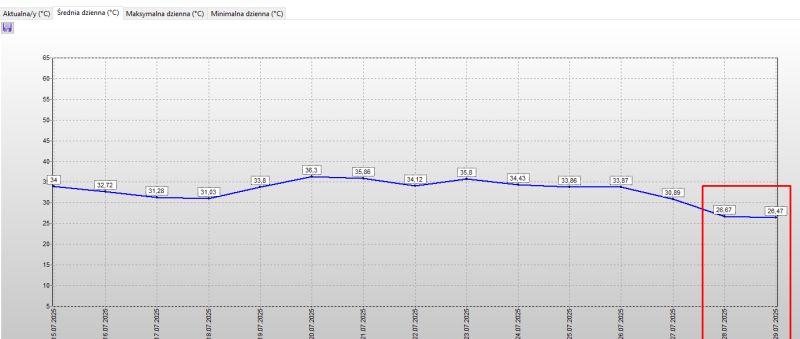

  • Drilled ventilation holes and added 9V fan cooling
    #26 21620667
    Posts: 14765
    Rate: 12899
    Yesterday the battery in the laptop died and I had to take it all apart, remove the motherboard to get to it, so I had time to play around.... I did what a colleague suggested:

    Anyway - results with better airflow:
    Laptop temperature chart showing drop to around 26°C after cooling changes .
    Last hour of operation:
    Screenshot showing Intel Core i7-6700HQ core temperatures in monitoring software .
    That's with fans on 9V to keep the noise down.
    Normally I'd have swapped it for a desktop long ago, but a laptop in such bad condition I'm not going to resell anyway because it would have to have the aforementioned top case replaced (the keyboard is welded), so such a "sculpture" as in the topic is worth it to me.

    The year is coming to an end and the fun continues. Only when I'm on the phone and it's faintly audible do I turn the cooling down hard. These are the temperatures from today:
    Hard drive temperature chart from diagnostic software with daily readings
    I remember that at one stage, before cleaning this laptop, and before the additional cooling, I had a few times the situation that it shut down from overheating, now it has not happened once during this year. Only when replacing the battery did I blow out the heatsinks and remove the collected dust, also from my fans.
