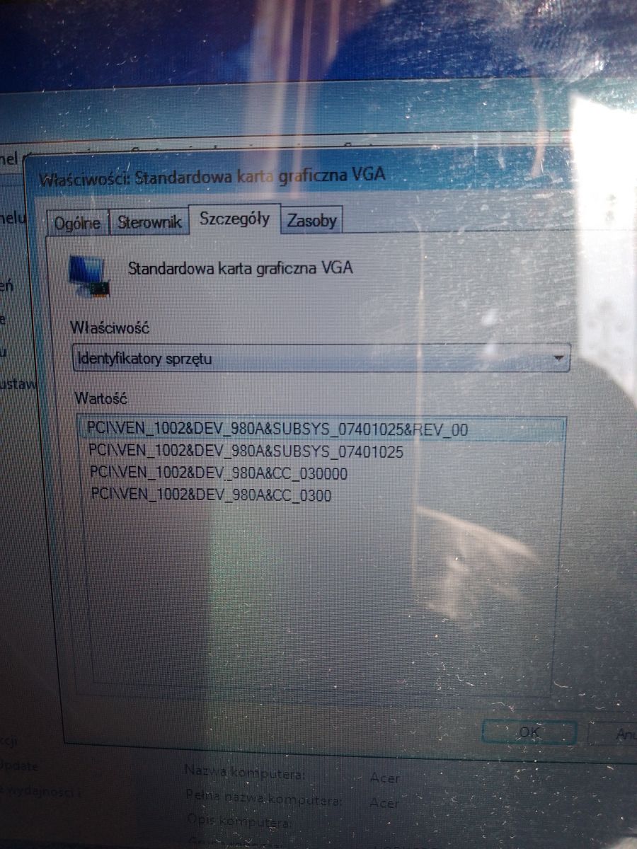

    Enter the IDs of the graphics card or graphics cards that are present in this laptop. The driver must be selected, only the right one. In the case of this laptop, it may be drivers for the chipset and integrated graphics card at the same time.
    If it is an AMD C-70 with integrated Radeon HD7290 then you can check these drivers:

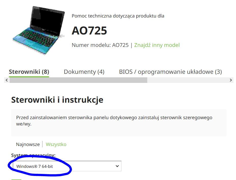

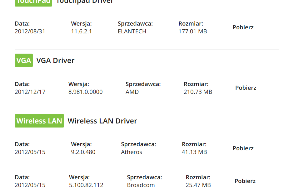

    This is HD7290 so check the drivers I provided above.
    Added after 5 [minutes]:
    Alternatively, if these don't work, you can download drivers for the Acer AO725, it was also based on the C70 processor and is supported for Windows 7 on the Acer website:
    https://www.acer.com/en-us/support?search=AO725&filter=global_download&suggest=ao725;0
    VGA category.

    The card is already correctly detected in the manager as HD7290? There's no note stamp on it? When you go to the properties of this card, there is information that the device is working properly?

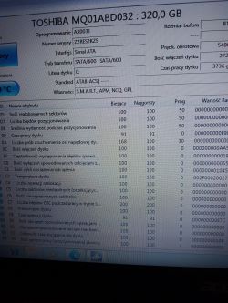

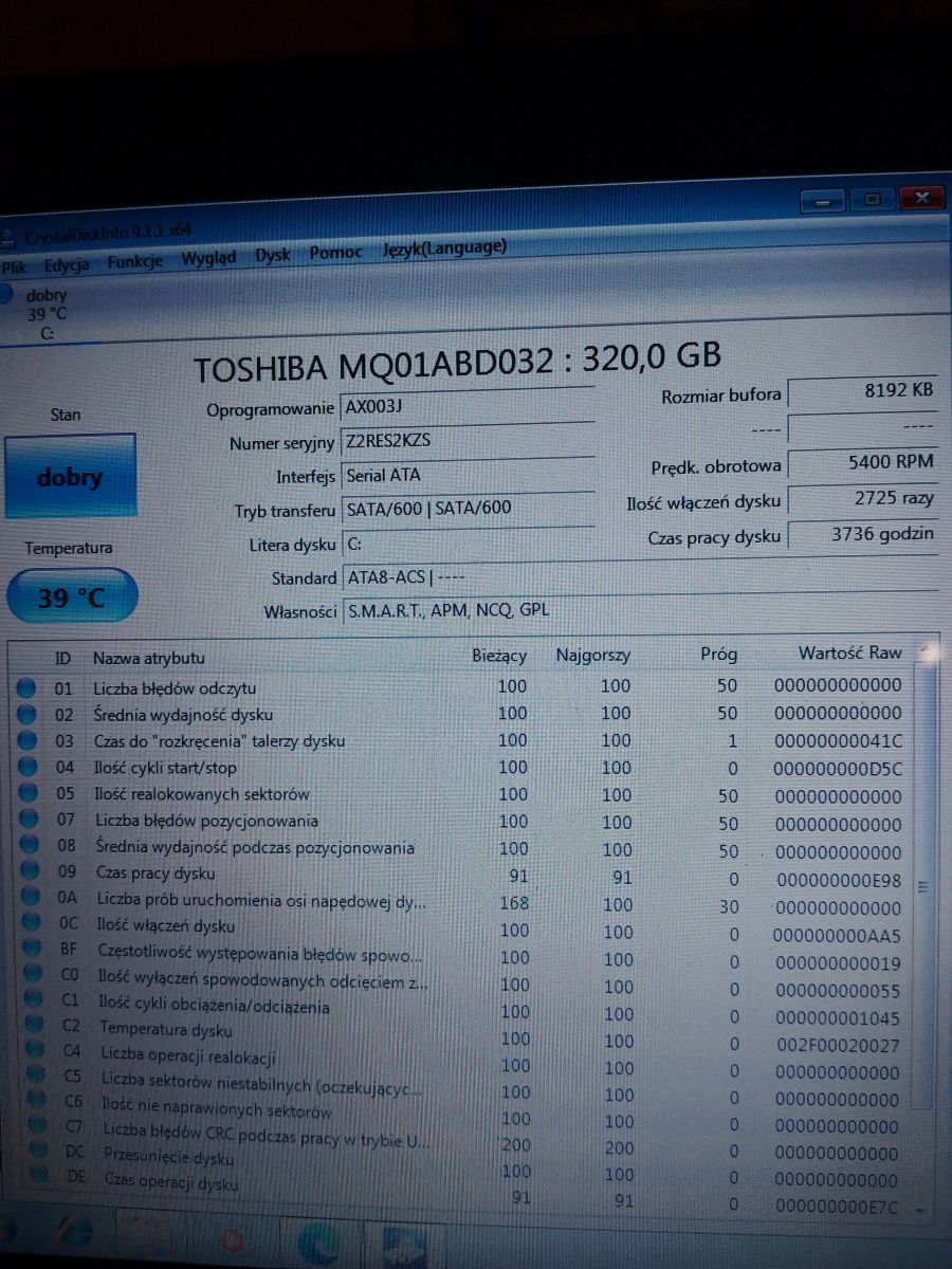

    The message may be caused by disk damage, download Crystaldiskinfo, run it, stretch the window so that all data is visible and post a screenshot showing the status of the disk.
    https://crystalmark.info/redirect.php?product=CrystalDiskInfo
    If the installation of the correct drivers on a working system causes error 43, it may mean a hardware problem with the card (its damage).

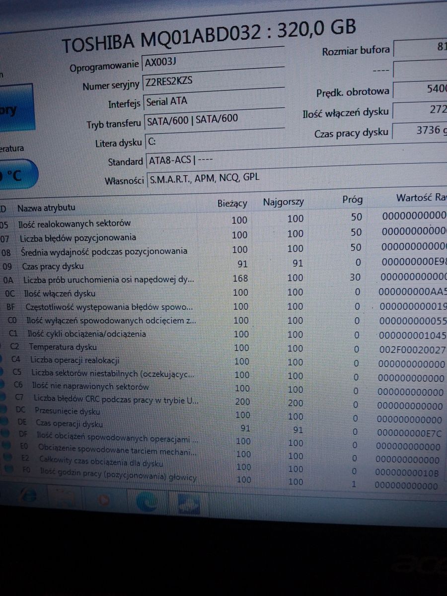

    The disk looks OK.
    If you interrupt this check each time, it will keep displaying until it finally executes.
    There is a problem with the file system on one of the partitions. It may be due to the computer freezing or shutting down incorrectly while working.
