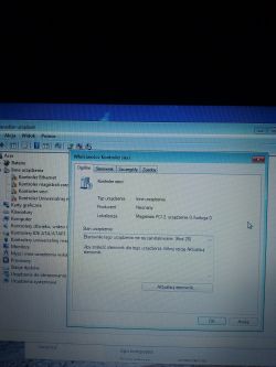

    Hi. I have the same problem as my friend. It doesn't say what network card I have in the manager or via cmd. I just installed Windows 7 x64 on an Acer Aspire V5-121 C72G32nkk. I found in the list that there were 2 network cards for this model - Broadcom and Atheros. I've installed drivers at random for both, but still no internet. Oh, and on the box it says: WLAN Acer Nplify 802.11 b/g/n. But it was hard to find drivers for this, something worked, it weighed 5 mb, but it did not help after installation.. Using the CPU-Z program, I found in the Mainboard tab that my motherboard is Acer, model ZA10_BZ and then on the right oe2-A01 Board Version. Underneath it also says PCI Express 1.0. I google it, but I don't find anything, especially no drivers for WLAN. I also searched on acer.com for the SNID number, but did not find this number. How to find them?

    He'd better start with a screen shot of the device manager.

    I can't send the manager screen until the evening, but believe there's nothing there, as normally I know it says the card company name, model etc.

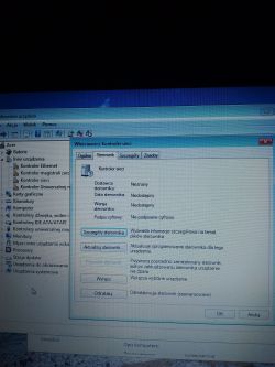

  • #17 20661538
    grindavik
    Posts: 58
    Nodel of the network card in Acer Aspire V5-121 C72G32nkk Nodel of the network card in Acer Aspire V5-121 C72G32nkk

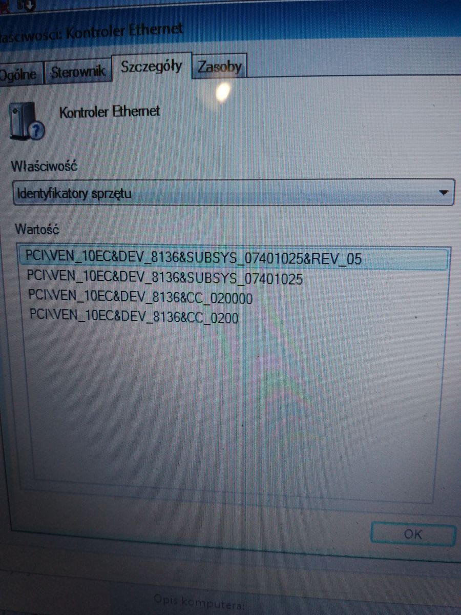

    Almost. Now just the details and hardware ID - and we'll get to what everyone's been clamoring for since the beginning of the thread.
  • #20 20661584
    smoq35
    Posts: 1311
    Help: 128
    Rate: 55

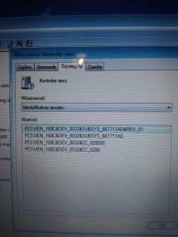

    In the manager you have 2 network cards - "ethernet controller" and "network controller".
    Give the hardware IDs of both of these cards, because for now we don't know which is which.

  • #23 20661648
    grindavik
    Posts: 58
    #24 20661654
    Kolobos
    IT specialist
    Posts: 85164
    Help: 17165
    Rate: 10442
    Bravo... here you have drivers for wifi (network controller): https://dl.driverpack.io/driverpacks/repack/W...alComm-FORCED-7x64-BigFoot_10.0.1.263-drp.zip unpack and install from the device manager by selecting updates and pointing to the unzipped directory.
    Here for the lan card -> https://dl.driverpack.io/driverpacks/repack/L...hver-FORCED-7x64-PCIe_7.142.1217.2021-drp.zip
    @smoq35 names do not matter anyway, it is installed after identifiers and in this case, as you can see, it is as I wrote.

    Atheros AR5B125 Wireless Network Adapter
    edit: I see I was prejudiced :)

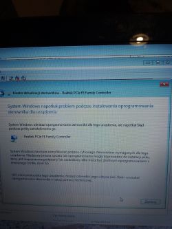

    Nodel of the network card in Acer Aspire V5-121 C72G32nkk Thank you gentlemen, it's actually good to search by identifiers, at first I thought it was more difficult, so I didn't try it myself.

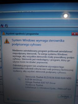

    PS. This driver for Atheros turns out that I installed the same model of network card blind the first time, but normally I gave setup and not through the device manager. Could that be the reason it didn't install?
    PS2. The first one went without a problem, but for Ethernet it threw an error and I guess that's why I can't configure the network (because the router as such already sees and connects via wifi, but I won't open any website).
    It seems to have finished the installation, but in the manager it still lights up yellow. Do I need to do something about it or is this not the reason? Nodel of the network card in Acer Aspire V5-121 C72G32nkk

    Check the driver from the attachment, also through device manager.
    From the manager photo, you are also missing the USB 3.0 driver, the chipset driver, you may also be missing the graphics card driver (if you expand the graphics cards section in the device manager and it shows a standard graphics card and not an AMD card, then you do not have the correct driver). Next - keyboard shortcuts (screen brighten/darken, volume and other special functions with the Fn key) may not work for you. Advanced touchpad functions (e.g. finger scrolling) may not work for you.
