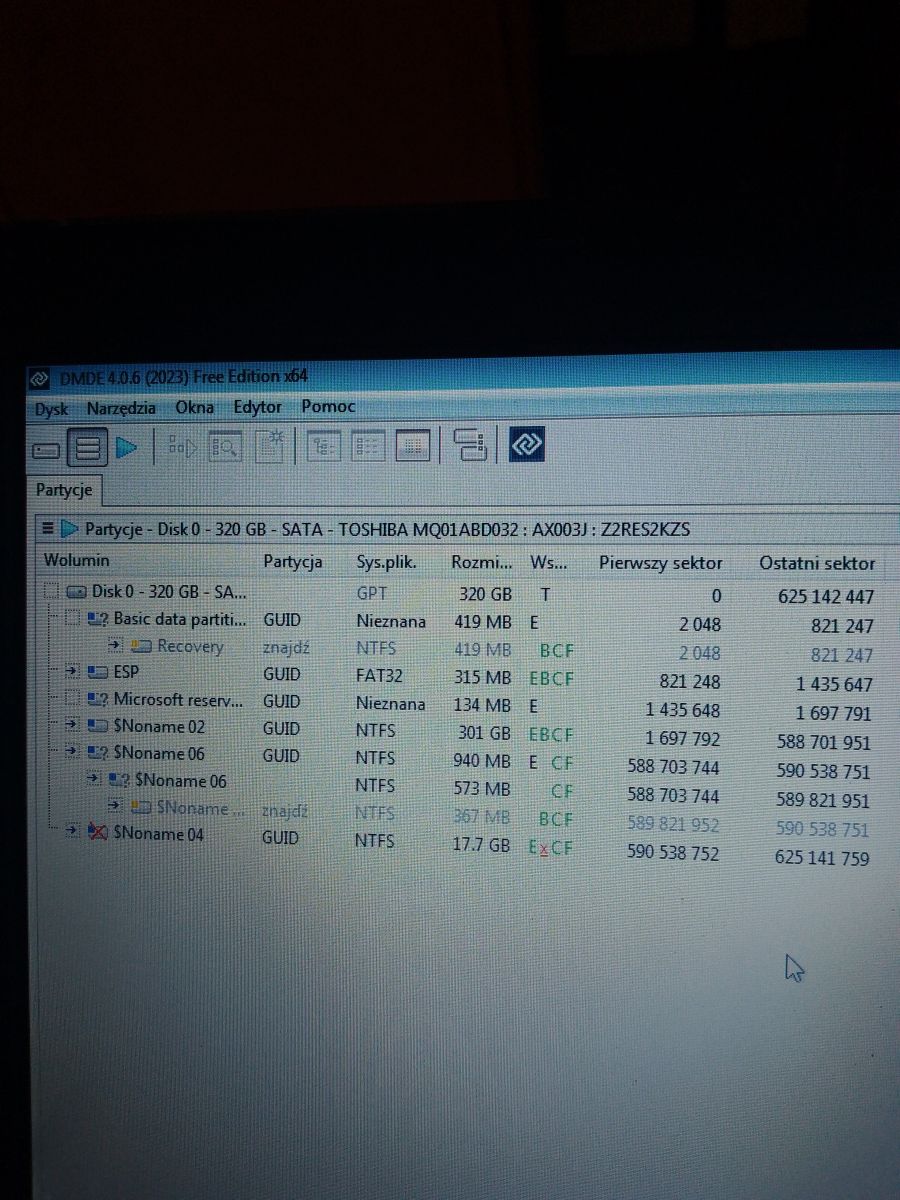

What is CrystalDiskInfo used for, and how can it help when Windows keeps asking to scan the disk at startup?
CrystalDiskInfo checks drive health, so it helps separate disk failure from file-system problems. “CrystalDiskInfo is a disk-health utility that reads storage status and SMART-like condition data, helping you tell whether repeated startup scan prompts come from a failing drive or from corruption elsewhere in the file system.” In the thread, it was used after repeated startup scan messages, and the conclusion was that the disk looks OK. That shifted attention away from outright drive failure. [#20665446]
How do DMDE and a partition table screenshot help diagnose repeated disk-check messages or hidden partition problems after reinstalling Windows?
They show whether a hidden partition is damaged. The helper asked for the first partition table view, not a full scan, because the repeated startup check likely came from one invisible partition, possibly the recovery partition. A partition table screenshot quickly reveals the layout and which entry may be broken after a reinstall. That is faster and more targeted than rescanning the entire disk when Windows keeps asking to check it at boot. [#20665494]
