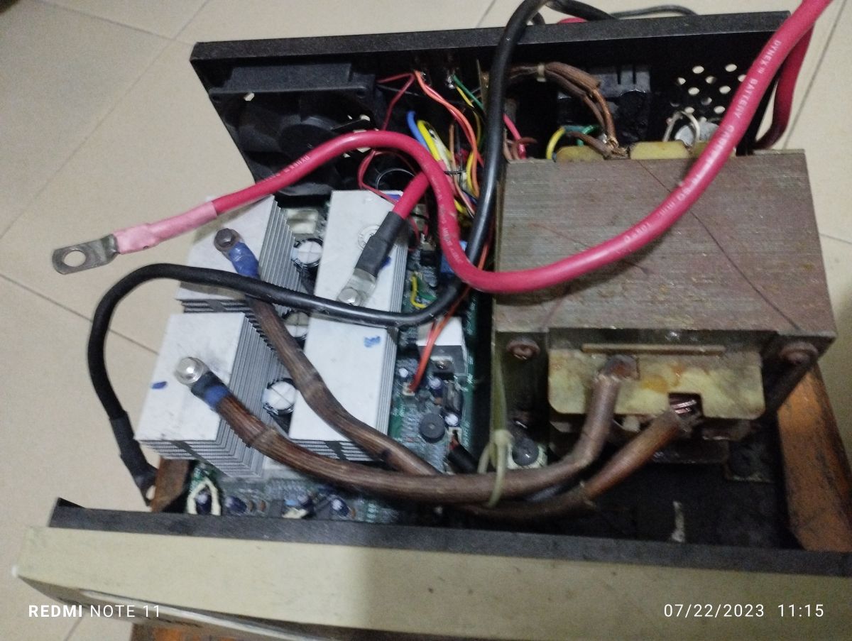

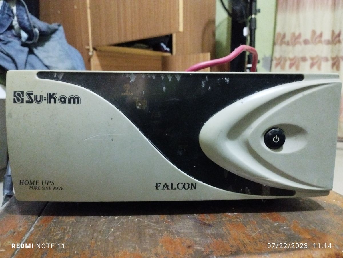

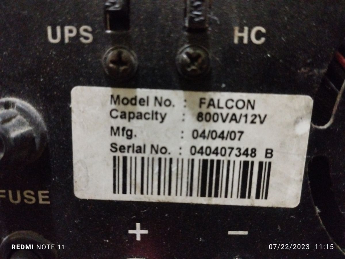

    I have a Su-kam Falcon 800VA/12V and I mistakenly overloaded it. And it went off. When I opened it, I noticed the two 40A fuses were blown. So I replaced them. Then I turned it on and the inverter started clicking continuously. I've checked all components and all seem good.
    So I removed the PIC microcontroller IC, copied the firmware from it, erased it, and copied it back to the microcontroller. Right now, there's no clicking sound and the inverter will not come on.
    I'm suspecting the code was not copied completely, that is the reason it's not coming on again.
    Please, if there's anyone that can provide the firmware, I will be grateful so I can try it again.
