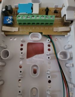

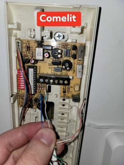

    I would like to replace my existing Comelit intercom with a new Comelit 2602 intercom.
    I have attached pics of the old and new intercoms.
    In the old intercom, blue and white/blue wires were connected to "L" and orange and orange/white wires were connected to "L". The rest of the wires were not used.
    The new intercom has the following ports: S, 2, 3, 4, P1, C1, P2, C2.
    I would really appreciate if someone can advise where to connect each cable in the new intercom.
    Thank you in advance.

    You bought the wrong uniphone again.
    You need to buy IDENTICAL as the previous one - for digital systems and you bought for ANALOG.

    Hi and thanks for your response.
    The previous one is an old model that I cannot find anymore. It's the 2408W/A Comelit.
    Can you please recommend one that will be suitable for replacement?
    Many thanks.

    Mgrivakis wrote:
    I would like to replace my current Comelit intercom with a new Comelit 2602 intercom.
    It's not possible, they are different systems.
    You need something like the 2708W: https://pro.comelitgroup.com/product/2708w.
