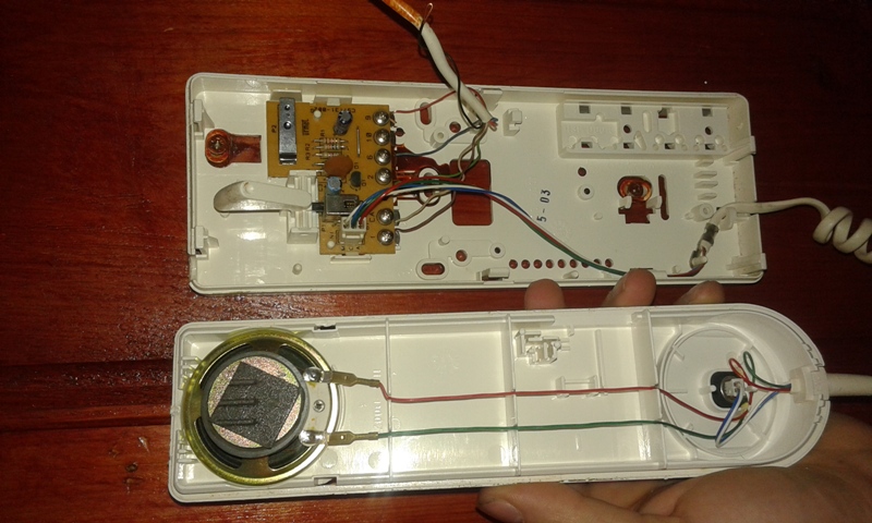

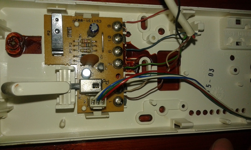

    Hello :) I'm desperate and I don't know much about electronics!
    I have an intercom that is in agony, more tape and glue on it than possible :) the decision was made to replace this device :) (wife :) It wouldn't be a problem if I knew how to do it :) !!
    In the old intercom, the wires are soldered to the board, there are 6 of them, the new (almost) Urmet 1131 intercom, as far as I remember, has 5 places to connect the wires. Can you tell me what color of the cable I should connect to which contact of the new intercom to make everything work :)
    photo 1 shows my old intercom
    photo 2 new but this is a photo from the forum from you and there I see 6 places to connect I think there are 5 :)

    in total, in photo No. 2 you can see the colors of the cables, but you can see two red ones there :( and I don't have two, maybe it's a bridge? , secondly, it seems to me that there are 5 places for screwing the cables :) and in photo 6 I do not know if there are different types of intercoms with 6 and five connection points!!??

    Hello !
    There may also be 6 wires in the Urmet uniphone, but you can't see much in the picture of the old uniphone, take a picture of the whole thing so that you can see where these wires go, you can suggest something!
    Regards !

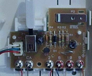

  • #3 3523622
    zybex
    Helpful for users
    Posts: 15919
    Help: 2094
    Rate: 2939
    I've never installed these, though
    CA - is a call
    1 - handset (SU)
    2 - microphone (MU)
    6 - mass (0)
    9 and 10 opening button
    The picture shows a broken bridge. This must be the case with a six-wire system.
    For starters, set these two to the open button. Save these colors. Then (if you have a meter) you'll be fine.

    kurnajanek
    Posts: 39
    Rate: 7
    well :) thanks for showing interest :) The day is coming to an end, I'm burnt out ;)
    I'm attaching a photo of the model I'm about to wear:
    Connecting and Replacing Old Intercom with New Urmet 1131: Wire Colour Guide
    , as I said, I have five places to which the wires can be connected, not 6 as in the previous photo (moreover from the forum) and now the second one that is to be replaced :) : ( Someone asked for more :)
    Connecting and Replacing Old Intercom with New Urmet 1131: Wire Colour Guide ]
    someone wrote to me:
    2 - mass 9-something else etc ..... can you, if it is predetermined, speak in colors ?? :) because I don't really know how to determine which mass has which functions
  • #5 3524146
    Robert 1960
    Level 32  
    Posts: 2454
    Help: 238
    Rate: 408
    Hello !
    You have 5 because you don't have a screw from 1, you either fell out or it wasn't there and it should have been!
    Your photos still don't show the microphone or the speaker, so you don't know where these wires go!

  • #6 3524262

    #7 3525261
    martelek
    Posts: 30
    Rate: 8
    If you don't have a meter, disassemble the handset and see which wires from the twisted cable are connected where. There will most likely be 3 wires coming out of the handset, where the one that connects one contact of the microphone and the loudspeaker in the handset is the ground that should be connected to terminal 6 from the new uniphone. The wire that is connected to the second contact from the speaker of the handset should be connected to terminal 1 (where you do not have a screw) and the wire from the microphone to terminal 2. To determine which wires are responsible for opening the electric strike, unscrew this plate in the old uniphone and see which wires this opening "plate" shorts and connect them to terminals 10 and 9 and you will have the last "call" wire that needs to be connected to the CA terminal
  • #8 3535019
    kurnajanek
    Posts: 39
    Rate: 7
    welcome back ! So I did as you advised me :) the intercom works almost flawlessly :( but it almost makes a big difference :) ........ you can't hear me downstairs, the silence is like sowing poppy seeds, the rest of the functions are ok :)
    please advice :)
  • #9 3535895
    zybex
    Helpful for users
    Posts: 15919
    Help: 2094
    Rate: 2939
    The second clamp is the microphone. You must have a DC voltage (plus) in the range of 8-15V (relative to the ground cable) on the cable you connect here.
