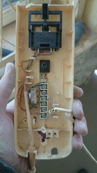

    Hello, as in the topic, I have a problem with connecting the new Cyfral Smart-5p handset in place of the old one. I attach a photo of the old connected one that worked and the new handset, please help with the diagram. greetings

    It should be written something more about the old handset, or draw a diagram. Unless you count on the help of an "expert" ;)
    Just what is.
    Green -> RING
    White -> Mass
    Red -> SPK
    Blue -> MIC
    ZW1 removed
    ZW2 founded
    ZW3 founded

    After connecting in such a scheme, the call button from the outside works, but after entering the blue one on the MIC, the bolt at the door is still working and you cannot hear the conversation.

    Ok so it will be like this:
    Green -> RING
    White -> Mass
    Red -> SPK
    Blue -> SW1
    You connect one capacitor contact to the MIC (the cylinder in the old uniphone) and the other to SW1
    You connect an additional cable with GROUND to SW2
    ZW1 removed
    ZW2 removed
    ZW3 removed
    Was the old uniphone working properly?

    Unfortunately, I do not know because I have not checked and I do not have it anymore, and what capacitor to use because I did not read from the old one?

    The photo is not very legible so I am not sure either, you have to combine try 2.2 u or 10 u at 50V.

    I used a 4.7uF 50V capacitor and connected in different polarity, then the bolt opening button did not work

    Insert a photo of how you connect it, because something does not suit me here. Can you hear you downstairs?

    Except that I had to extend the cable and the colors are different
    Heaven -> Heaven -> MIC
    Red -> Bronze -> SPK
    Green -> Gray - RING
    White - white -> ground

    You connect incorrectly, read my second post where I wrote how to connect.

    after correcting now, the interlocutor can hear very poorly both ways, maybe the value of the capacitor or its polarity can change?

    You can try, however, I do not know if it will do anything, so that you can hear what someone says downstairs you have a potentiometer on the disc that clearly describes the sensitivity of the microphone. As for the volume from the bottom up, you can do nothing yourself, only administration.

    I tried to manipulate the potentiometer, but it did not work, I was at my neighbor's and it works ok, I also took a photo of its connection

    From this you could think that you had a wrong uniphone connection from the beginning.
    Try this
    Green -> GROUND
    Blue -> MIC
    Orange -> SPK
    White -> RING
    ZW1 removed
    ZW2 founded
    ZW3 founded

    I connected as follows:
    Green -> Gray - ground
    White - white -> ring
    Now you can hear the call inside, I can hear the interlocutor well from the outside, but I feel weak outside and when you try to press the opening button, the receiver starts to squeak and the bolt does not work. After hanging up the handset and pressing the button, the bolt works.

    My friend, there are no standards in your installation, try to swap white and orange and see what happens. If it doesn't help, call someone from the administration who deals with it and connect it as needed.

    I changed and nothing, but I looked into the box where all the wires are and it looks like this: blue to all blue, white to all white, orange to orange and green individually goes to the cassette

    Well, the only thing that is certain is that the green one should be connected to the RING, and the rest of the three should be combined. When you have good audibility up down down take the bolt.
    Try this again:
    Green -> RING
    blue -> Ground
    Red -> SPK
    white -> SW1
    ZW1 removed
    ZW2 removed
    ZW3 removed

    In this configuration, as shown in the picture, the call works, you can hear it both ways, but I do not know why the bolt button works only when the receiver is hung up?

    Buddy, too many contradictory things, see how you described the connection on the staircase and how it is at the neighbor's. It does not match that the neighbor's green one is connected to ground and on the vertical it looks like a generator. Go to the administration and they will connect you, without knowing which, as I can see, you won't do anything, and someone who knows how it works will be able to do it in 5 minutes.
