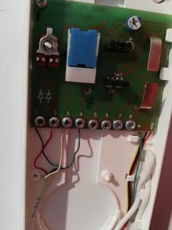

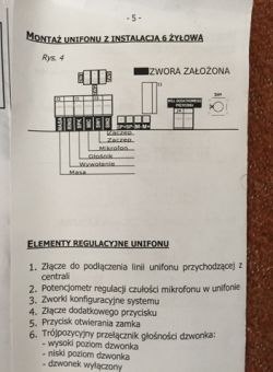

    I'm trying to replace the intercom from the old one with the new Cyfral 5P, seemingly simple, but still.
    I came to the conclusion that on the old intercom, the blue and gray wire is a hook and further uphill. I'm attaching photos, please help.
    Connecting & Replacing Old Intercom with Cyfral Smart 5p: Wiring & Troubleshooting Help Connecting & Replacing Old Intercom with Cyfral Smart 5p: Wiring & Troubleshooting Help Connecting & Replacing Old Intercom with Cyfral Smart 5p: Wiring & Troubleshooting Help
  • #2 17124591
    zybex
    Helpful for users
    Posts: 15919
    Help: 2094
    Rate: 2939

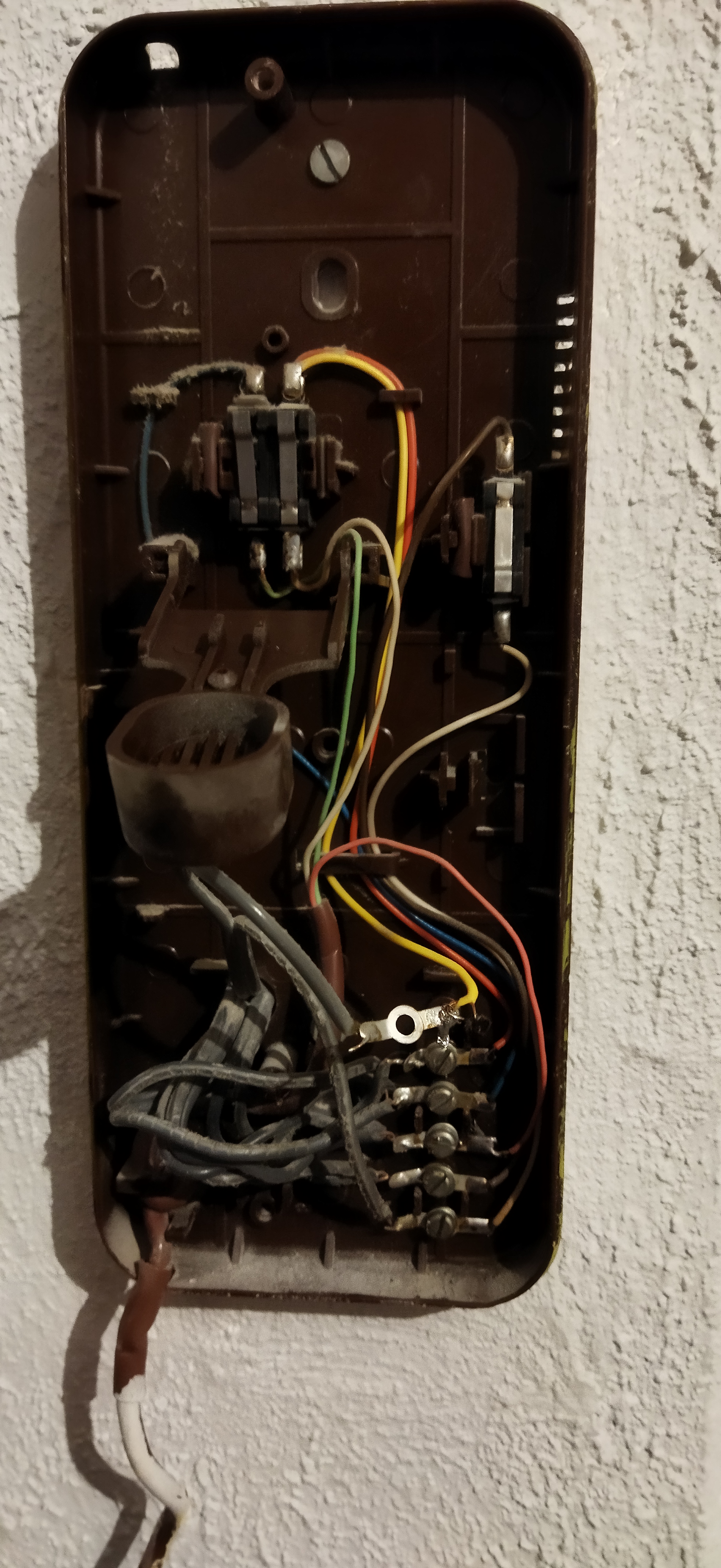

    Your old uniphone is Wekta. From the top you have in turn:
    6 - lock - blue
    5 - lock - gray
    4 - microphone - green
    3 - handset - red
    2 - ground - yellow
    1 - call - white

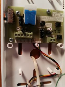

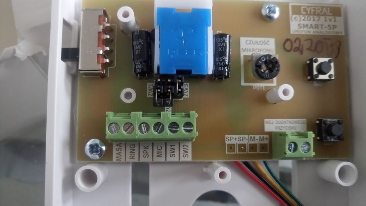

    Hello, I also have a problem with connecting the digital smart 5p intercom below I present photos of connecting the intercom at my neighbor 1 and 2 photo 3 photo my intercom please advice.
  • #4 17131173
    zybex
    Helpful for users
    Posts: 15919
    Help: 2094
    Rate: 2939
    At your neighbor you have Wekta TK6 and in it:
    blue - call - RING
    red - ground - WEIGHT
    white - handset - SPK
    green - microphone - MIC
    Set the jumpers for 4-wire installation with opening in the microphone line.
  • #5 17131226
    sechu
    Posts: 37
    Thanks works fine :) and will he be able to somehow improve the sensitivity of the microphone because it is not audible at the bottom?
  • #6 17131236
    zybex
    Helpful for users
    Posts: 15919
    Help: 2094
    Rate: 2939
    The PCB shows a potentiometer described as microphone sensitivity (pot 1). Try to increase it with it. Use a small screwdriver for this and be careful not to damage the potentiometer.
  • #7 17131248
    sechu
    Posts: 37
    @zybex thank you, I did not notice in this case, I am closing my topic. Regards

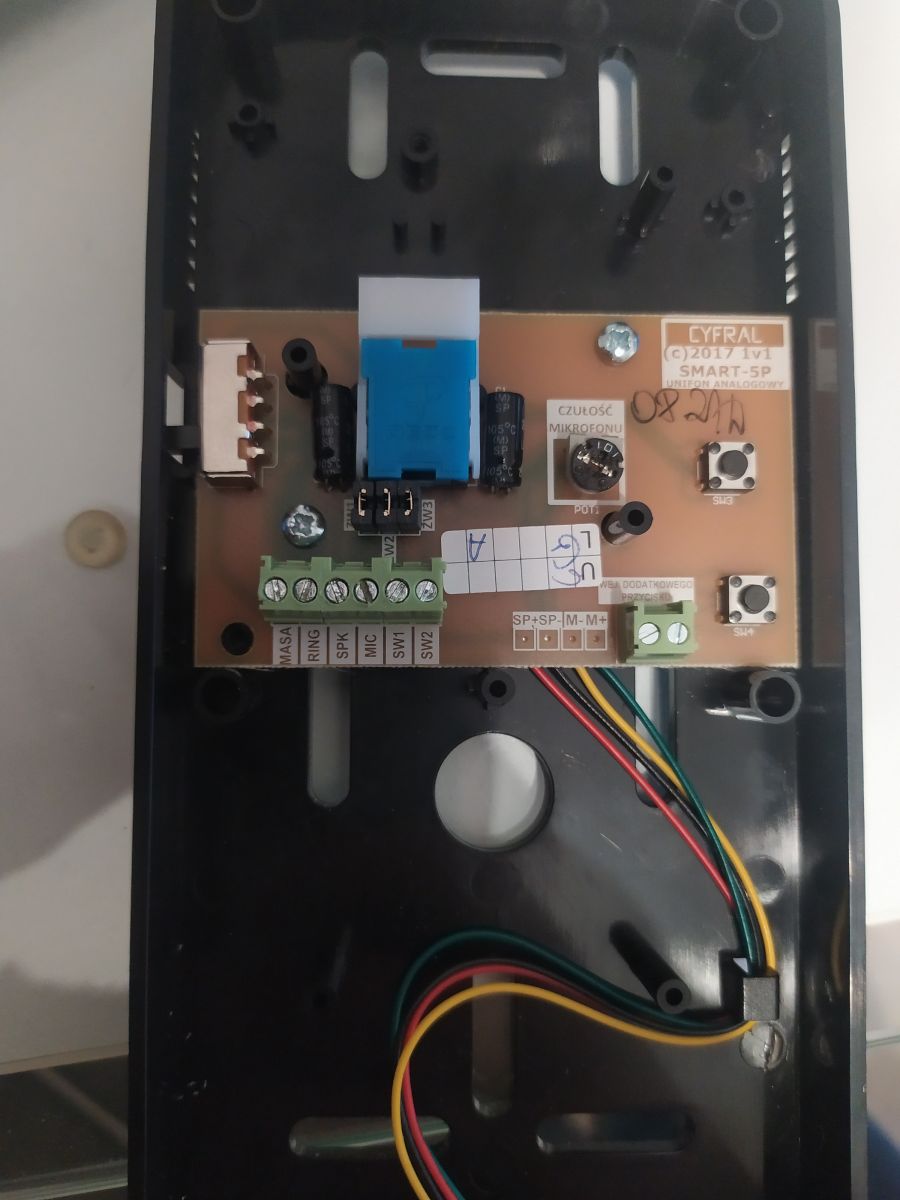

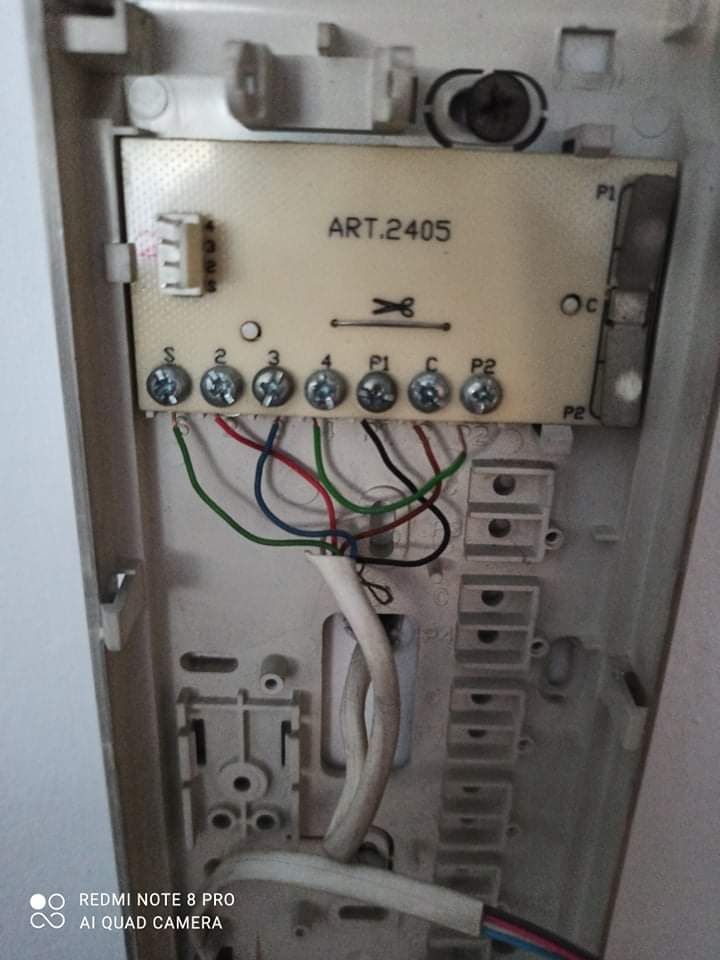

    Hello, how to connect this miracle to the digit 5p smart?
  • #9 18161857
    zybex
    Helpful for users
    Posts: 15919
    Help: 2094
    Rate: 2939
    In this uniphone you have in turn:
    3 - ground - green
    5 - button - gray
    1 - microphone - brown
    2 - handset - orange
    9 - call - red
    Cyfral 5P has in turn:
    GROUND, RING, SPK, MIC, SW1 and to these 5 terminals connect the cables in the correct order, i.e.
    green
    red
    orange
    brown
    Gray
    You set the jumpers according to the instructions.

  • #12 18162803
    Jakotaki1
    Rate: 10
    The uniphone is new. You only hear the hum when you pick up the handset. I cannot hear anyone outside calling or speaking. The door cannot be opened either.
  • #13 18162917
    Ircys
    Intercoms specialist
    Posts: 6969
    Help: 1342
    Rate: 2085
    Correct connection of the Cyfral 5p uniphone:
    WEIGHT - orange
    RING- gray
    SPK - green
    MIC- brown
    SW1- red
    Jumpers:
    ZW1 and ZW2 - removed
    ZW3 - established
    greetings
  • #14 18163110
    Jakotaki1
    Rate: 10
    Everything works except that I can't hear me from home, I can hear the guy downstairs.
  • #15 18163158
    zybex
    Helpful for users
    Posts: 15919
    Help: 2094
    Rate: 2939
    I followed this diagram.
    I described the individual clamps properly, and then I wrote down the colors one after the other. Total eclipse. I am sorry for my mistake.
  • #16 18163199
    Ircys
    Posts: 6969
    Help: 1342
    Rate: 2085
    Something changes the potentiometer adjustment "microphone sensitivity"?
    greetings

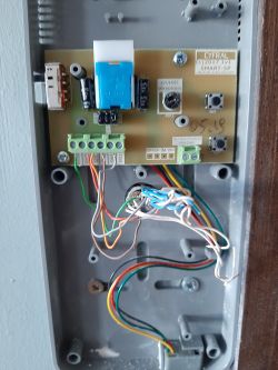

  • #18 18163266
    Ircys
    Posts: 6969
    Help: 1342
    Rate: 2085
    Spin and see if anything changes.

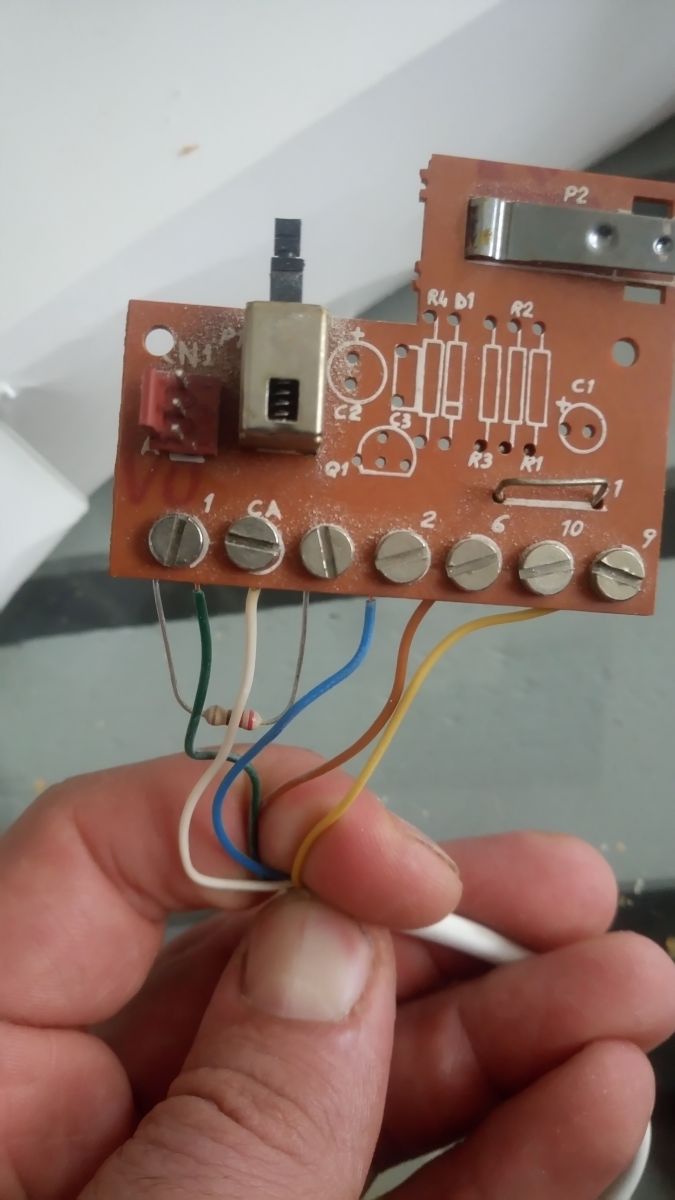

  • #19 19052515
    lukanio
    hello how to connect a new intercom?
  • #20 19052524
    Ircys
    Posts: 6969
    Help: 1342
    Rate: 2085
    lukanio wrote:
    how to connect?
    MASS - brown
    RING - white
    SPK - green
    MIC- blue
    SW1 - yellow
    Jumpers:
    ZW3 - established
    best regards

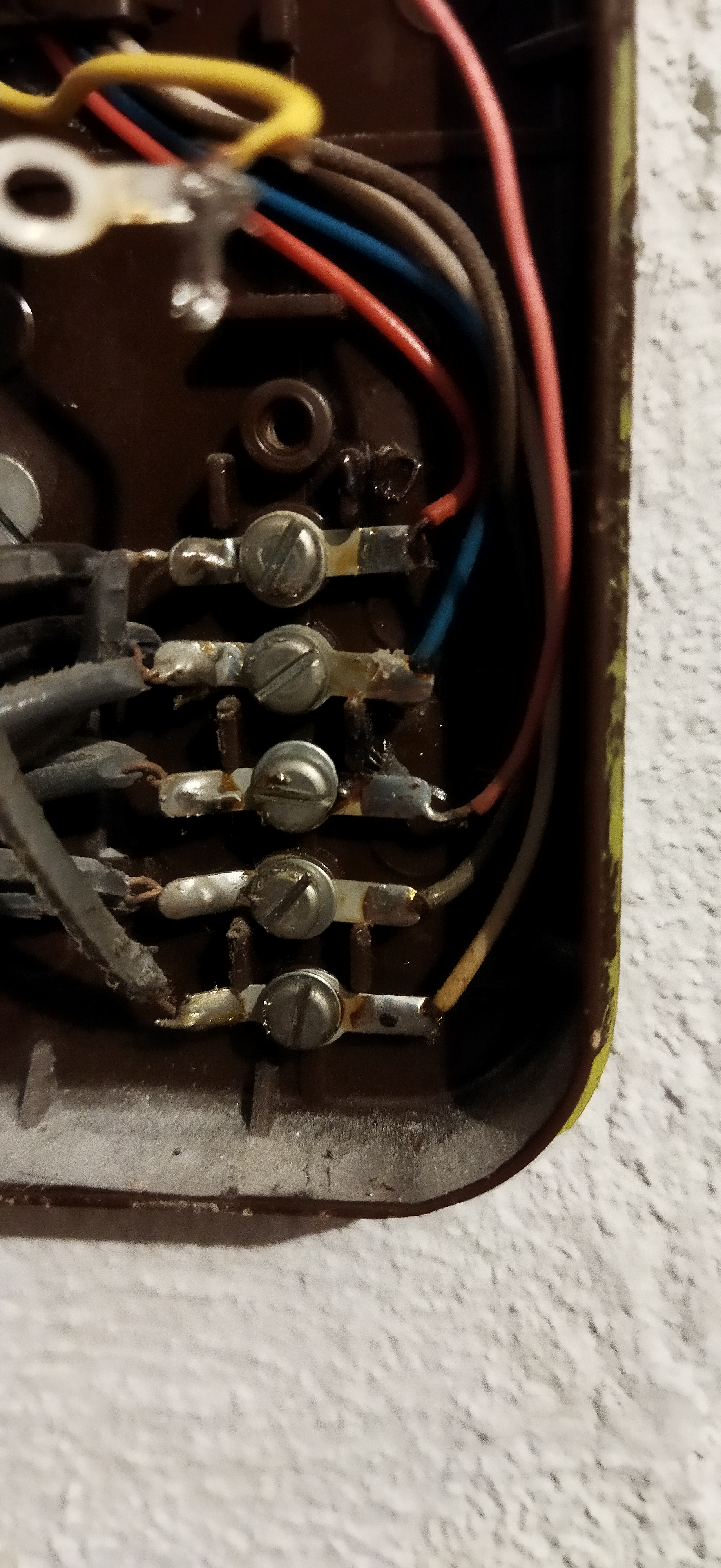

    hello how to connect a new intercom and which jumpers should be removed?
    WEIGHT - green
    RING- blue
    SPK- orange
    MIC- red
    SW1- brown
    Jumpers:
    ZW3 - established
    regards

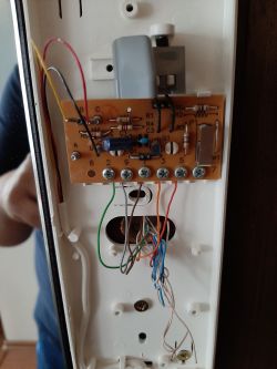

    I am asking you for help in connecting an intercom in a single-family house, the first photo is an old Central demolished intercom from 2000. The second is a new Crystal intercom. Please give me a hint which color should be connected to the new intercom from the left side. Thank you
  • #24 19656722
    Ircys
    Posts: 6969
    Help: 1342
    Rate: 2085
    MASS - brown
    RING- green
    SPK- red
    MIC - blue
    SW1- black
    Jumpers:
    ZW3 - established
    regards

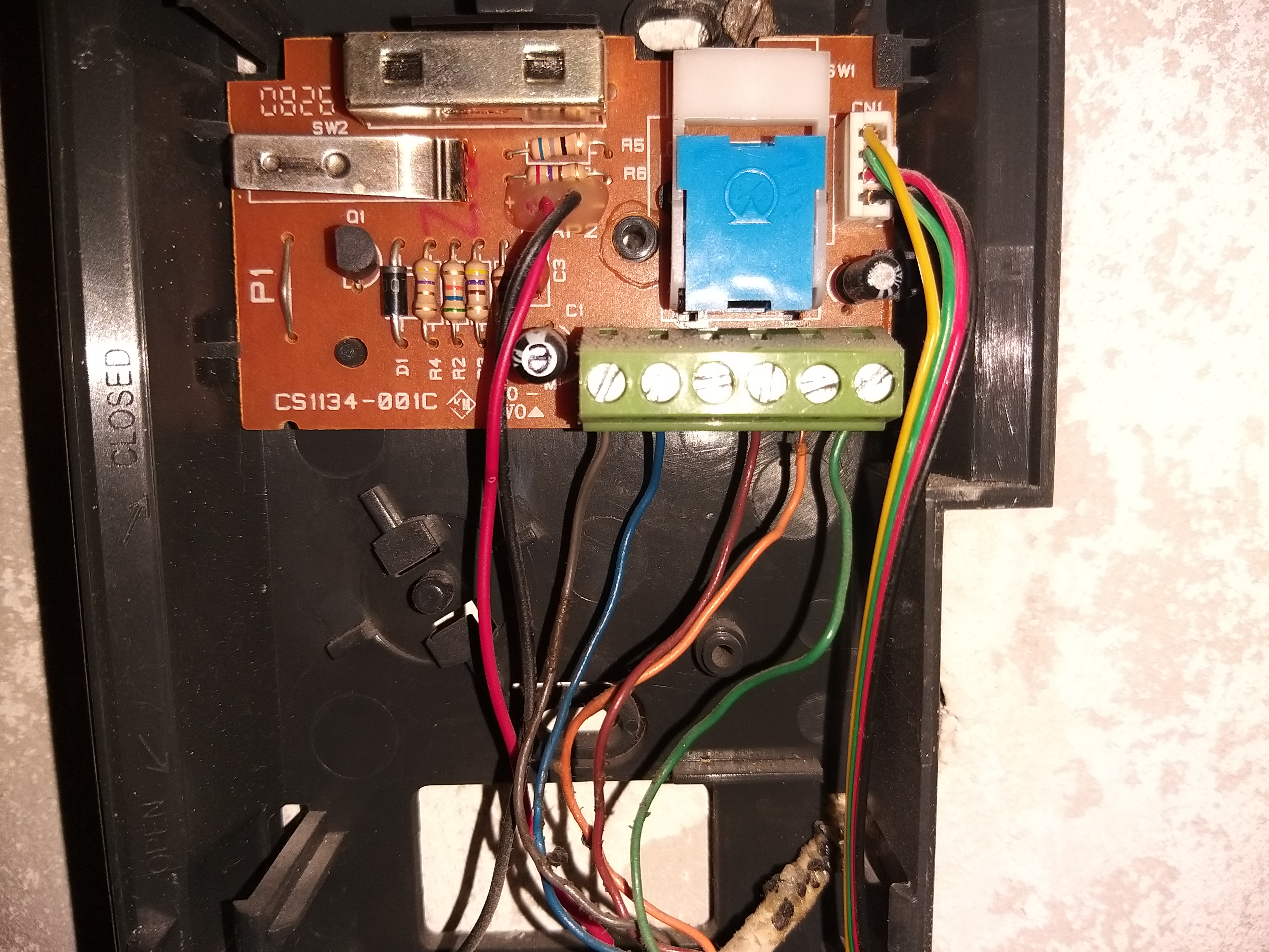

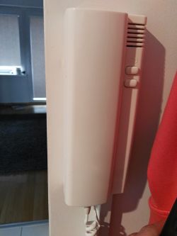

    And how to connect such a thing?
    Connecting & Replacing Old Intercom with Cyfral Smart 5p: Wiring & Troubleshooting HelpIMG_202111...155042.jpg (3.25 MB)You must be logged in to download this attachment. Connecting & Replacing Old Intercom with Cyfral Smart 5p: Wiring & Troubleshooting HelpIMG_202111...155030.jpg (3.12 MB)You must be logged in to download this attachment.
  • #27 19705809
    zybex
    Helpful for users
    Posts: 15919
    Help: 2094
    Rate: 2939
    First of all, these black wires should be labeled. The easiest way to give them numbers is the same as the terminals in this uniphone. After that, it will be quite easy.
    The old uniphone is Laskomex. It has 6 soldering points. And so from the top (including the detached one) you have:
    1 - call (bell)
    2 - handset
    3 - microphone
    4 - mass
    5 - opening button
    6 - opening button
  • #28 19705816

    I did it, only the call at the bottom of the cage does not work for me, when I click, the sound is there, but not in the apartment
