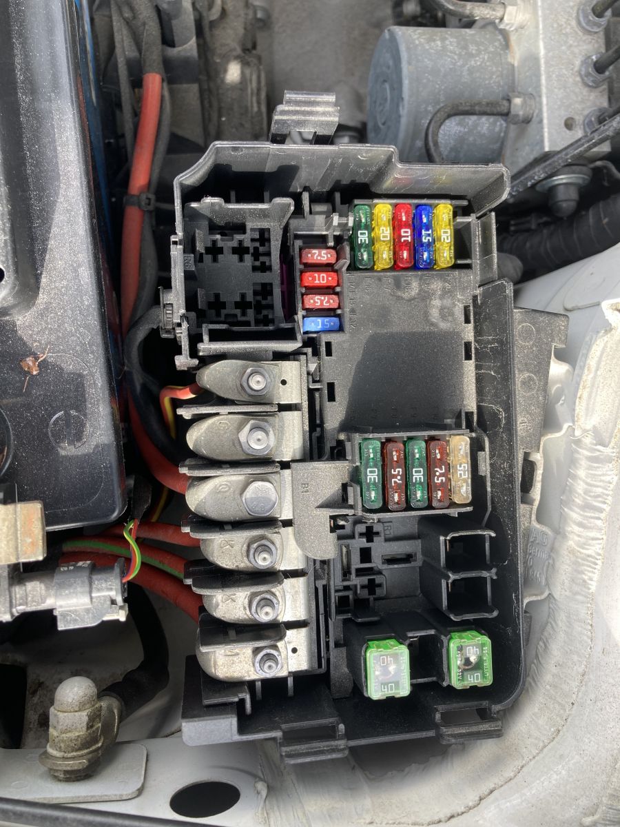

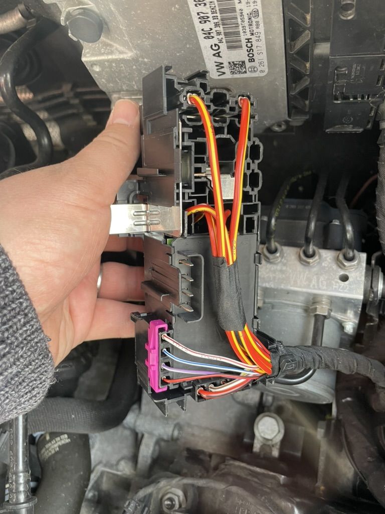

    Thank you for your report. I want to make sure we are talking about the same fuse box, there are two. One in the engine compartment and one in the driver's compartment. Which one did you replace? Attached is a picture from it in my car's engine compartment. I'm guessing it is, but want to be absolutely sure before I buy it. Can you confirm or deny my guess?
    Thanks in advance Engine compartment fuse box of a car.

    I have now bought a new fuse box. I found a used one from a crash-damaged car of the same model year. I know it's a bit of a gamble, but I think it's worth a try. It probably won't be until November that I know if it solved the problem or not. Of course I will then report this here. Thanks again for what you shared.

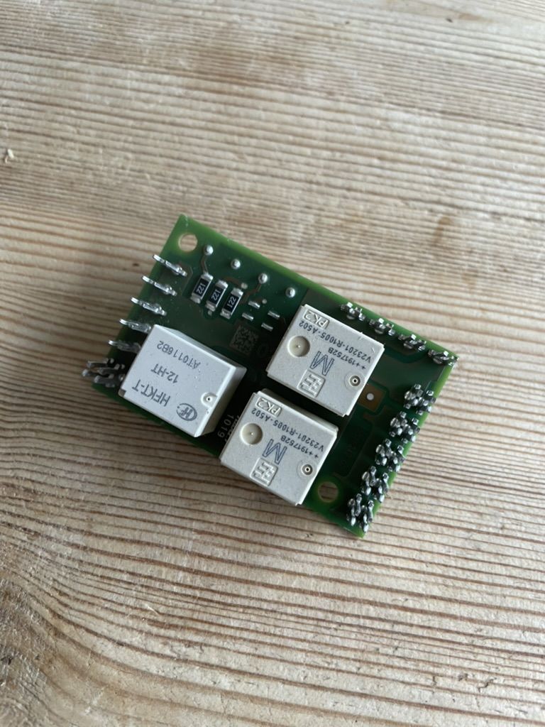

    The fault was with two relays that are built into the fusebox itself. They ordered a new fusebox and fitted it.

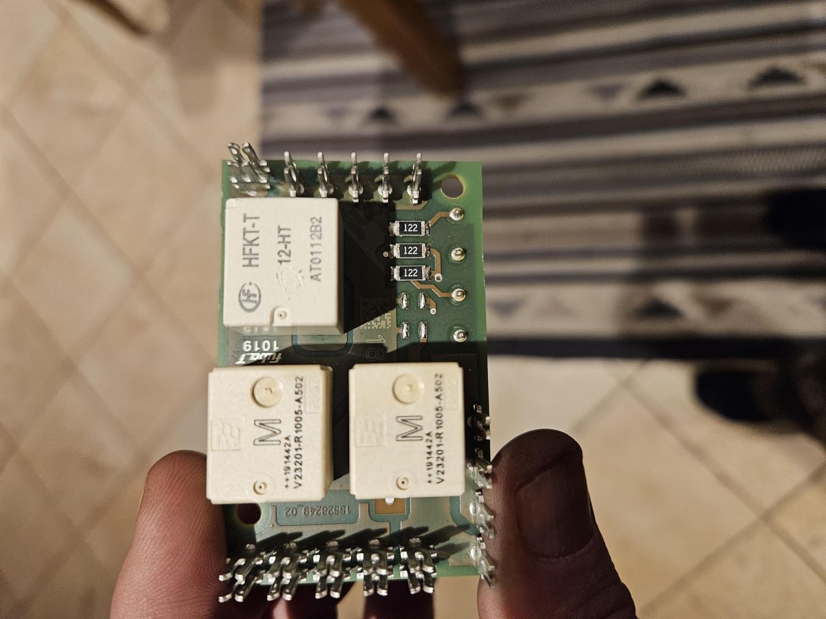

    It was one of the relays inside the fuse box.
    On my Skoda Fabia 1.0 TSI 2019 Circuit board with relays from Skoda Fabia 2019.

    AlistairH

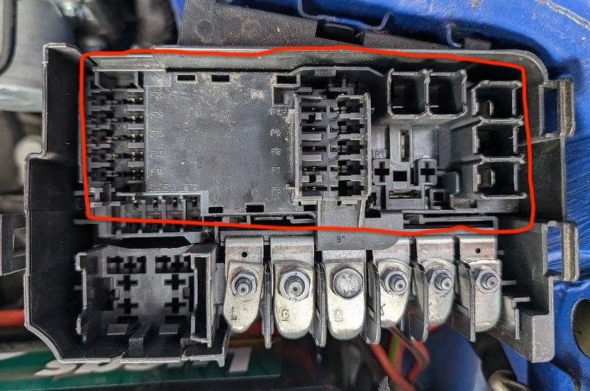

    I've got this problem too, I heated up the area within the engine bay fuse box with a hairdryer, car started first time after not getting close before. So it's one of the relays is it a specific one as there are 3? The Skoda parts place is charging PLN30 a pop so if I can get away with changing one that would be ideal. Also how do I get into the relays, should a section lift? Thanks for all the posts above, very helpful.
    Top view of a fuse box in a car engine compartment with the relay area outlined.

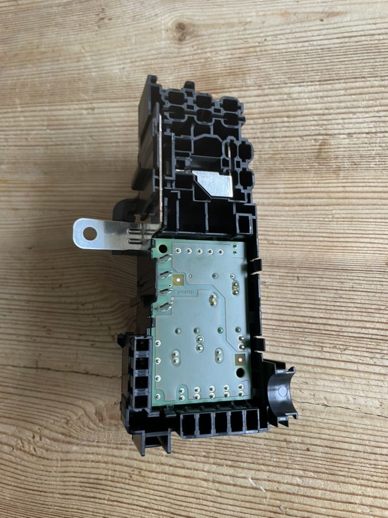

    Larsa
    I did buy a complite fusebox at a scrapped yard from a scrapped Skoda fabia 2020..
    For 25 $
    Added after 15 [minutes]:
    You need to remove all cables on the top.
    And remove all fuses.
    And one torx screw in the wheelhouse.
    Then you can release the box.
    And on the bottom of the box you can remove the card with the relays on that is on my picture.
    Larsa

    Thanks, very useful as I wouldn't have known where to start.

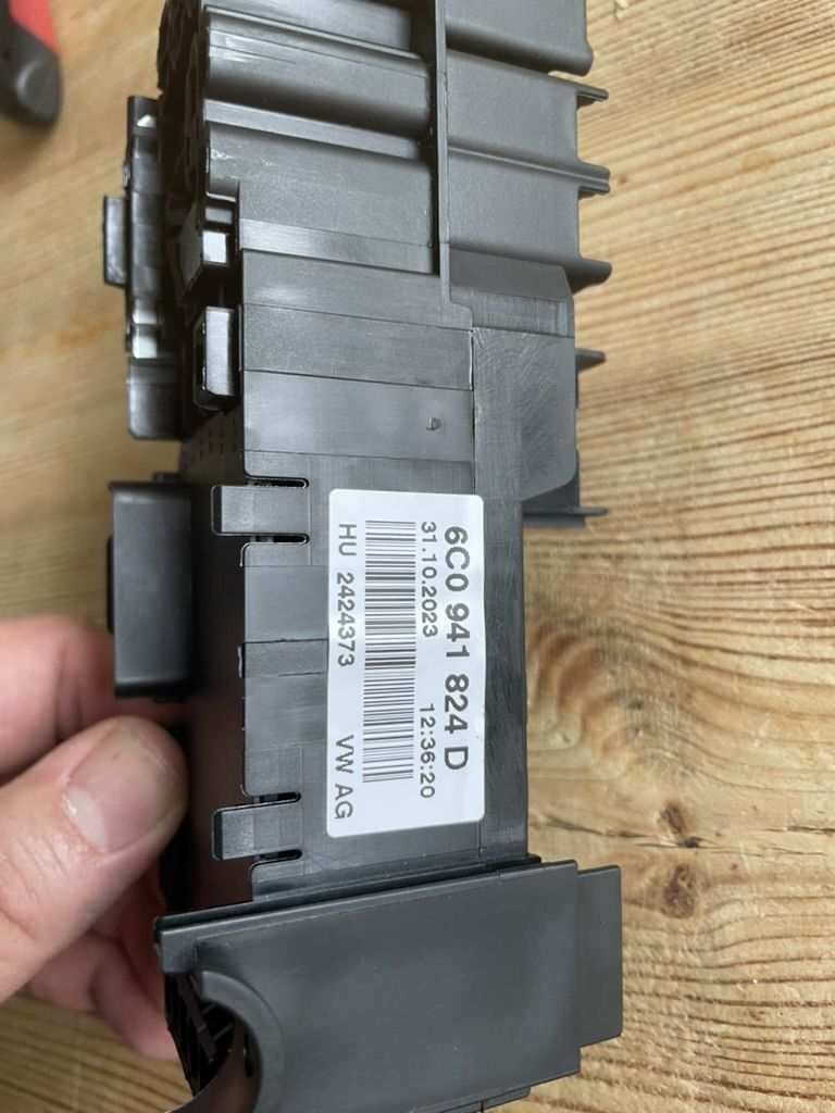

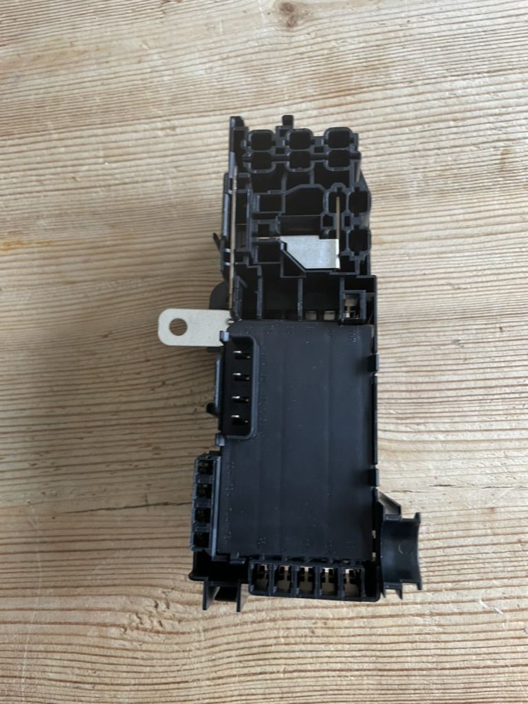

    Yes I had the same issue and I have just resolved it FINALLY with the help of everyone on here.
    Here are some pictures of what I replaced (I purchased a new fuse box from VAG for PLN70 and took out the whole relay board and fitted - It was VERY tight around wires but time and patience and it got back together and working finally!
    Attach some pics - let me know if I can offer any advice.
    A circuit board with mounted relays lying on a wooden surface. Fuse box unit lying on a wooden surface. Photo of a new fuse box from VAG on a wooden surface. Close-up of a relay board with new wires and a connector in a car. Close-up of a VAG fuse box with attached wires in a vehicle engine. New fuse box with part number 6C0 941 824 D held by a person.

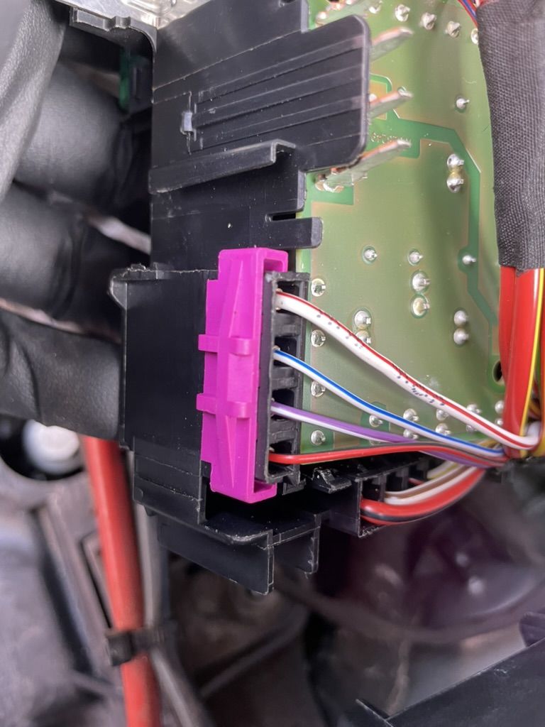

  • #27 21315544
    Larsa
    Tip
    You do not need to remove all cables from the fuse box you only need to remove the 6 cables at the top.
    And all large fuses. Cut up 2cm tape on the cable tangle. This will give you room to remove the card from the bottom.

    Yes 2019 DSG 1.0 SE - Yeah remove the tape around the cable and cable ties and "wiggle" it into place.
