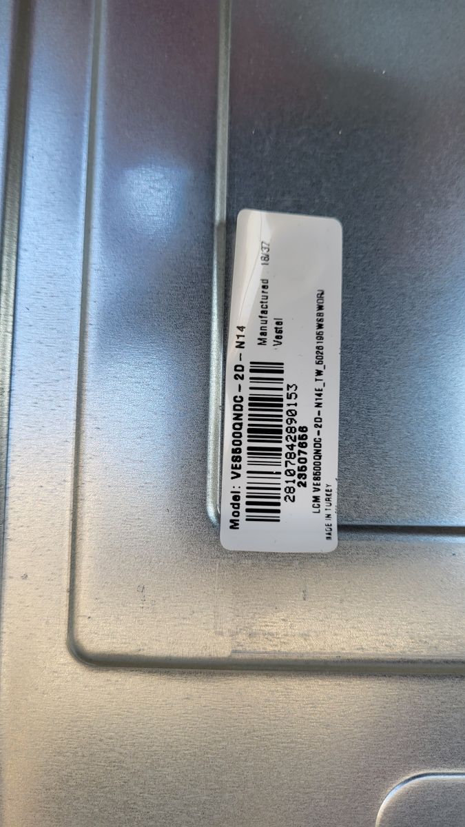

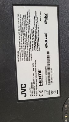

    post a photo of the sticker on the back of the tv
    model, product code and serial number required

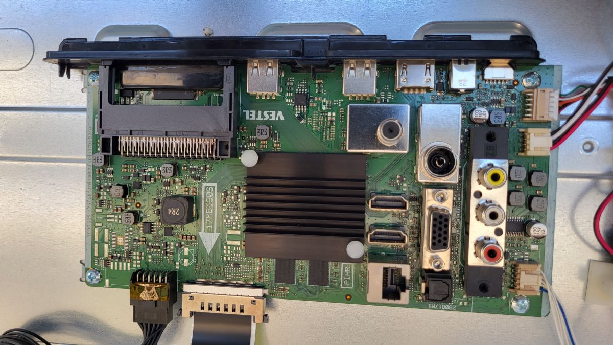

    Label on the back of a JVC television with technical information. TV motherboard with various ports and connectors. Label with information on a metal surface

    try, at your own risk, to update with the jvc mb130s core software
    copy the file upgrade_mb130.bin on an empty usb stick fat32 formatted
    insert the usb stick in the tv
    if usb media player menu appears, close it
    press MENU 1505
    then perform a factory reset from service menu
    • MB130S_QUI_JVC_APV_V.5.35.8.3.zip (164.85 MB) You must be logged in to download this attachment.

    Thanks a lot my friend, but I've already tried it and the Netflix app keeps showing UI-800-3 error.
    Thanks for your effort, I'll look for a new main now.
